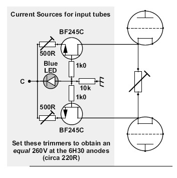

Hi Craig,
The circuit I sent you should be inserted between the -25V unregulated supply and the emitter resistors of the input stage (which are absent for the standard LOMC configuration, in which case the CCS is connected directly to the emitters).
You measure the voltage across each of the fixed 1K0 resistors in the CCS in turn and adjust the pots in series with these: when the voltage is 9.5 V across both of the resistors, the current through each should be 9.5 mA and the total through the tail of the input stage 19 mA.

Alex,
Since I'm not aware of the circuit you are referring to, could you please send me the relevant schematic? From what I have read so far, I assume that it must be a "differential" constant current sink like the one that Allen uses in his PP-2C - see attached image.
Does this circuit applies also with using 2SK170s (feeding the sources instead of emitters)? I'm asking because I have already wired the phono stage with the JFETs and I would like to try this first before going to BJTs (I was lucky enough to have purchased four MAT02s before they went out of production)
The schematic shows 2 single CCS'es, nothing differential about that...
It's becoming differential through the common cathode resistor. As Allen has explained, trimming that resistor, controls the Gm degenaration of the cascoded tube, hence adjusting the gain of the stage.
When I was writing "differential" ccs, the term was in quotes, trying to describe this twin ccs acting as common ccs in a differential stage.
It cannot be differential in the sense of a LTP - and that is not its designed function. Its function is to keep the triode in Constant Current operation to maximise linearity.
Allen never really employed proper hard differential operation. In the case of his PP amp he said that proper differential operation compromised bass extention. Again this is one of those areas where I fundamentally disagree with Allen as I firmly believe in the LTP principle of hard differential stages.
Shoog
Shoog
As far as I can see, in his preamplifiers (except RTP3D), Allen implemented true differential LTPs, with single CCS to both tubes, or both cascodes.
