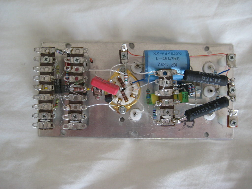

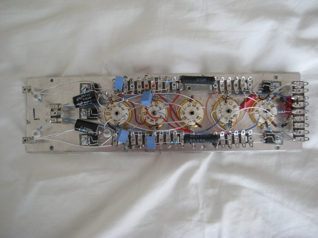

Here are the pictures of the chassis. All work is done by hand. The most difficult part of the (mechanical) work was marking, drilling and tapping tenths of holes.
I have yet to add a couple of XLR connectors...

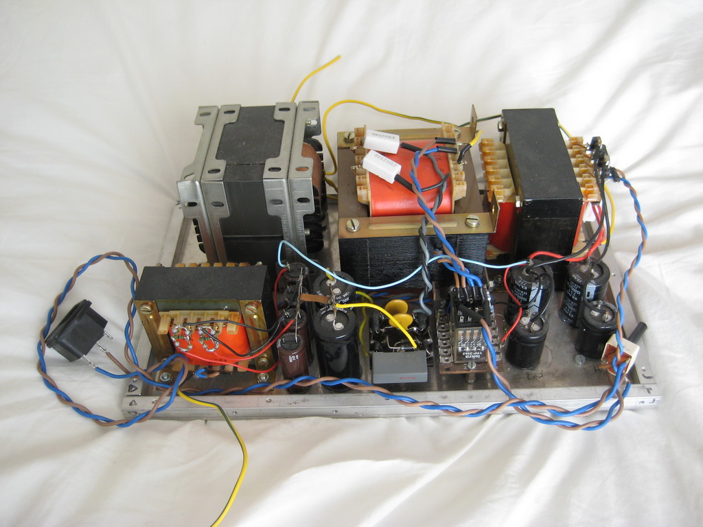

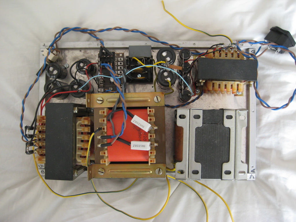

And here is the power supply. I have already tested it, but I have to change the connection of the choke. I remember Allen saying somewhere that, for a choke input filter and a higher than average voltage, it is much more safe for the choke to connect it to the ground, rather than the positive rail of the PS filter, since the AC ripple is very high and could possibly damage the choke's insulation (except for when the choke is specifically designed and constructed for a choke input filter, but I doubt that mine is).

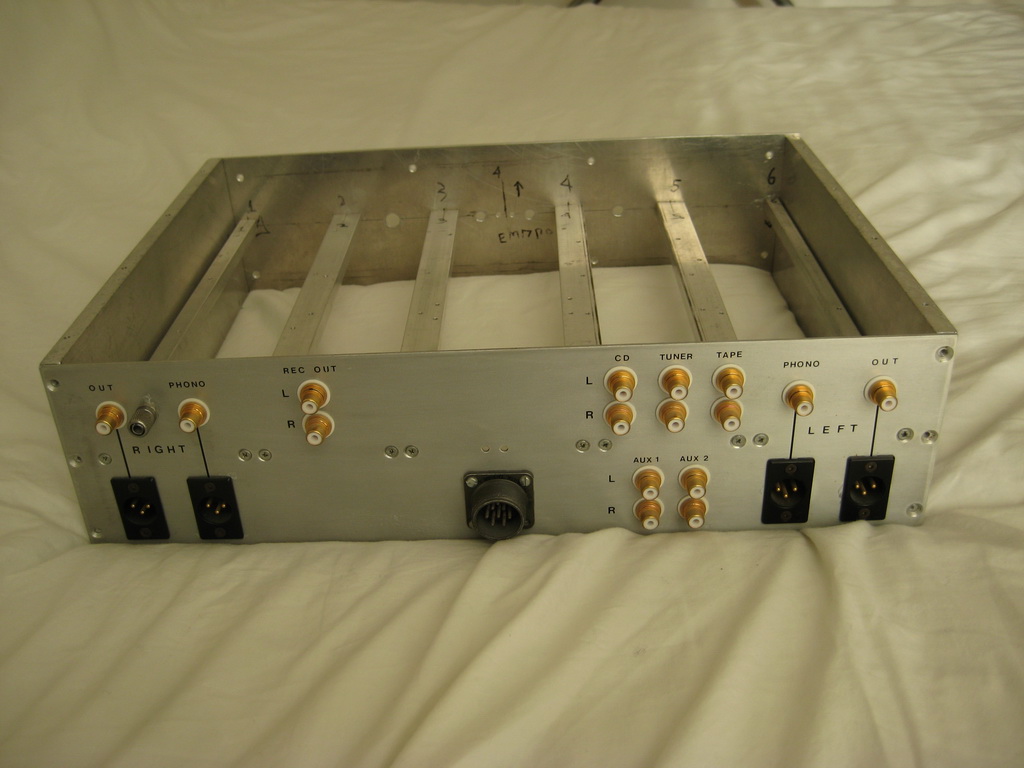

Hi Evangelos,
What connectors did you use for power input? They look very similar to the Amphenol C016 ones I used.
I notice that you have "Rec out" sockets on your back panel. Do you have any extra buffering for these outputs? I used OPA604 op-amps (I never told Allen 🙂 ) for this, since the phono EQ in particular is very sensitive to loading.
Finally, how did you print the text on the rear panel? It looks very professional.

Hi Evangelos,
The connector I have used is Amphenol MS3102A16S-1P. Like this:
Amphenol - MS3102A16S1P
I will use a very simple jfet (2sk170) source follower, that Allen has in the manual. But rather with an active current sink (another 2SK170).
Whether you believe it or not, this is the all times classic Lettraset with a coat of clear varnish to prevent chipping.
I think it is similar to what I used, although I went for a completely dual mono PSU, and therefore dual power connectors.
It does look good! You have inspired me to try Letraset on mine.
