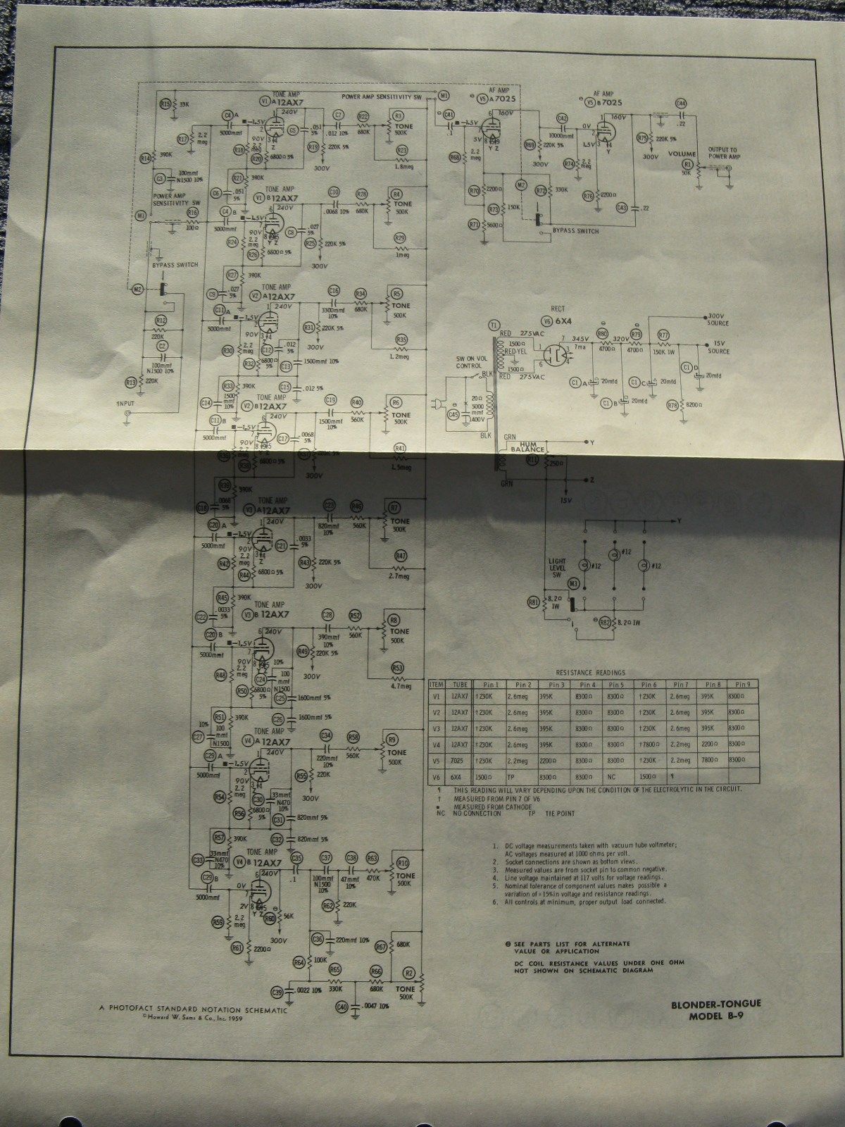

I realize now there seems to be different versions of this schematic. The question is which one is the most up-to-date. that would explain why your values are different than the ones I have.
I followed a good print which is the entire service manual. All values are easily readable. How can I send to you the schematic I have for comparison?
oh I see in fact I cannot see the value you mention in my schematic both the BBC and the Baton, you can attach your schematic here....thank you very much

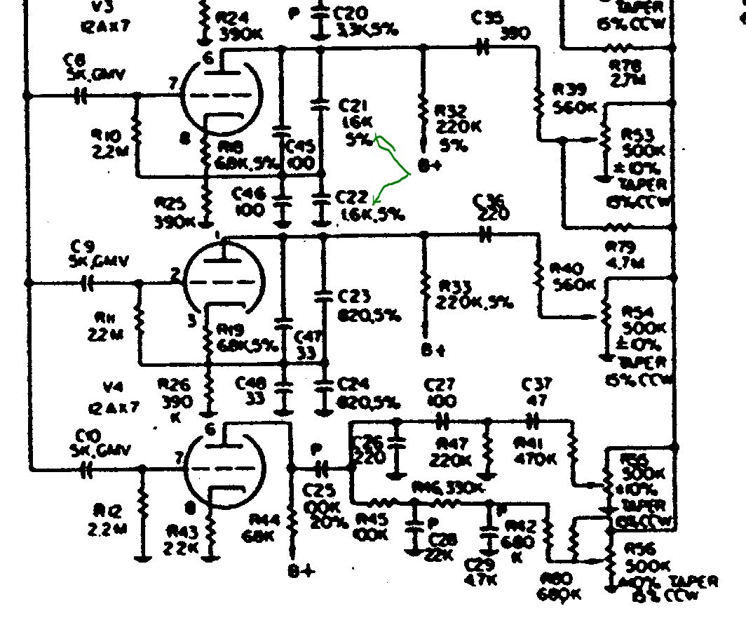

Just checked the BBC schematic and it's definitely a typo in there and most likely the source of your problem.
C20 for 1280hz is 0.0033. C21 for 2560hz is roughly half of C20 which should be 0.0017 not 0.0161. Continuing the same formula for 5120hz C22 is half of C21 which is 853p.
If you used 0.0161 instead of 0.0017 it would probably give you the dip you're seeing at 2560hz. Don't forget that there is 2 of them C21 and C14.

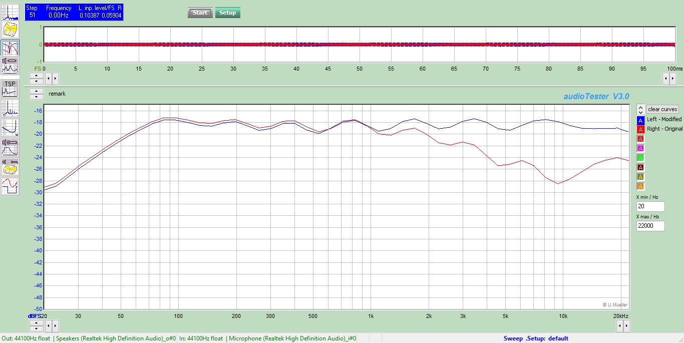

I played around with my build and modified some of the resistor values. I'm not an EE and I don't really know if these mods have any adverse effect. I only went by the better frequency response these mods created. Maybe you'd know if these mods should not be done.
The changes made based on the schematic I've send you with your schematic in brackets. The FR curves after these mods are attached with all settings at 0db.
R38(R44) - from 680K(560K) to 470K
R39(R45) - from 680K(560K) to 290K
R40(R46) - from 680K(560K) to 100K
R41(R48) - from 470K to 200K

I received the schematic by email, wow so many differences on component value I cannot believe that I became mad on try to fix the dip but I could never ever imagine was a mistake on the schematic print just a dot on the wrong place.....I changed the two cap from 16.1nF to 1.7nF and boom problem solved, you really are the one solve the problem thank you so much, I think the schematic you have is a review from the original, I saw as you point out so many other differences from the previous but I am not bother to change all component that are not so influential.
Also you get a very good result now, the resistors you change value are ok, they are just attenuating the signal before going to the pot so if you get that result just keep it as it is....all the best
