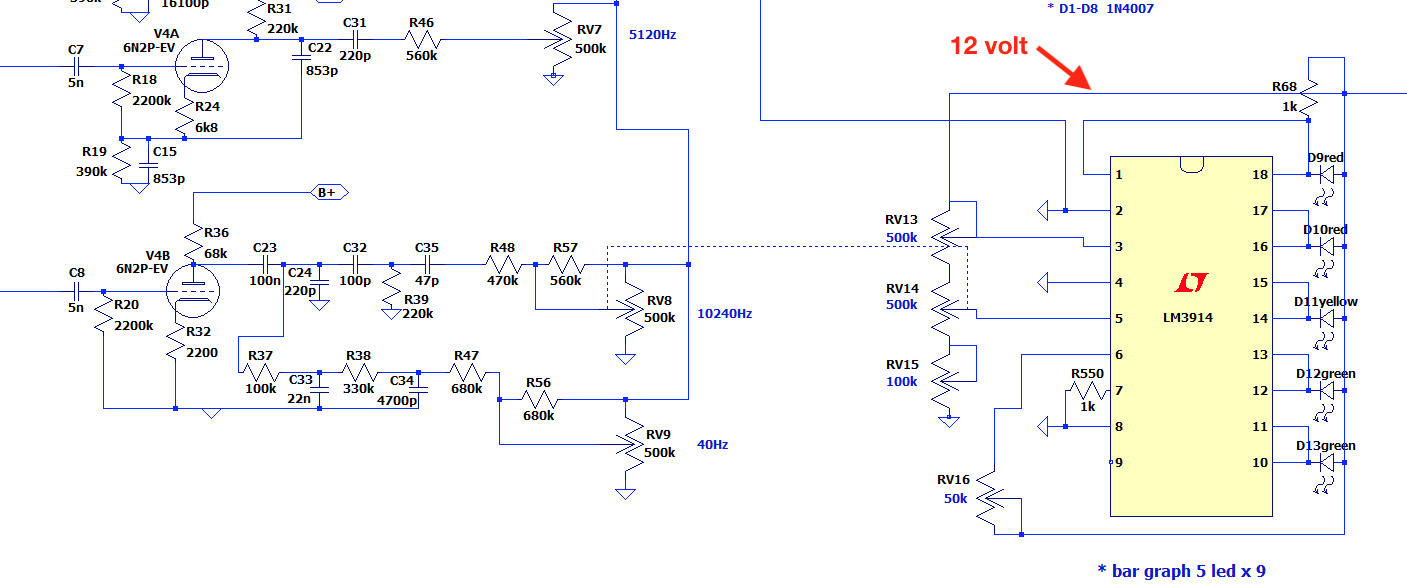

All you've posted is very interesting. Very nice build projects. I wonder how did you make the led bar circuit (what IC is used) and how did you connect those led bar circuits to the tube circuits? Hope you will share your solution/ schematic. It looks very very nice. Thanks in advance for reply, best regards Eric21The Blonder-Tongue Audio Baton is my next project, it will takes maybe one year to finish it, still working out how to add a modern trick to it...all the best to everybody
Hi Eric21, no problem here the schematic, how you can see the led bar is not connected to the tube circuit but using a dual gang 500k potentiometer (RV8/RV14) allowed to synchronise the two circuit then RV13,15 and 16 for get the exactly center of the bar graph ( yellow led ) corresponding with the center of the 500k potentiometer, I hope is clear if you have more question I am always available.......all the best
Hi kissabout2002, thanks a lot for information. Ok, your solution is nice. I wonder how to do it with a mono potmeter. All the best Eric21
Hi Eric21, you can use a mono potentiometer respecting the original schematic without bar graph, I do not see any possibility to use a mono pot for the EQ and the bar graph as well.

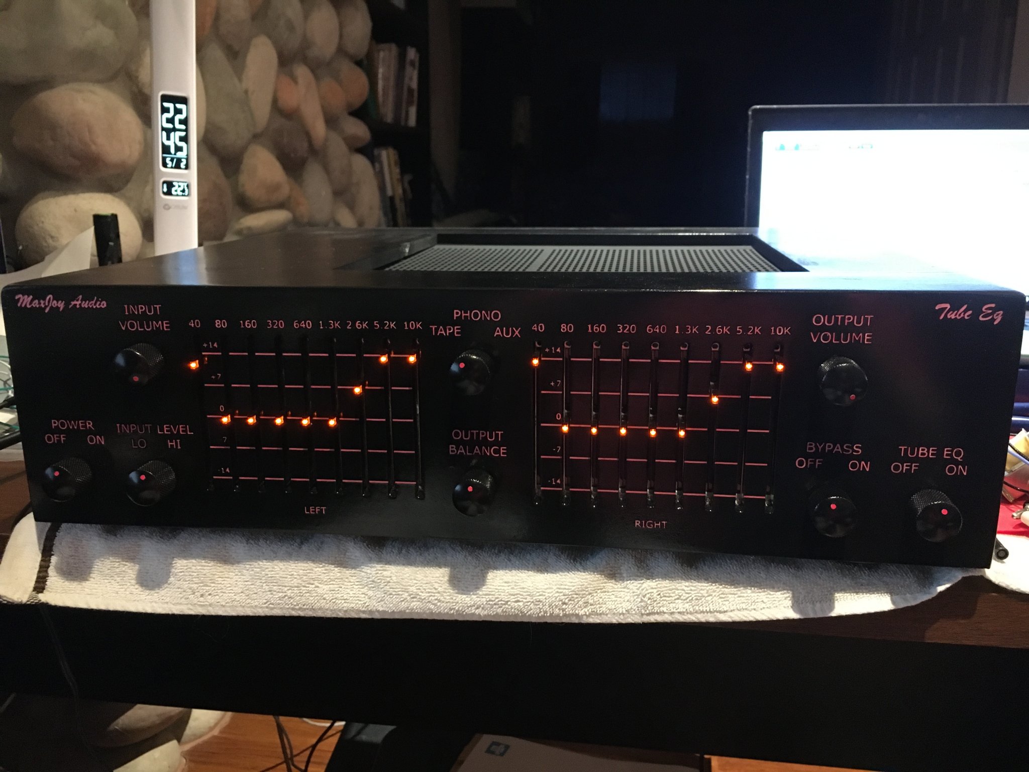

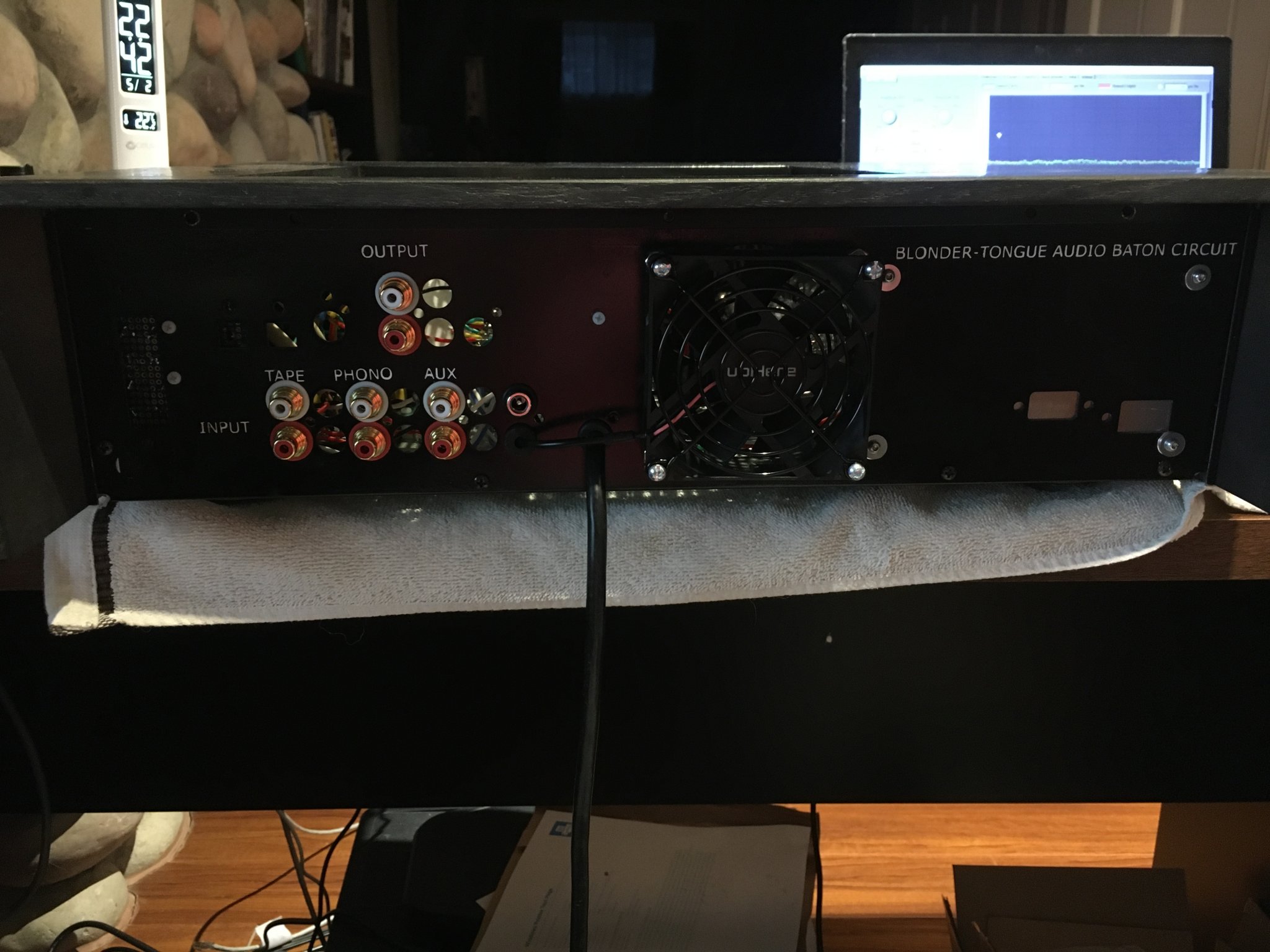

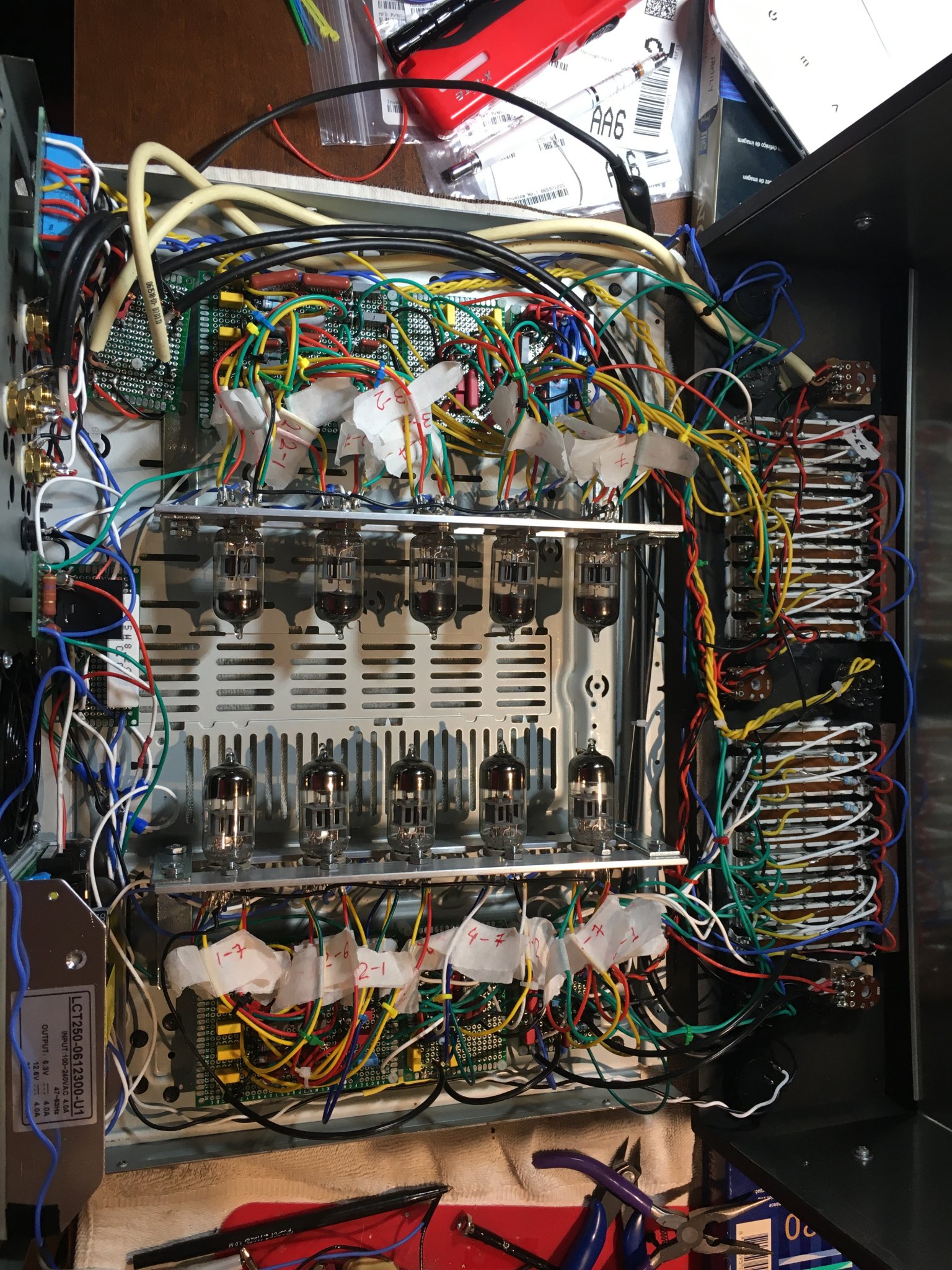

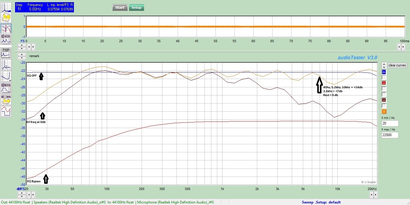

Hi Guys,
It has been 4 months since my last post. The Tube eq was completed in about a month but had to wait for the tubes to come in which took 3 months.
In my build, I have used the Blonder circuit and followed it value for value except that I've added an Input volume, Output balance and volume, Tube EQ on/off. I find that bypassing function still goes through the tubes and it affects the FR...see below FR graphs. Also I've used 6N2P's instead of 12AX7's and adjusted B+ to be 250v as Kissabout2002.

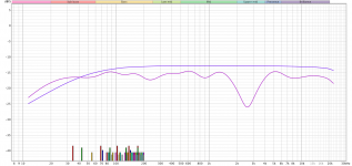

Everything is great except for some ground noise which I have to solve and the frequency response going through this circuit, namely the 40hz and 10Khz (half of tube) and 5.2Khz the other half of the triode tube. You can see in the graph that it dips at these frequencies. I first thought that it might be the tube so I rolled them with no effect. Then I checked the circuit work and there are no mistakes, especially both channels exhibit the same dip.
Kissabout2002 and others that build this, do you experience the same response on your build? Did I do something wrong or is there some flaw with the design? Does the response look right to you?
When I adjust the pots for the dipped freq it looks better but it's still waive....not sure if that matters. I labeled each FR curve.
Any response will be appreciated.

Congrats Dromichet, looks fantastic, wow I like your approach using slide pot, less space and no need to get mad as myself with a led graph, brilliant idea. Regarding the frequency response I attach response of my EQ ( EQ bypassed violet line - EQ pot 0dB purple line ) and as you can see my problem from day 1 is at 2.8KHz, this dips of around -11dB, me too I check and recheck but all correspond to the original design so I thought was a flaw of the original schematic but now that I see the response of your EQ I really do not know what to say, I start thinking that this circuit could be influenced by the layout of the component? The wiring? I really do not know but I will make different attempt as soon as I have time for understand the problem and of course I will share the result. I also suggest to rewire your EQ using more shielded cables especially on the signal path. All the best
Kissabout2002, thanks for the quick reply and sharing your experience. I agree, I should have used more shielded cable and that’s what i plan to do as my next step. My hum is 120hz and i’m assuming it comes from these unshielded cables. If I would do it again I would use a different design approach.
Regarding your graph, it is indeed weird. I studied your circuit and did notice that at times throughout your circuit you’re using different component values as the ones in the original schematic. I wasn’t sure if it was by design or if it was a mistake. That would have been my next question to you. I’ll check and point these discrepancies to you, maybe it’s related to the dip you’re experiencing.
My problem itks in the 4th tube circuit which drags the entire fr down. If I remove that tube the rest of the freq align with each other.
I’ll continue to poke around as seeing your FR gives me hope that I’ve made a mistake along the way.

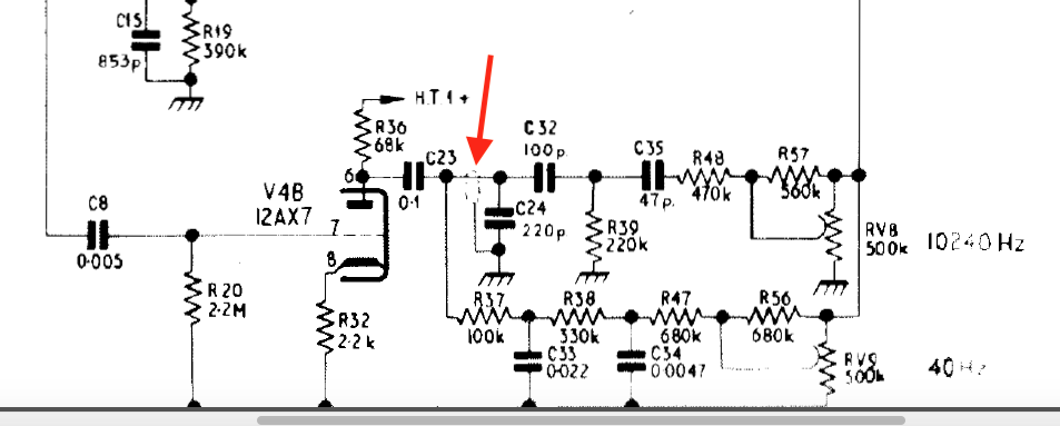

Dromichet, can you kindly, when you have time, point out what are the component you found I changed the value from the original schematic?
For your problem of the 4th tube, did you notice the shielded wire to be used? Interesting in the original Baton was not show but in the BBC AM1/11 yes as you can see, maybe doesn't do anything but at least worth try......all the best
Kissabout2002, just looking at your schematic, I see several discrepancies with the original schematic in the 2.5khz circuit. That might be the reason of your dip.
Your schematic Original
C14 = 16.1n C22 = 1.8n
C21 = 16.1n C21 = 1.6n
R45 = 560k R39 = 680k
R54 = 4.7M R79 = 2.7M
I'm not sure which schematic you followed, yours or the original, but these discrepancies might be the reason of you dip. There are other discrepancies as well.
