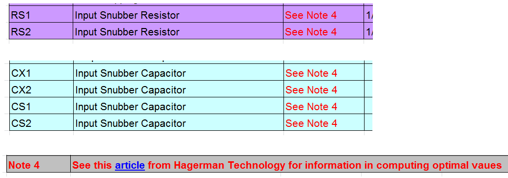

I’m also looking for a suggestion on the input snubber values. I don’t have access to a scope. I understand the input snubber values depend on the used transformer and will be hard to recommend without measurements.
I’m using an Amplimo (toroidal transformer) 500VA Pri:230V sec 2x18v, for a F5 build. Would it be possible to suggest a ball park figure for RS1&RS2, CX1&2, CS1&2, or is this not recommended?
I believe the suggested values [of RS1&RS2, CX1&2, CS1&2] are on the BOM.
Not really. The BOM attached to post #1 says this:

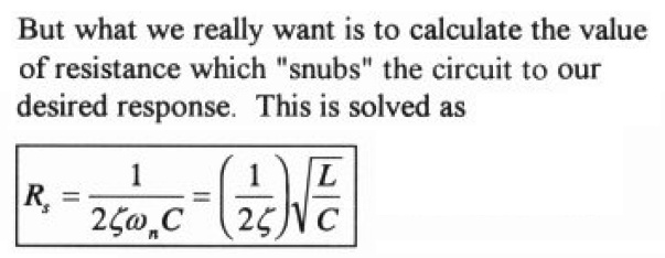

Hagerman's article (LINK) is many pages long but the central result is a single equation, found on page 4:
The squiggle next to the numeral "2" is the lowercase Greek letter "zeta", which is the damping factor of the resonant circuit. "L" is the secondary leakage inductance of the power transformer, measured with primary shorted. "C" is the sum total of transformer secondary capacitance, plus rectifier capacitance, plus across-the-secondary capacitor Cx (if fitted).
Hagerman suggests measurement procedures to find L and Ctransformer and Crectifier; naturally they involve measurement equipment. "Quasimodo" on the diyAudio website suggests design-and-measurement procedures; naturally the measurement procedures involve equipment, specifically an oscilloscope.
When measurement is impossible or untrustworthy, it may be tempting to use a guess or a "ballpark figure" instead. In a CRC snubber such as the one laid out on this PCB, the designer can choose Cx to be much much greater than Ctransformer + Crectifier. Then all but one of the variables in Hagerman's equation are known: (zeta = 1.00 (gives "critical damping")) and C = Cx. If you have a guess or an estimate of secondary leakage inductance L, you can calculate an appropriate snubber resistance Rs.
How do you guess the value of your secondary leakage inductance L without making any measurements? I don't know. (That's why I use a Quasimodo; I prefer to measure rather than to guess. But I own an oscilloscope.) I suppose you could ask somebody else to make the guess for you; then if your design fails, it's their fault not yours. I suppose you could collect measured secondary leakage inductance numbers from other people, and use some kind of data manipulation technique to combine them into an "informed guess."
