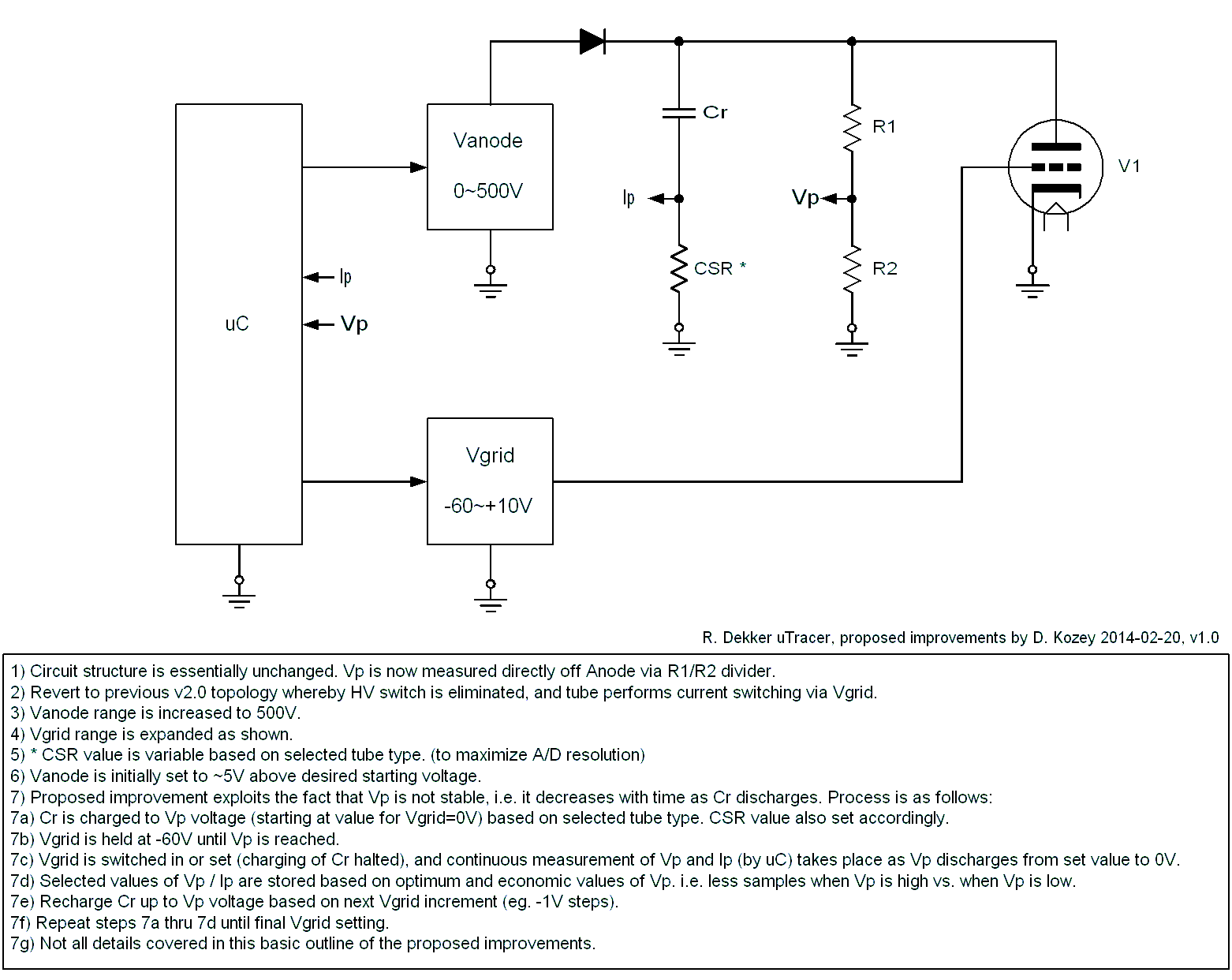

After giving the issues some thought, I've come up with a wonderful solution that is simple, cheap, reliable, and accurate. Once I draw up a basic diagram I'll post the idea. All that be required is a couple changes to the v3 design, and the firmware. No transformer and no HV switch required.

i had suggested the HV amplifier from Horowitz and Hill -- just 2 HV MOSFETs -- can be driven with a DAC or ramp generator -- and it doesn't burn a lot of energy, and it compensates rather easily. No sparks either.
OK, here are my suggestions for improvements to the uTracer design, in a basic form.
But first, R. Dekker deserves a lot of credit for his design. Obviously he has spent a great deal of time and effort in developing the uTracer.
See the attached diagram and basic description.

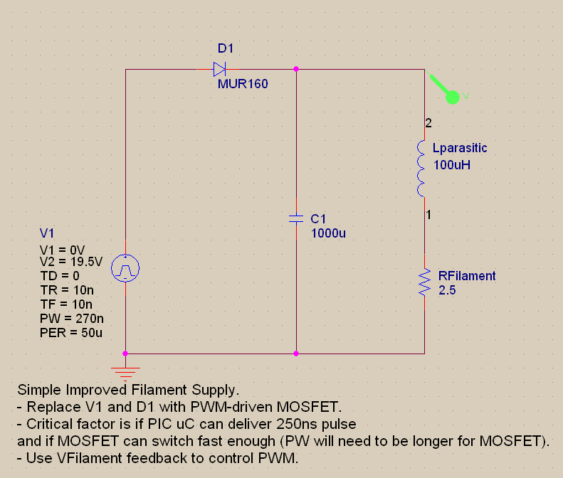

The problem with the heater supply is largely due to inductance - the software assumes its a square wave and calculates the power & effective DC voltage from the mark/space ratio and supply voltage (about 19V, which is accurately measured at run time).
In practice, the heater waveform is nothing like a square wave due to circuitry & wiring inductances, and this leads to the heater issues - Ronald is well aware of this and its one of the things that will be fixed in V4.

IMO, a far better approach for the filament supply would be to filter the pulsed output.
The benefits include the following:
1) Parasitic inductance from wiring etc. becomes a non-issue.
2) The filtered output can easily be measured by the PIC uC in order that the PWM be set to achieve the specified filament voltage.
3) The modification is simple.
4) The current flowing in the filament will be smoother and less likely to cause adverse effects in the measurements.

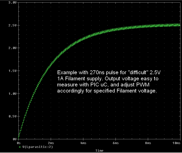

The only caveat to achieve such low filament voltages such as for a 2.5V/1A filament, the PIC uC must be able to output a 270ns pulse (probably longer considering the MOSFET will require some turn-on time).
See attached schematic and simulation results.

The above idea is good if there is an easy way to implement the switch (there isn't one I can see).
However as Ron has suggested in his blog, I concur that a good approach would be to utilize a proper buck converter circuit. But I would suggest that the output be measured and PW controlled to achieve the specified filament voltage.
Why not include a low cost RMS to DC converter like the one below, then measure the DC level through one of the unused ADC inputs of the PIC. The loop control on the heater supply does not need to be a state of the art one.
