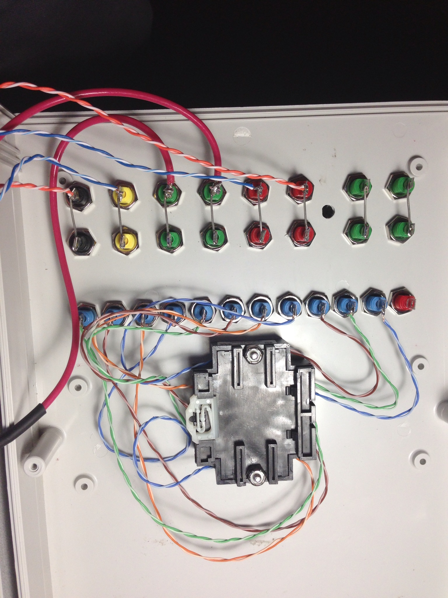

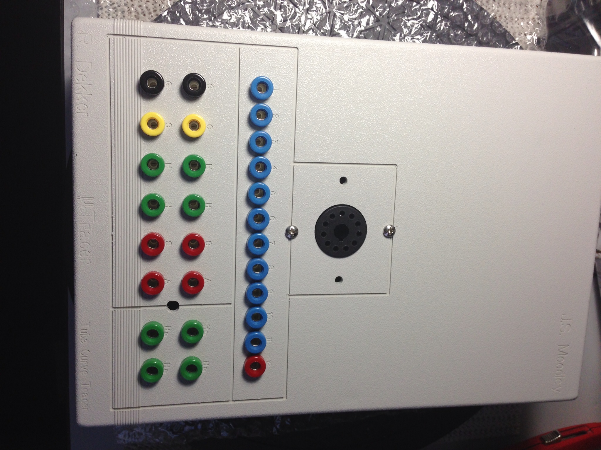

Mine supports tubes on the UX-4, UY-5, loctal, octal as well as 7 and 9 pin miniatures.. I have not elected to support more obscure types and will just make temporary use jigs when such occasions arise.
I have designed and am building an outboard 2 - 3A DC filament supply for 1.5V, 2.5V, 3V, 4V and 5V DHTs to go with mine. For most other types operating on 6.3V or above I will use the internal filament supply.. The outboard filament supply should give me a little more flexibility in terms of measurements relative to the + or - side of the filament supply, and will remove any questions about variations in operating points due to filament voltage considerations.
Personaly, I have not selected all support to place on only one box/board, but one socket/one board. One is for noval, one for octal, etc...
Each "support box" owns 2mm miniature safe bananas supporting high voltage.
Like this, I can evoluate by creating a new box for each strange, unknown, forgotten valve support when needed without necessitiy to redo a complex wiring head lock, with lot of parasit capacitors, oscillation risks, but only very very shorts standard 2mm safe bananas 🙂
Simple is often the best !
That's the approach taken by Tektronix on their curve tracers. And HP on their 4194A impedance/gain-phase analyzer. That's a tried and true way of doing it.
The problem I've had with "universal" testers is that they never support the footprint of the part you want to test.
~Tom
Best Regards,
Francois/France

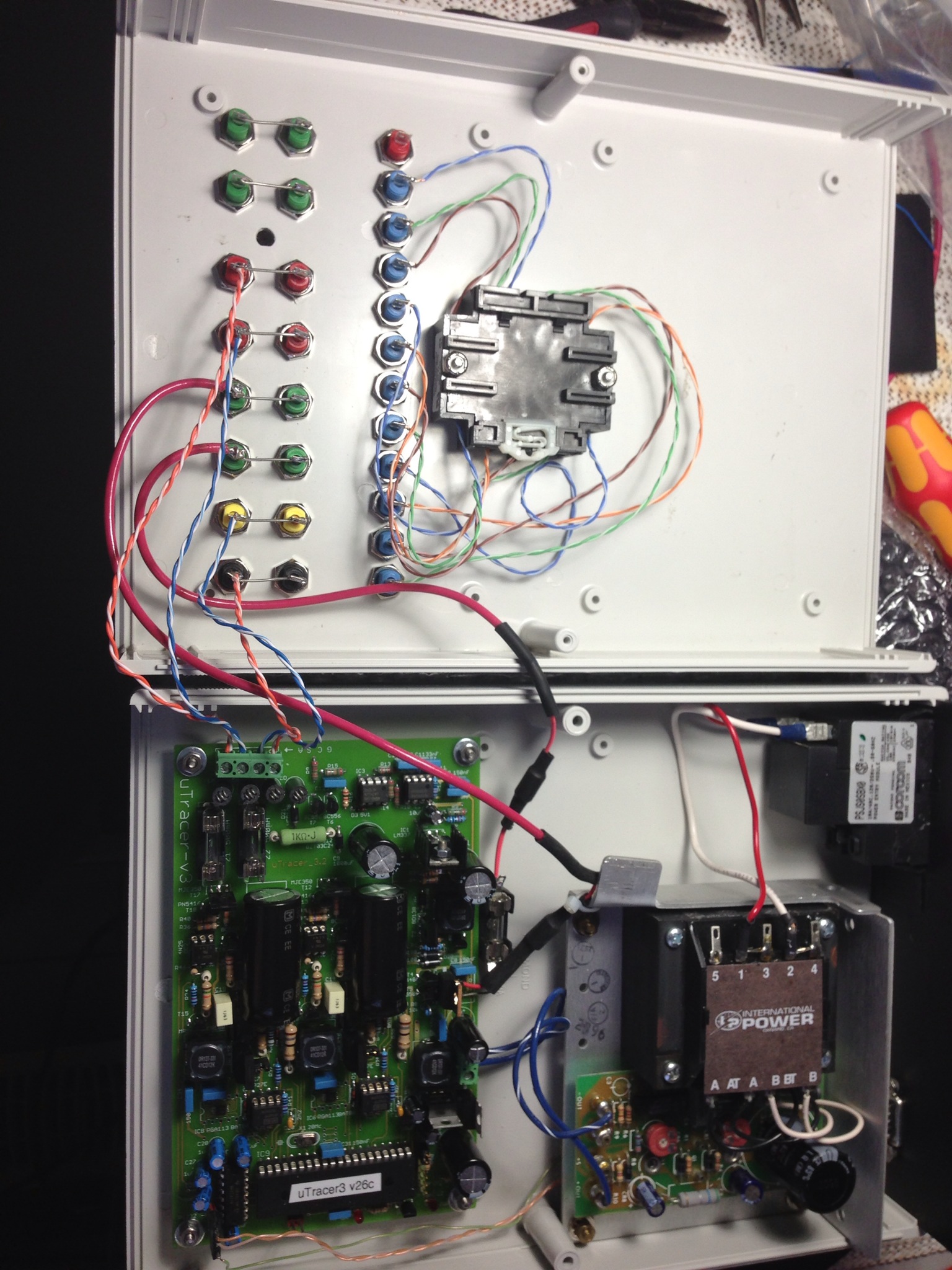

Finally got mine all wired up and calibrated today -- i would suggest using some through-hole inductors, or reflowing the L1,2,3,4. If not, I suggest mounting the inductors first. Will have some pix on how to arrange this.
