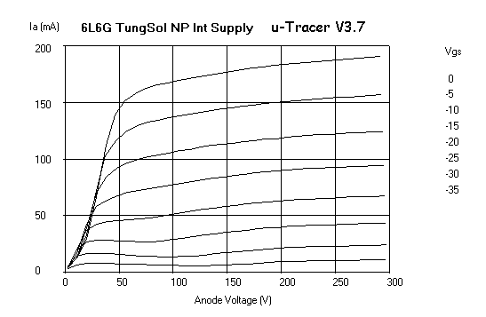

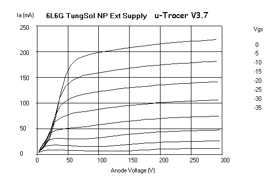

I did that test with a new production 6L6G TungSol, using both the internal heater supply and an external one.
In both cases the the same tube was used and the measurements were taken after 10 minutes of heating time to ensure emissivity was stable.
You can clearly see from the charts that although the "shape" of the traces remains similar, there is a "scaling" factor. In other words, less emission, less anode current.

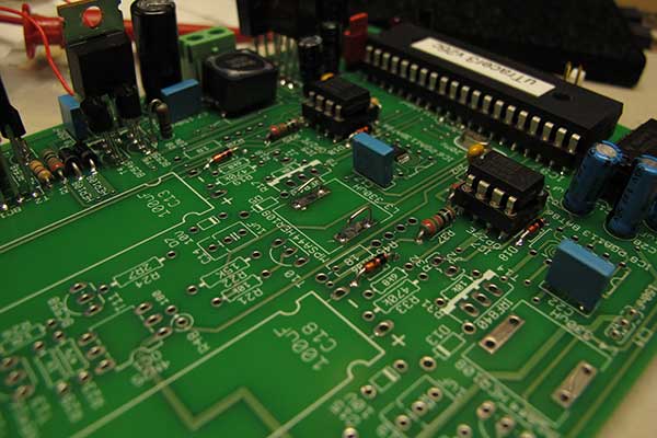

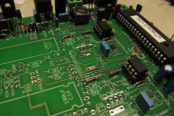

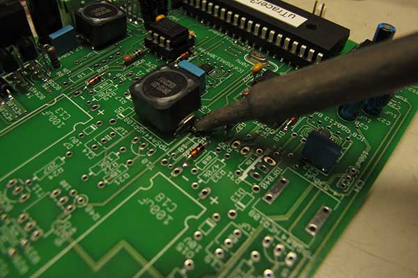

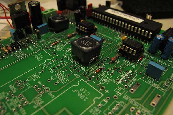

I really fail to see why the inductors are a problem - simply wipe a tiny amount of flux (from a flux pen) on the pads. Whilst holding an inductor in place, using 22SWG solder, sweat/capillary feed a small amount of solder under one pad. After ensuring your inductor is nice and square, repeat for the other pad. Takes about a minute to do one inductor. No messing with bits of looped wire or whatever. No heat damage to the pads, inductor, or anything else. If you want to make it even easier, just tin one pad, hold the inductor in place with a fingertip and re-flow the pad so the inductor drops into place. Let the pad set, then do the other one at your leisure (using the capillary method above).
Using thin solder and a decent iron its trivial to get right.

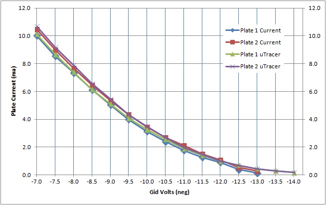

Well I don't think the design of uTracer v.4 has been finalized, but the concerns you have with the flyback effect no doubt has crossed the good doctor's mind, besides I am pretty sure this (among many others) is an engineering and programming challenge that he would like to tackle... if it was easy, then anyone can do it, where is the fun in that?😀
I have looked at both the swept results and static, the uTracer v3.0 mA/Gm results are almost the same as calibrated tubes tested using multiple supplies, oscillator and high resolution meters. An example of a 6SN7 at 250V swept from -14 to -7V on the grid is provided, the resolution being quite fine where one can resolve small differences in almost identical plate curves. Other tubes such as 6L6 tested on an Amplitrex and AVO testers give results within 1% of the uTracer V3.0. The only caveat, is these results are obtained with an external power supply for the heater. The internal heater yields between 3-8% lower results, the higher the heater current, usually the lower the value. There are some small plate/screen volt deviations from there set point resulting from the scheme used, but these are very small and can be compensated for.
The blog on the uTracer v4.0 is interesting and discusses some of your points. As mentioned, I think it is more the challenge of the design and to see if some of the hurdles of using a step-up transformer can be compensated for.

The reason the uTracer results don't match a bogey tube curve is because such a tube does not exist. The curve is the average of many, perhaps even hundreds or thousands of tubes. Testing multiple tubes on the uTracer shows this very clearly - and the results are quite repeatable over time and instance.

I have found it to match static measurements quite well when the heater voltage issue is properly addressed.

I found that on some tubes the curves I derived on the u-Tracer and the fitted out Tektronix 576 were quite comparable to the datasheets -- compared to the Tektronix 576, however the u-Tracer is quite current limited.
