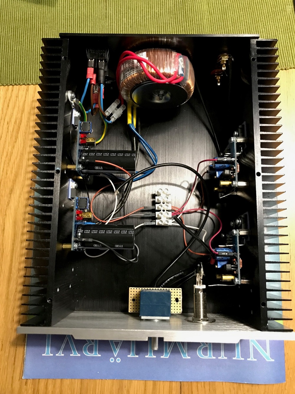

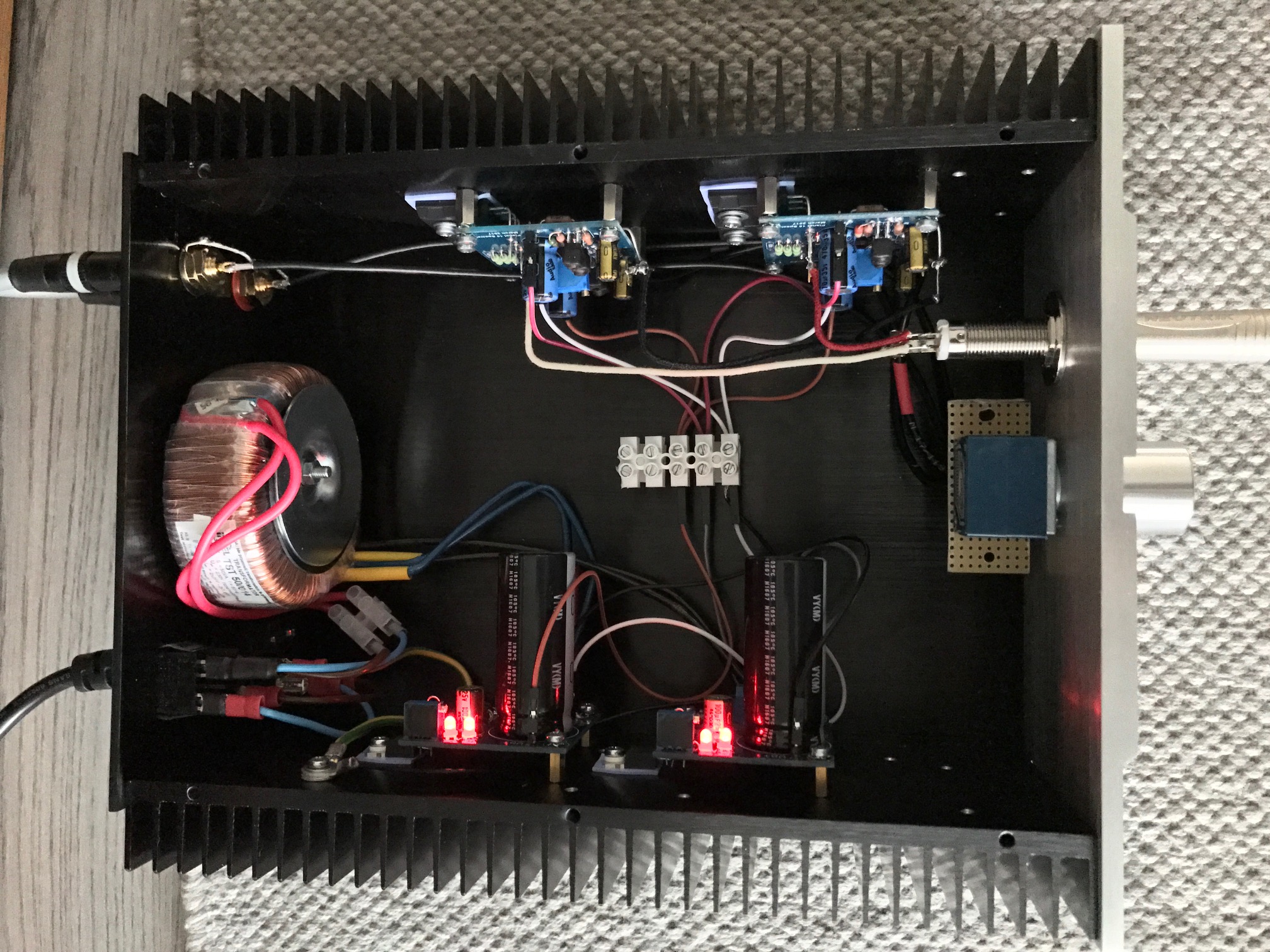

I decided to use my LM1086 regulators, since my trafo could not handle any extra consumption. The trafo is a 50 VA 2x24 V toroid and it's running quite warm with the 32 W load (~10 W losses and ~22 W for UTHAiM boards). Although I did drill the holes ready for my Nazar regs if I decide to upgrade the trafo as well. Would be interesting to test whether I could hear the difference between PSUs.
The front plate still needs some sanding because the logo is a real PITA to remove.

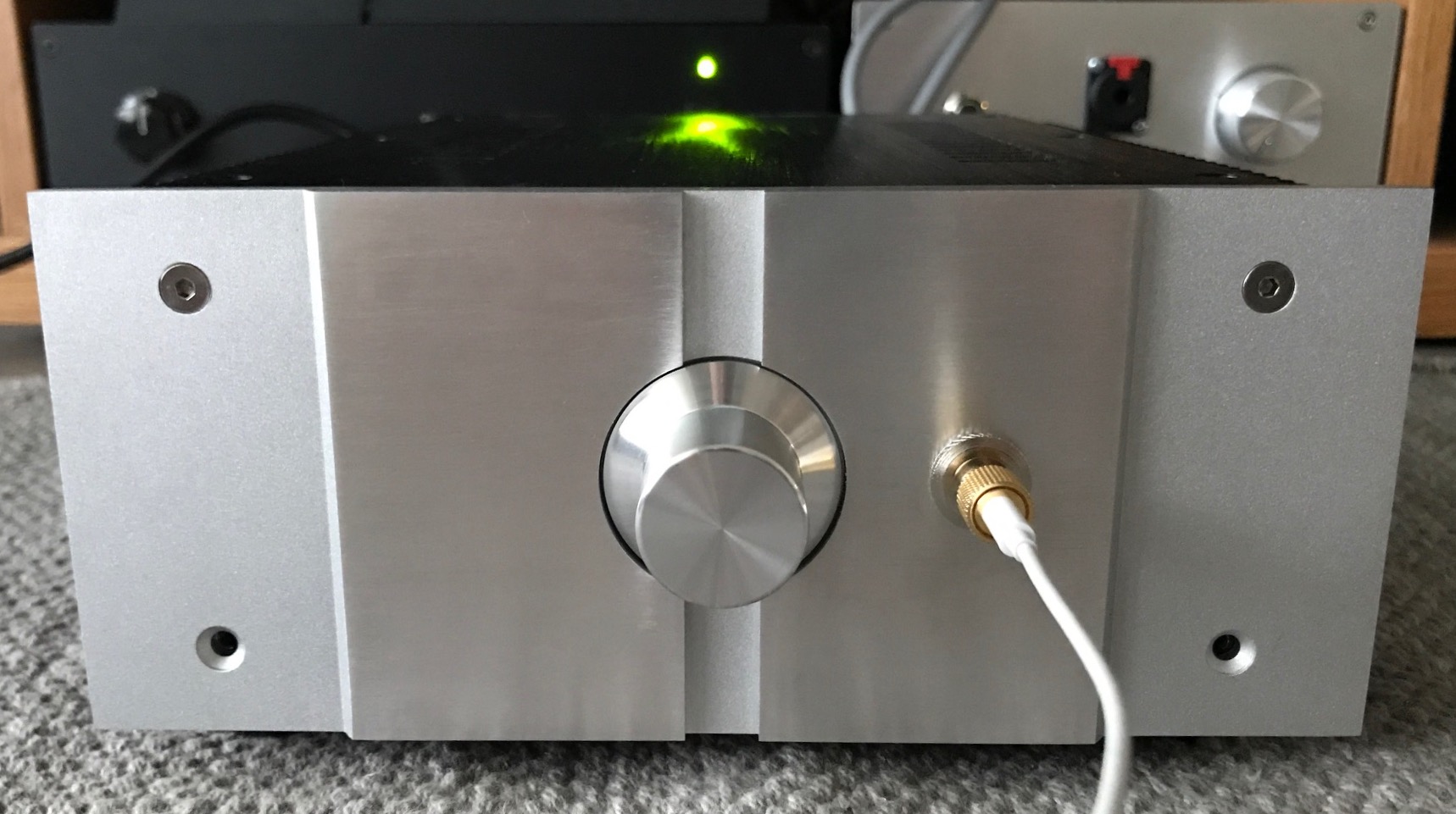

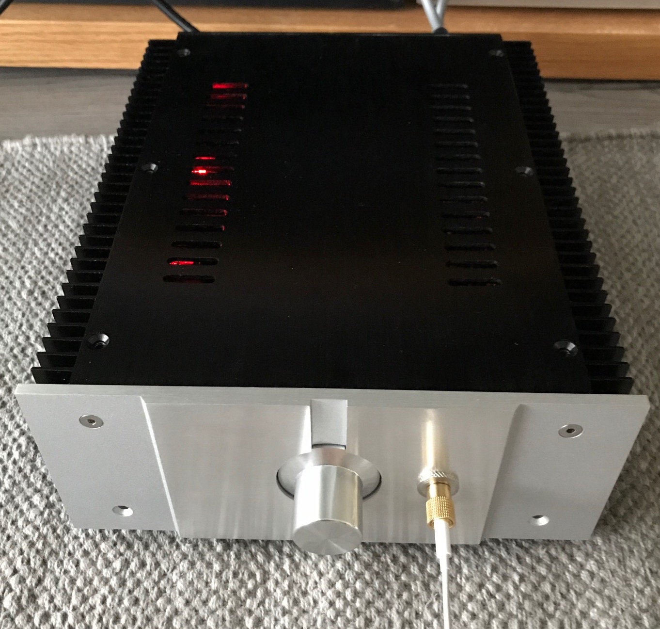

It's done - finally. I think I might add an Onpow power switch with led ring to the front page but It'll have to wait for now. I'll need to enjoy the sound of this technical marvel first. 😀
The amp is hum free, but there's a pink noise type of faint sound when using iPad stock phones, which are low Z and very sensitive. I believe this is the hissing sound that I have heard people talking about with solid state devices. The hiss cannot be heard when I plug in in my LCD-2 phones, which are also very sensitive, so it's not a real problem for me.
The sound seems to be very promising, but unfortunately I haven't had the time for critical listening yet. Oh, and the gain seems to be quite plenty. I'd say ten o'clock on the vol knob is all I ever need. Hopefully I'll find some time to listen more next week.

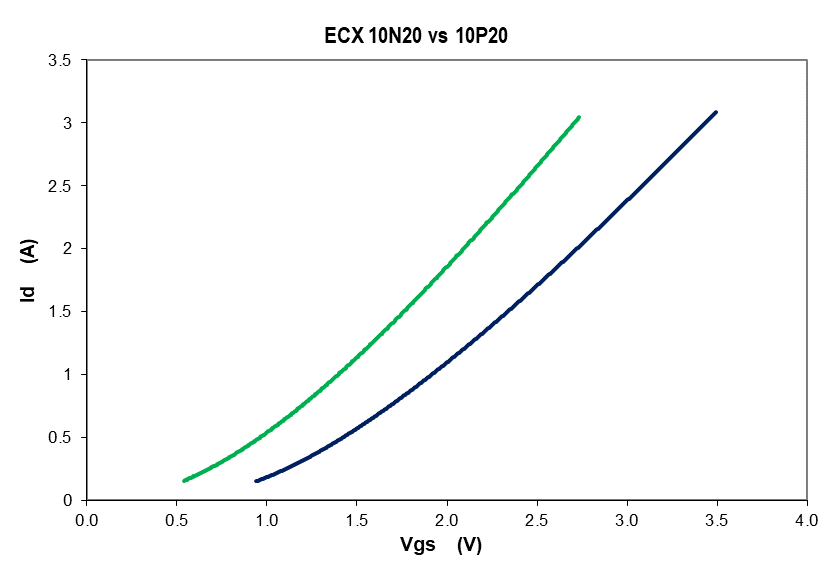

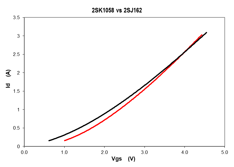

Thanks to help from Morde, I curve traced the Renesas 2SK1058/2SJ162, as well as the Exicon ECX10N20 & ECX10P20.
According to datasheets, they should be almost direct replacements.
But apart from Vgs differences, which can vary between FETs, there are also visible differences in Yfs.
Here are some typical results at 500mA bias :
2SK1058 Vgs 1.685 Yfs0.626
2SJ162 Vgs -1.379 Yfs 0.548
ECX10N20 Vgs 0.964 Yfs 0.999
ECX10P20 Vgs -1.423 Yfs 0.885
For the curves,
red is 2SK1058
black is 2SJ162
green is ECX10N20
blue is ECX10P20
Patrick
