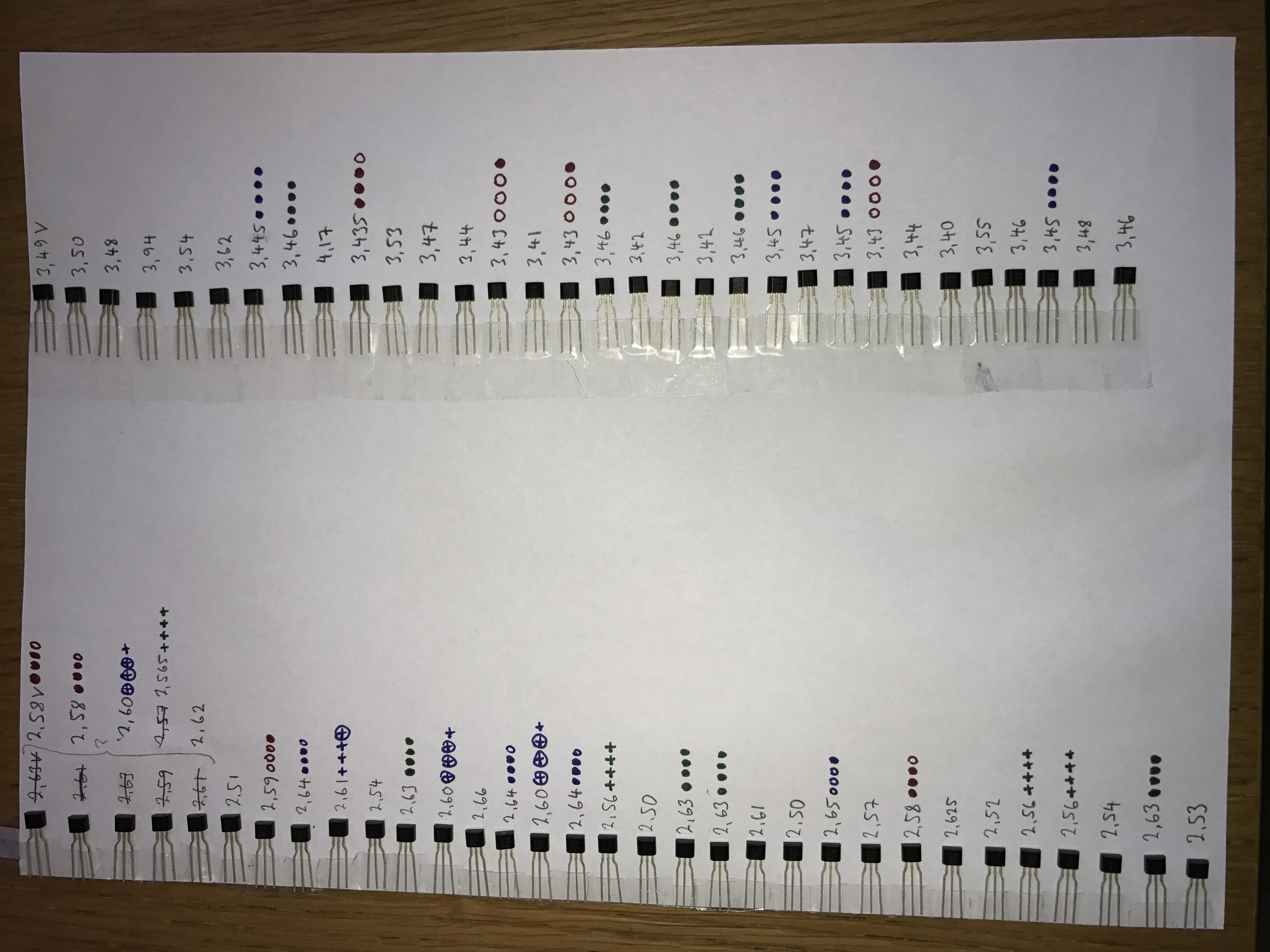

Phew! Now I'm done with the ZVN matching. It took couple of hours, but I think I managed to find quite good quads from the 32 pieces of both P/N channel mosfets. 😛
In the attached picture ZVNs are on the left and ZVPs on the right.
Do you want to do mine as well?🙂
You can improve your match even further by measuring also at 6mA (and 10mA),
and then pair them afterwards at both currents.
Patrick
Patrick
