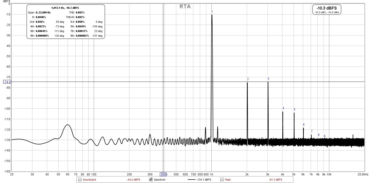

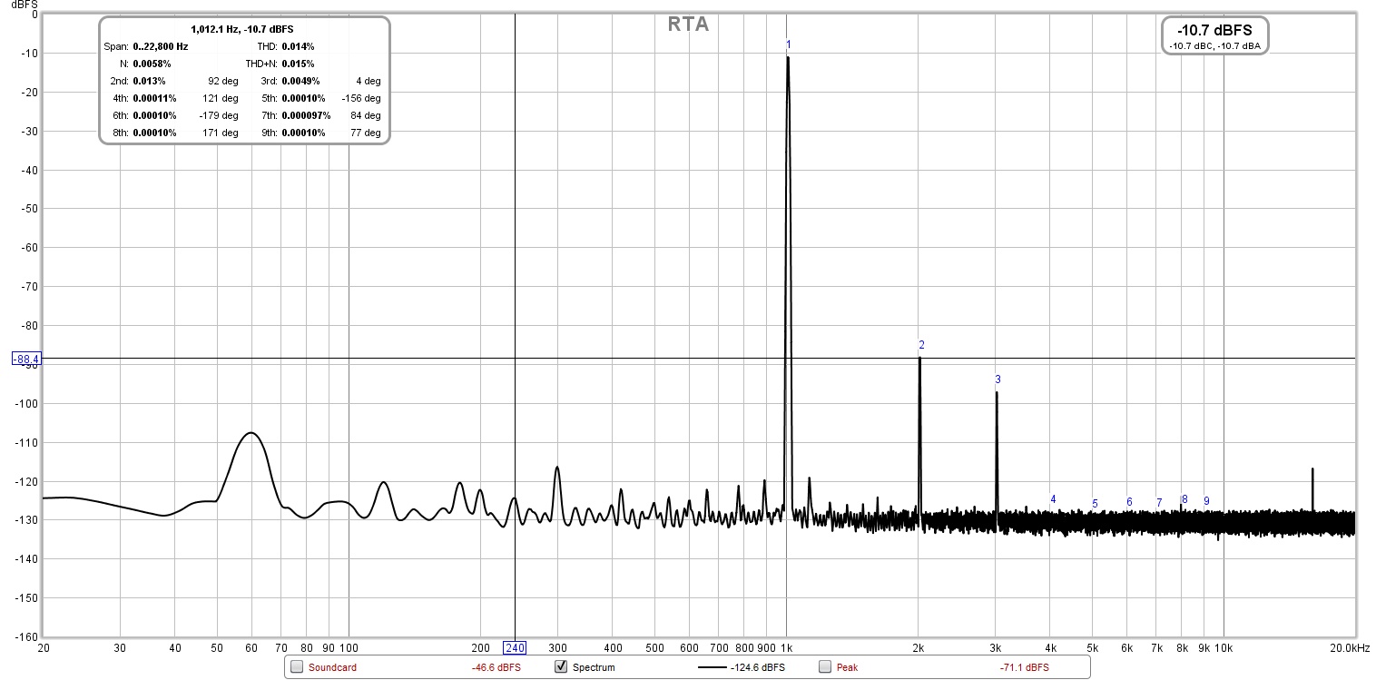

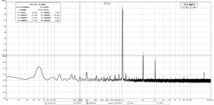

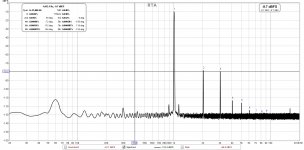

USSA-3.1
You need 2 sets for stereo...😉
I have been listening to the new USSA-3.1 with only 25 as DF and it really shines after long break-in and a couple of days listening ..🙂
Natural vocals, soundstage, instruments separation, dynamic sound and delicate nuances are impressive.
So do not let you fooled by DF value 😉
See THD profiles at 1W, 6W and 10W (all RMS) for 1k Hz under 8 ohms.
