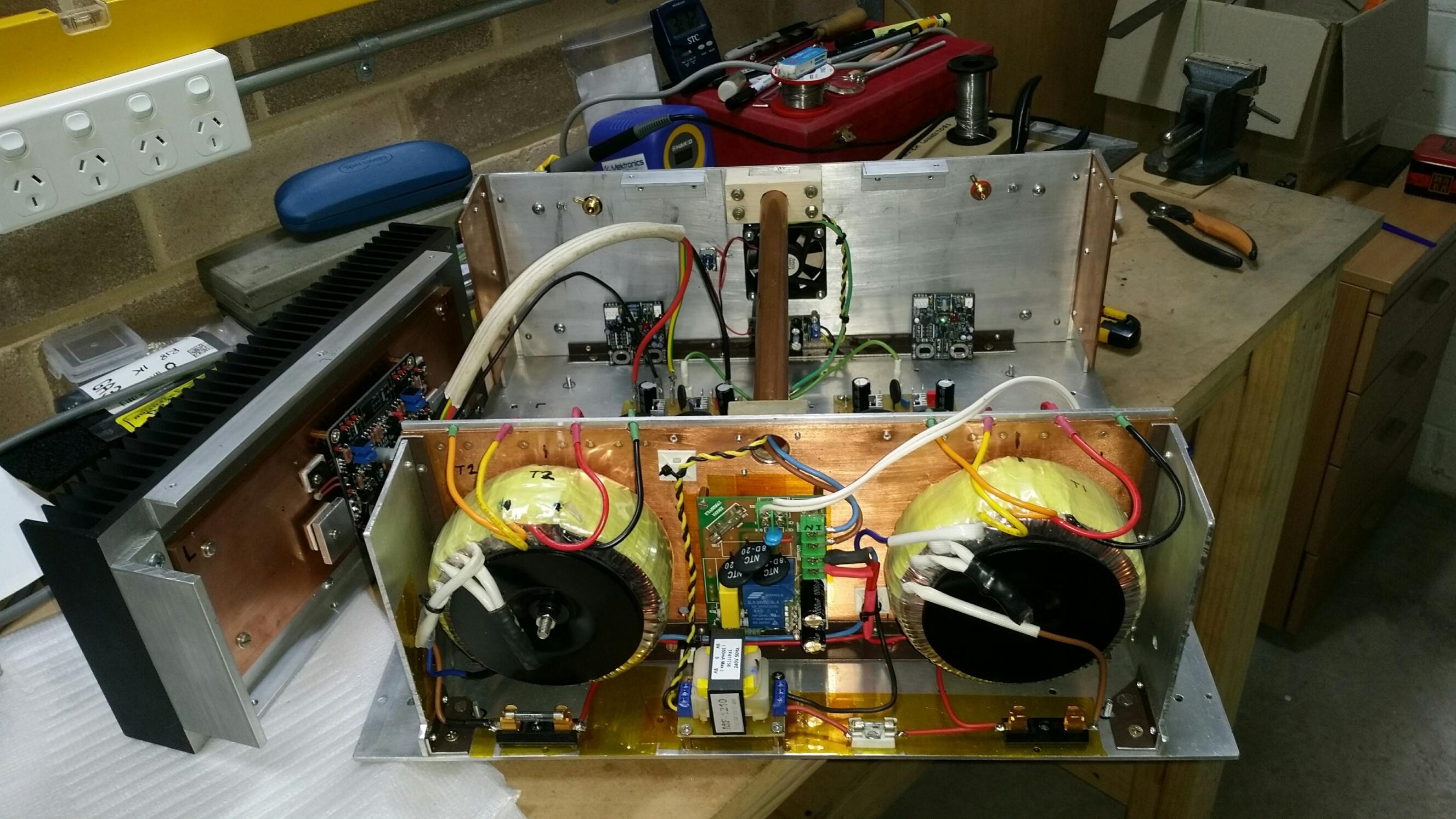

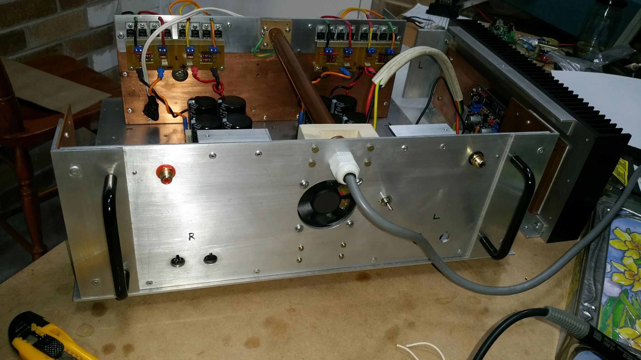

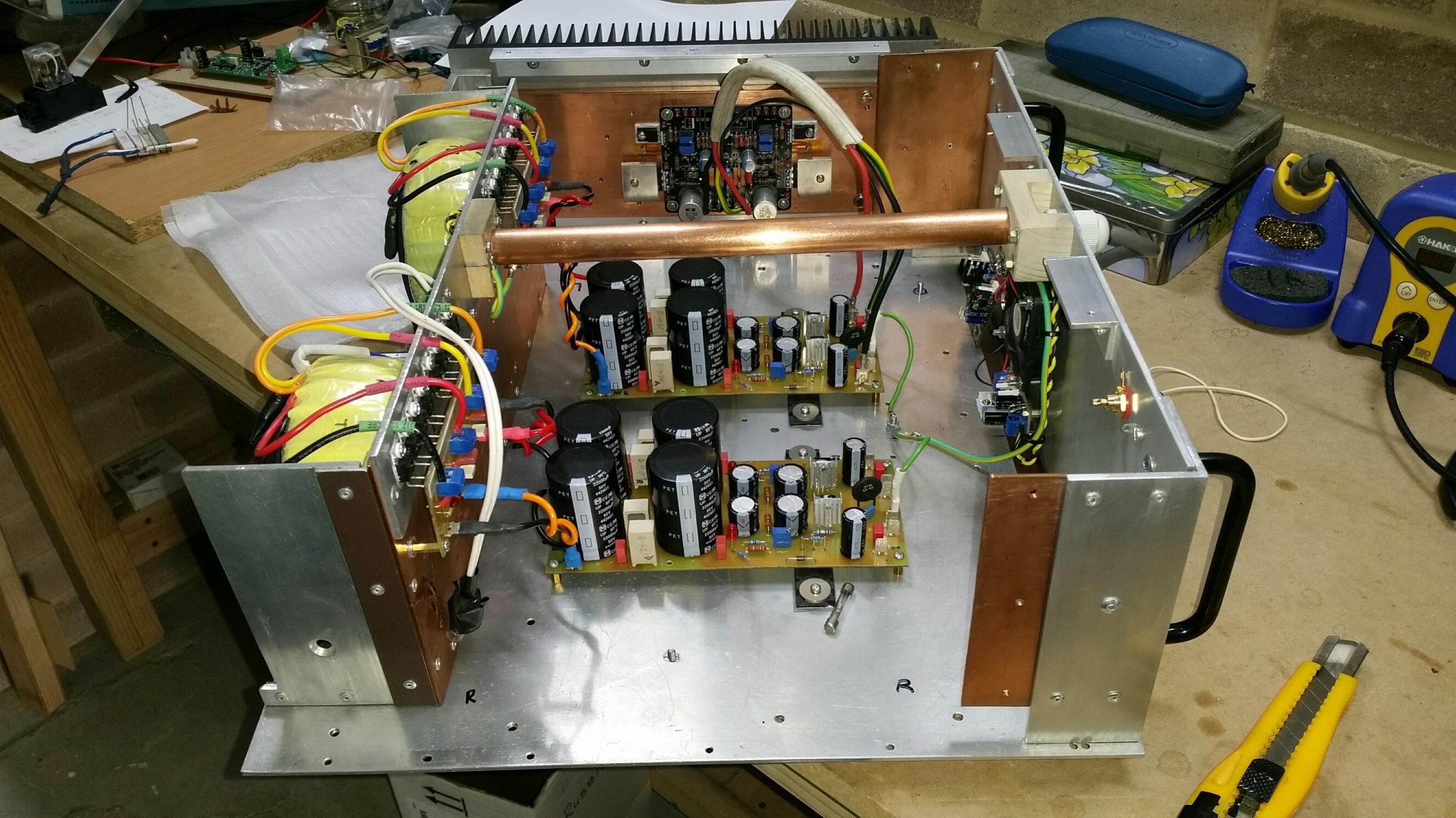

This is quite an implementation you have here. Copper plates, copper conduit for AC main line voltage, big PSU including capacitance multiplier, ....Thanks Fab. I have more confidence now.
Three different views of the amp I'm currently building. Cabling is temporary.
Mains cable goes through the copper pipe.😀
Keep us posted on the final assembly!
Fab
Wow, Nice work Harry3!
Looks like a “home brew” SLB with off board rectification. This will be one heavy USSA5 amplifier. Looking forward to viewing more of your progress 😉
Chassis
Thanks guys.
It was a PAIN to make a chassis from scrap metal. At one stage, in my rush, I put a drill bit through one of the transformers. A costly mistake!😱
SLB boards are home made because of the prohibitive price to Australia and the exchange rate. I prefer the originals because they are much smaller.
Separate rectifier boards are used so I can compare them to a LT4320 based rectifiers. I was hoping to see comparisons on this thread.
The aluminium angle (left over from the home renovation) will hopefully take away some of the heat from the heatsinks and transfer it to the adjacent panels. I’m aiming for more than 1.3Amp bias as the voltage at the amp boards is around 22 volts, good for 4 ohm loads.
I avoided using any metal attracted to magnets. Screws and washers are stainless steel or nickel plated brass. Resistors used are Vishay CMF or RN because they do not use steel end caps. There are other brands as well that are not attracted to magnets.
The copper which I bought cheap, from a scrap metal yard that was closing down, makes the amp very, very heavy and hard to lift. Hence the handles on the back and I will put handles on the front panel when I finish. The chassis is large, so modifications are easily done. It might have been easier to make two mono amp chassis?
Hopefully I will finish the build soon (when my wife lets me)……🙄
Thanks guys.
