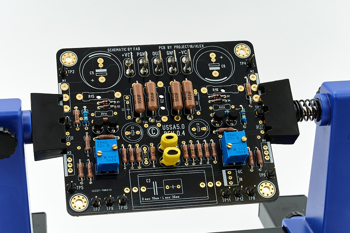

Nice build. You may try the Quasimodo-rig and populate the snubber pads on the boards, too. It's a noticeble difference (less harsh and cleaner midrange).

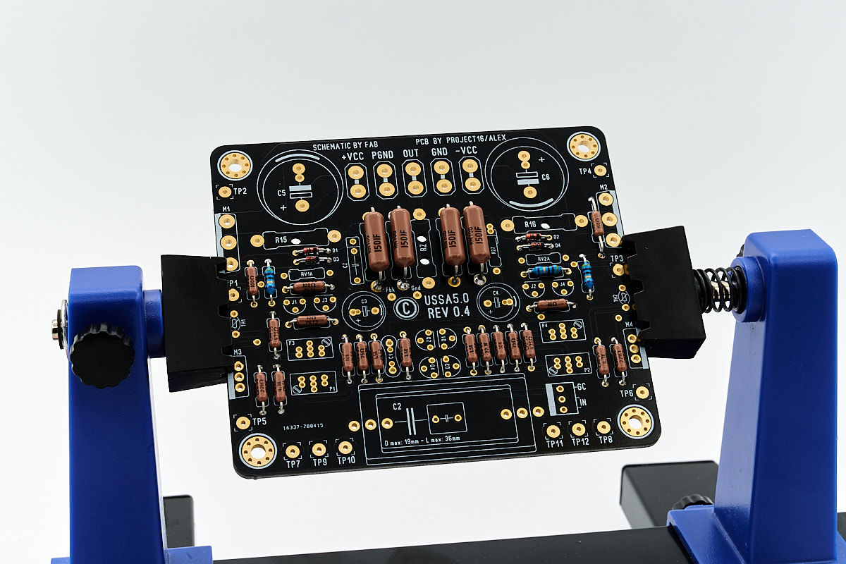

Thanks. More progress... Banana-yellow heat shrink tube
Q1/Q2 and Q3/Q4 are matched with 2,8% and 4,9% per pair 😎.
Now I'm waiting for the power transformer to arrive 🙄...
I like bananas
Nfsgame, you win the prize for the best looking input stage 😛
And possibly the best match too...

Snubber shouldn't make a difference on the LT4320 as it does not use diodes, so there should not be ringing. I know it does on the diode bridge. I have another LT4320 that I've setup on a class AB before making the change on this one and I could not tell a difference between snubber and no snubber on that amp. So I desoldered the snubber as I've been told it is not required on ideal bridge.

Hi NfsgameThanks. More progress... Banana-yellow heat shrink tube!

I'm still waiting for my ordered transformer from poland. The two boards and the chassis are ready to be powered. But without a power supply I can't go on...
