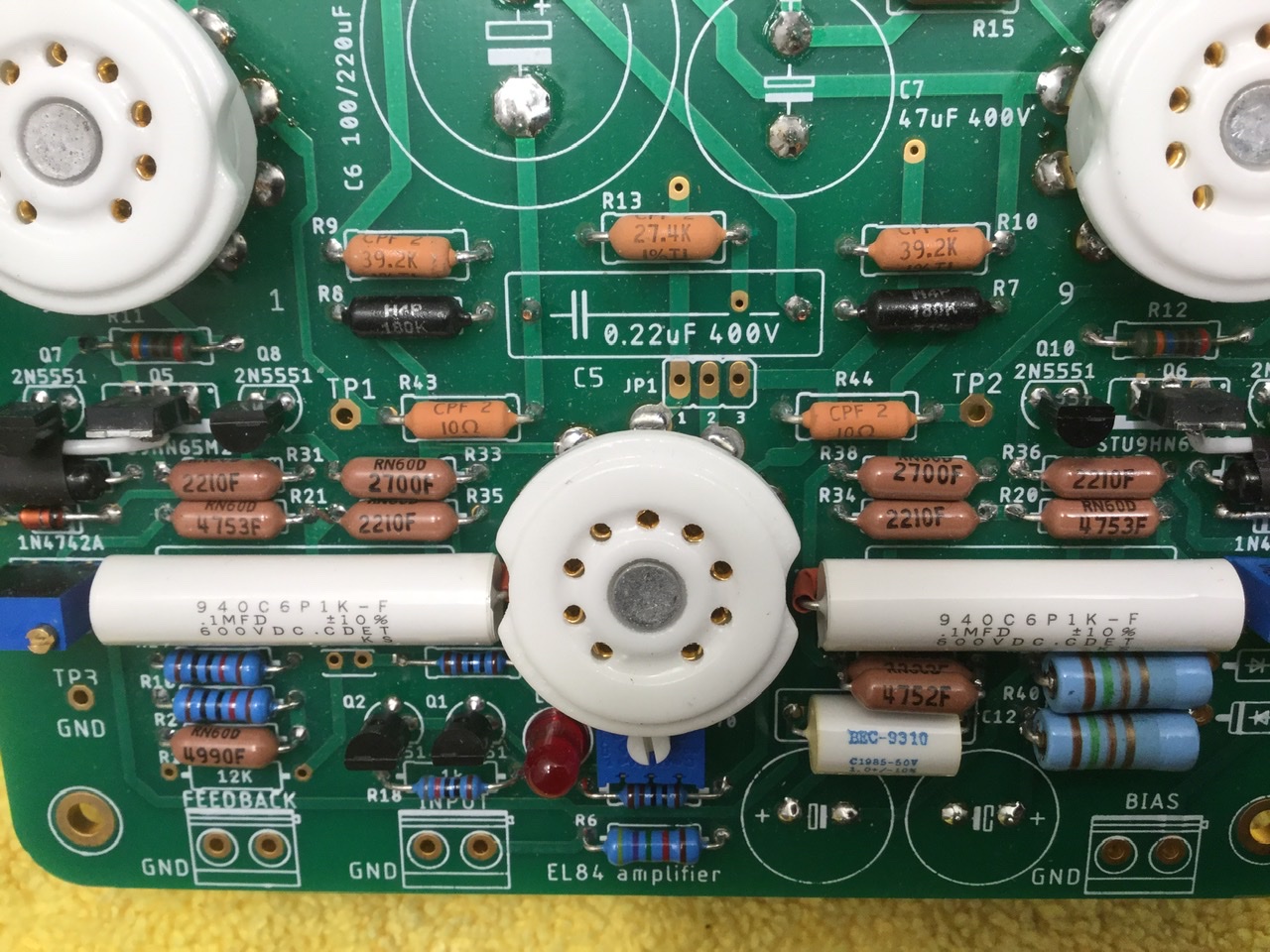

I first heard of the 940 and 945 series CD caps at Tube Cad Journal -John Broskie was impressed with the 945. I am using the 940 series in a Baby Huey EL84 build right now(see attached photo). I did switch out those small red cube Wilma caps at the input of my USSA5 for a pair of the red Mundorf 2.2uf caps that I had on hand. They will be a step up but certainly not an ultimate choice.

Unfortunately the 940 doesn't fit on the PCB if I'm not missing something? The pad ist some 38x20mm and the suitable 940s are at least 54x27mm. The biggest capacitance of this series that would "fit" is 1µF with a footprint of 34x21mm. But 1µF would bring some early cutoff I think...
I also agree with you all about the quality of the CDE 940C 🙂
They are very large for a given value though, even if you can physically fit them their leads are usually to thick to fit into the pcb holes. They are perfect for speaker XO as size is not an issue most of the time.
