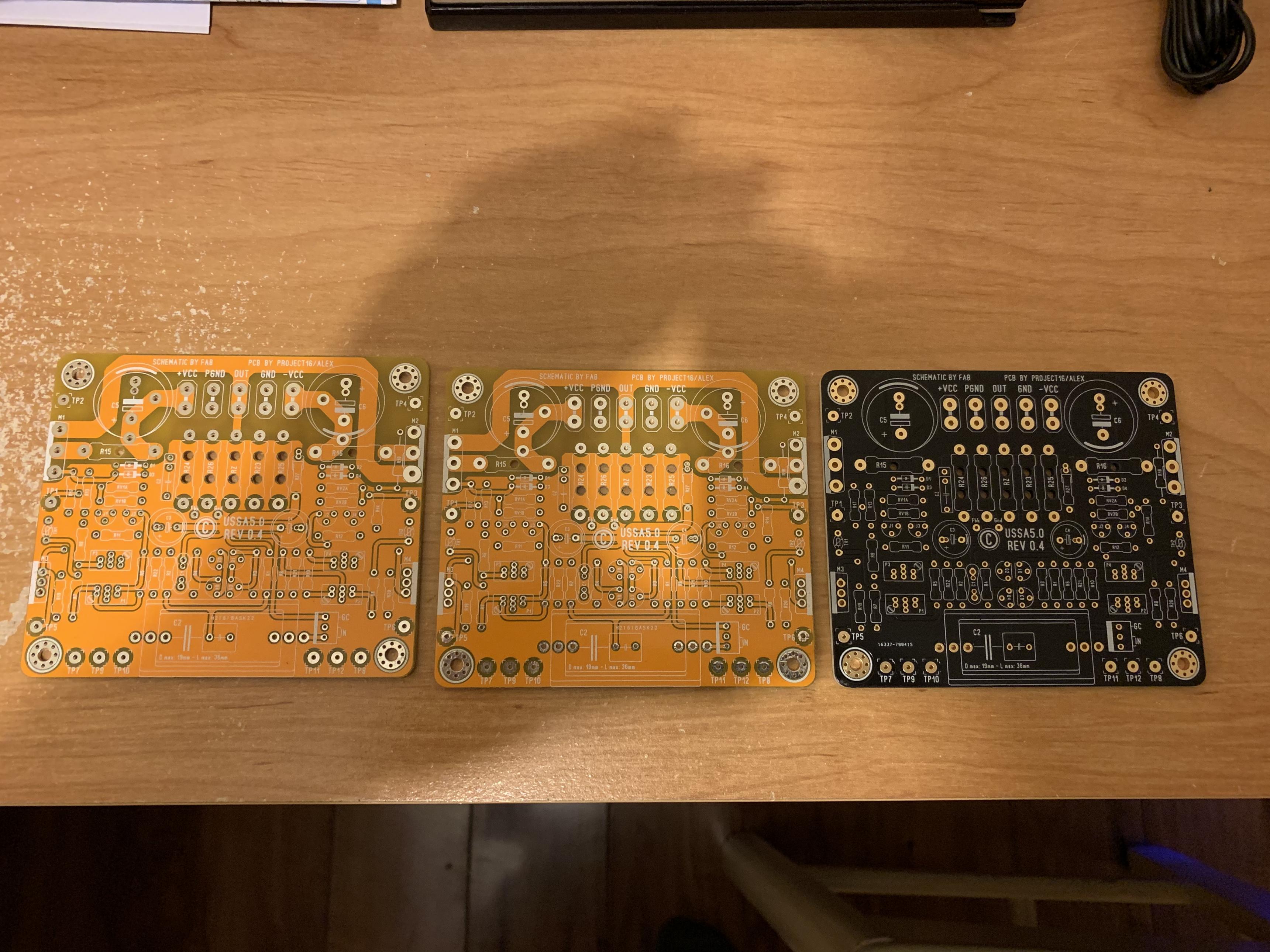

This is my only option right now from my remaining stock..

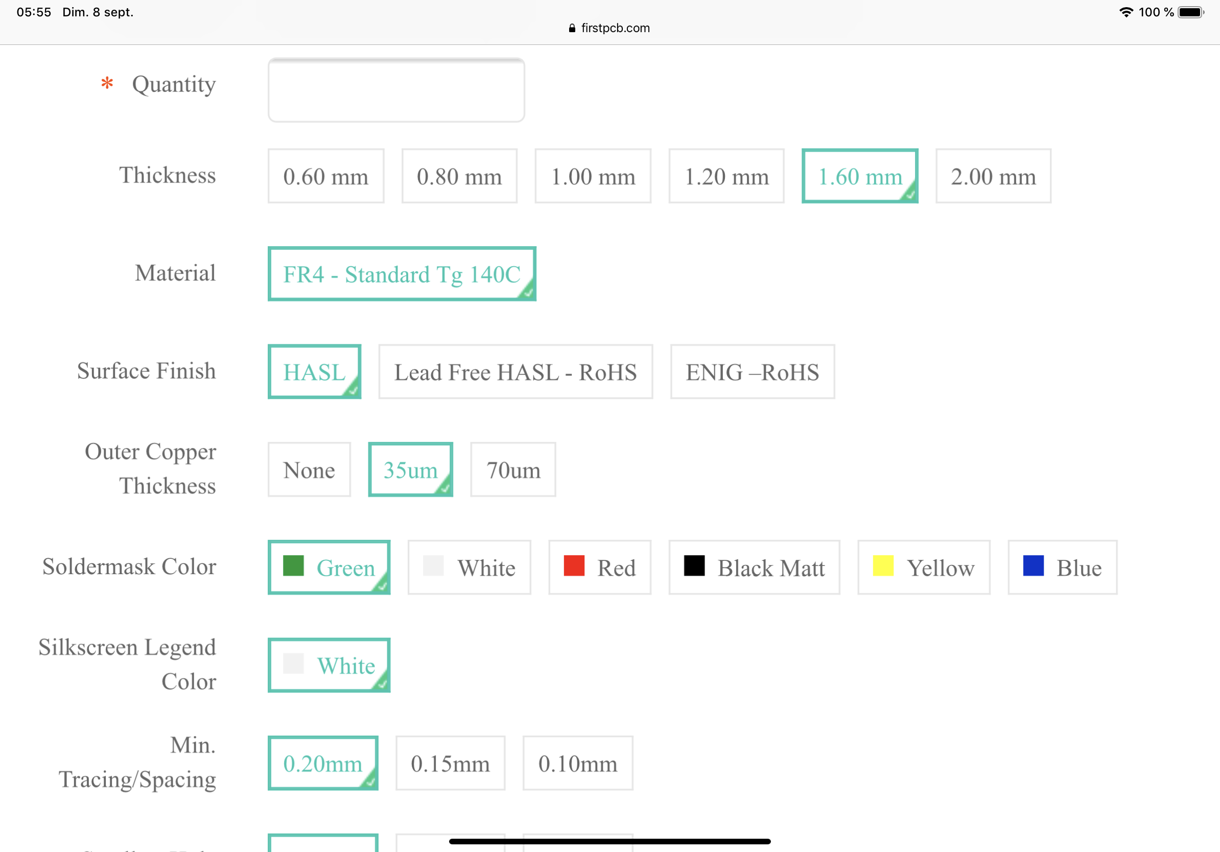

One black pcb : not an option
2 yellow pcbs but 1oz copper without gold immersion, lower quality in general
I would need a miminum of 5 pairs of pcbs to start a new small group buy...

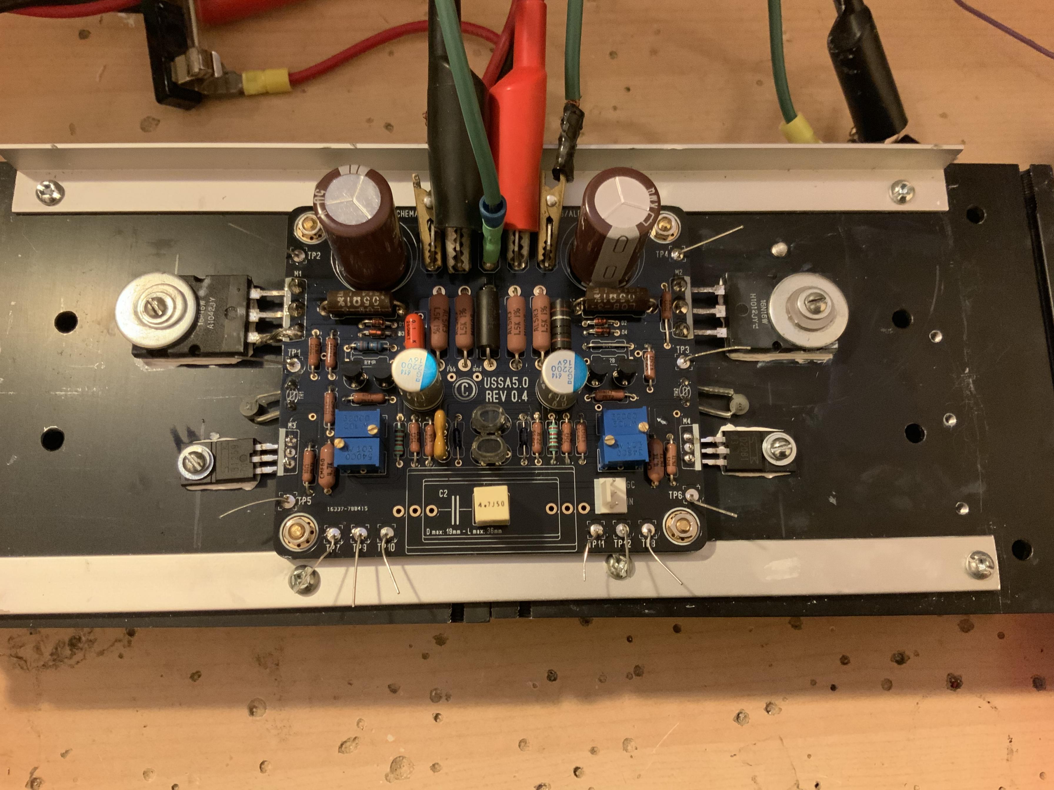

Hi manniraj
If you have 36vac total at 7A that gives 252VA. Normally I would recommend 200VA or more by channel. However it may be fine also with less power depending on the speakers used and the power demand need....🙄
I am surprised you get +/-27vdc rectified with only 2x 18vac...😕
I suppose it may be possible with a no loss active bridge, very small R and with no load connected🙄
With 27vdc you would get more class AB power but you may have to reduce class A power (lower bias current) for the same heatsink size.

I get this +/-27vdc on my CRC psu with my home mains voltage goes upto 240v rather than 230v sometimes. Hence this output dc voltage is with no load. I am using 0.47R 3W Panasonic resistors 4 per rail with 22000uf *4 caps per rail. Yes I think my transformer is rated under VA compared to the required as per your recommendation. But I think it should work fine with 252VA for both the channels.

For C2 you should use something better than the Wima. Use at the minimum the other indicated part number from Panasonic: ECW-FE2W475J. Even better to use ECW-FD2W475J. The latter part is quite good for the price. As you can see there is enough room on the pcb to put a lot bigger cap.

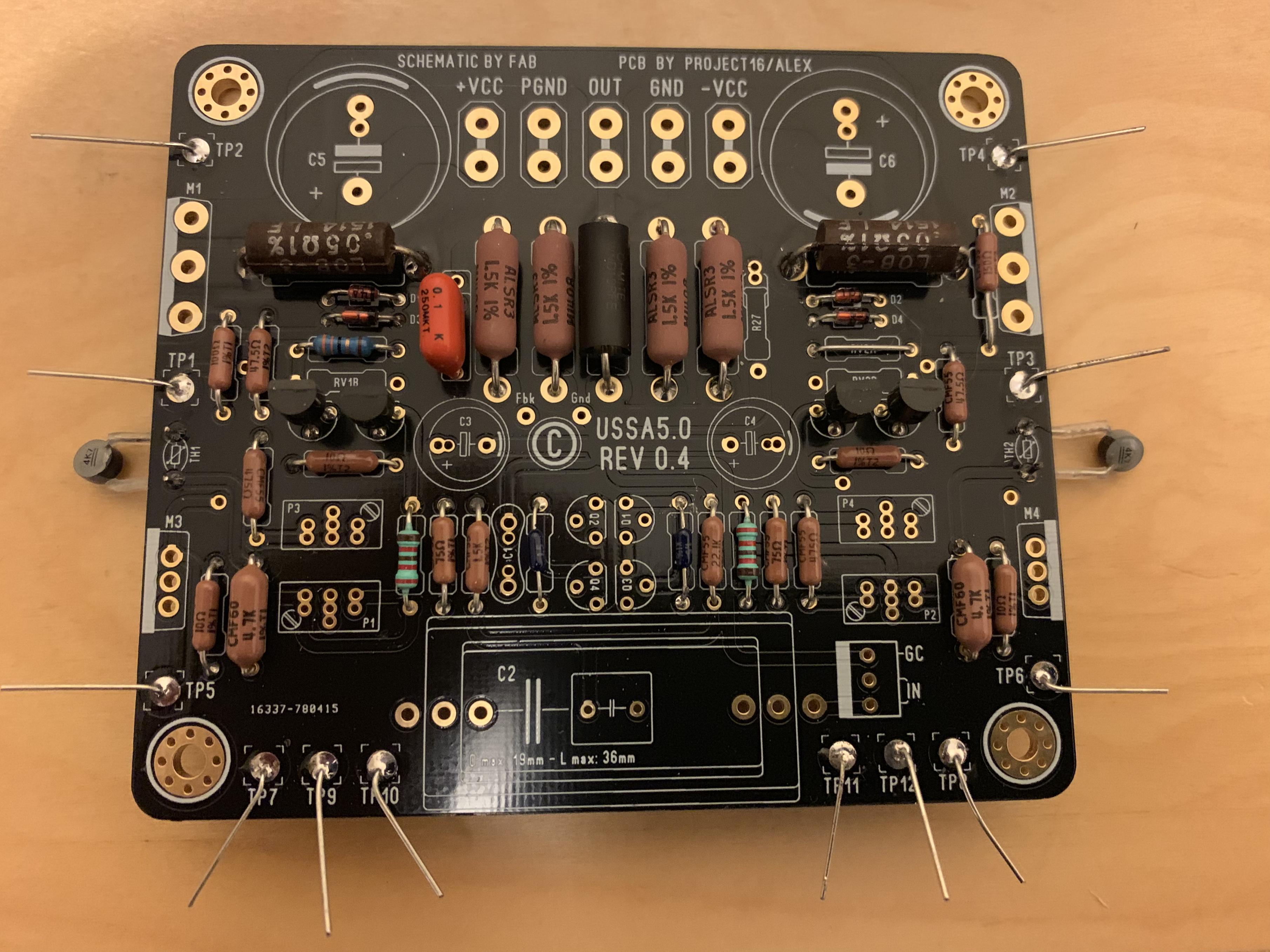

Hi Fab, a quick question regarding my above pic where I soldered going through the manual. I have soldered those black color R15,16 resistors (0.05 OHMS 1% 3W) as well on to the PCB and I hope they are fine for the initial setup and recording the voltages etc.,
Ok then you will see or....rather hear 😉

I just want to clarify that until now the pcb layout should stay the same for both USSA5 and USSA5.1 schematics. Only driver and Input/driver current changes so far. Therefore there should be no need to differentiate them. If there is any change to pcb layout then the pcb layout version would pass from version 0.4 to 0.5. Also Have in mind that there are already red, blue , black and yellow colour pcbs sent to builders.
And for zman01 purple colour suggestion it does not exist at my pcb manufacturer supplier...🙄
However, I will select the most popular colour for the new buyers so please indicate your choice.
I just started to assemble one channel of USSA 5.1 with my single remaining black pcb to test it electrically to verify performance against original USSA 5 so stay tuned...
