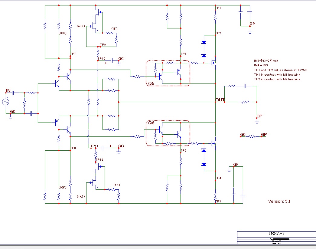

Version 5.1....?
Hi
Maybe this should be an interesting version using darlington Sanken transistors (Q5/Q6) instead of the obsolete mosfet drivers...😉
Aside the driver change it requires some resistors changes. The idea comes from my FSSA2 amp. I was not convinced at first but playing with the simulator shows that it should work fine. Also, based on the similar sound between my FSSA1 and FSSA2 I believe it is worth the try. And the good thing is that the pcb stay the same (Fit Form Function) 🙂
Any Fearless Amplifier Builder 😉😛 ?

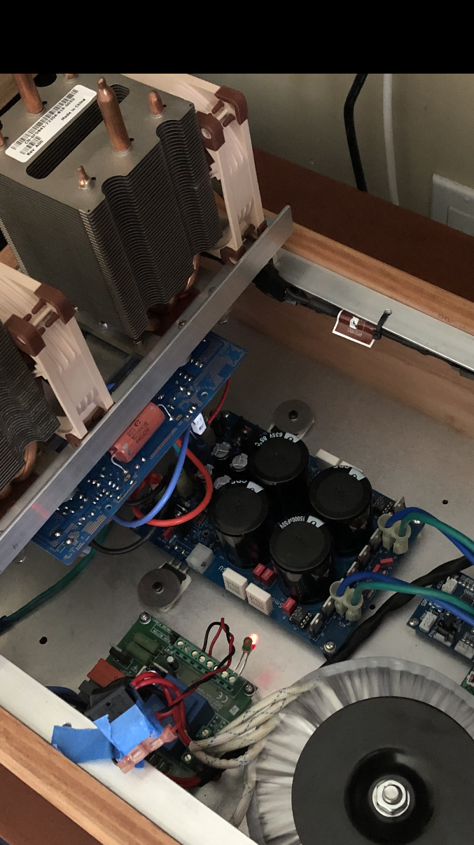

I’ve used a few different cap multipliers with class A builds in the past, but the SLB psu with the inclusion of an active rectifier and CRC works excellent! I use an Antek 400va, 2 x 20v trafo with my Alpha20 which has very similar power demands as the USSA5. This setup is good for 23.5vdc with each amp board drawing 1.3A, and totally silent background!!

Definitely with active bridge, cap multiplier and CRC this is the best PSU🙂
In fact the bias current requirement for USSA5 in class A should be less than for the ALPHA20 from my understanding. The USSA5 is push pull using mosfet with almost no degeneration increasing class A power. Therefore, +/- 23,5vdc with 1.3A is more than enough.
