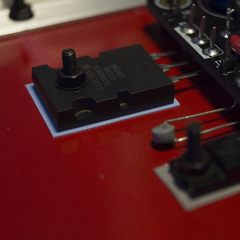

the paint underneath the mosfets has been removed it is just the pad covering it, I didn't use any power tools to make sure the surface is flat (took me an hour and half ...).
I used paste this time as a desperate attempt to make sure I have full contact between the surfaces, didn't use it before as you see in the pic, also before that piece of aluminum I used 3/4" fender washer but changed it last minute just to make sure i have same force clamping it down all over.

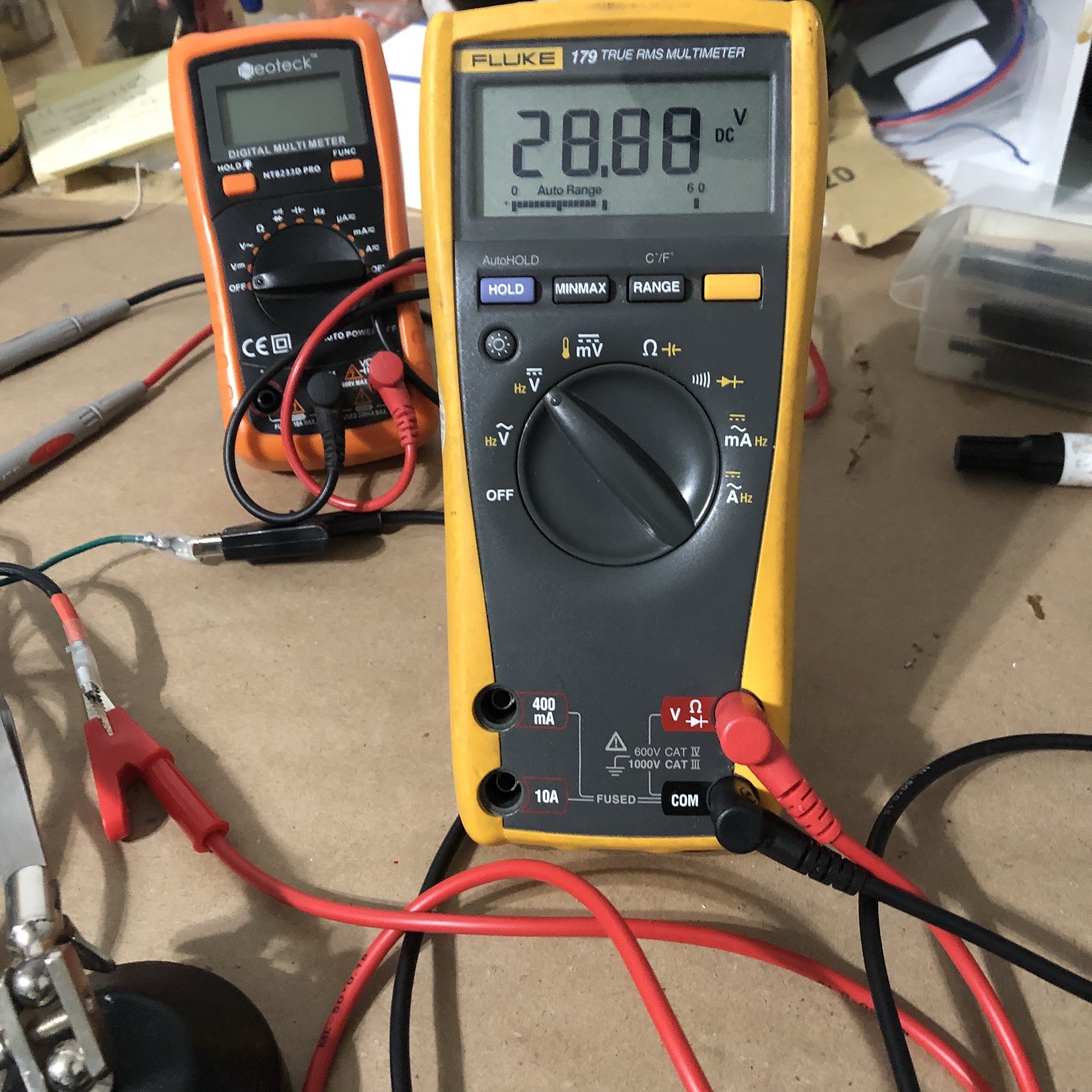

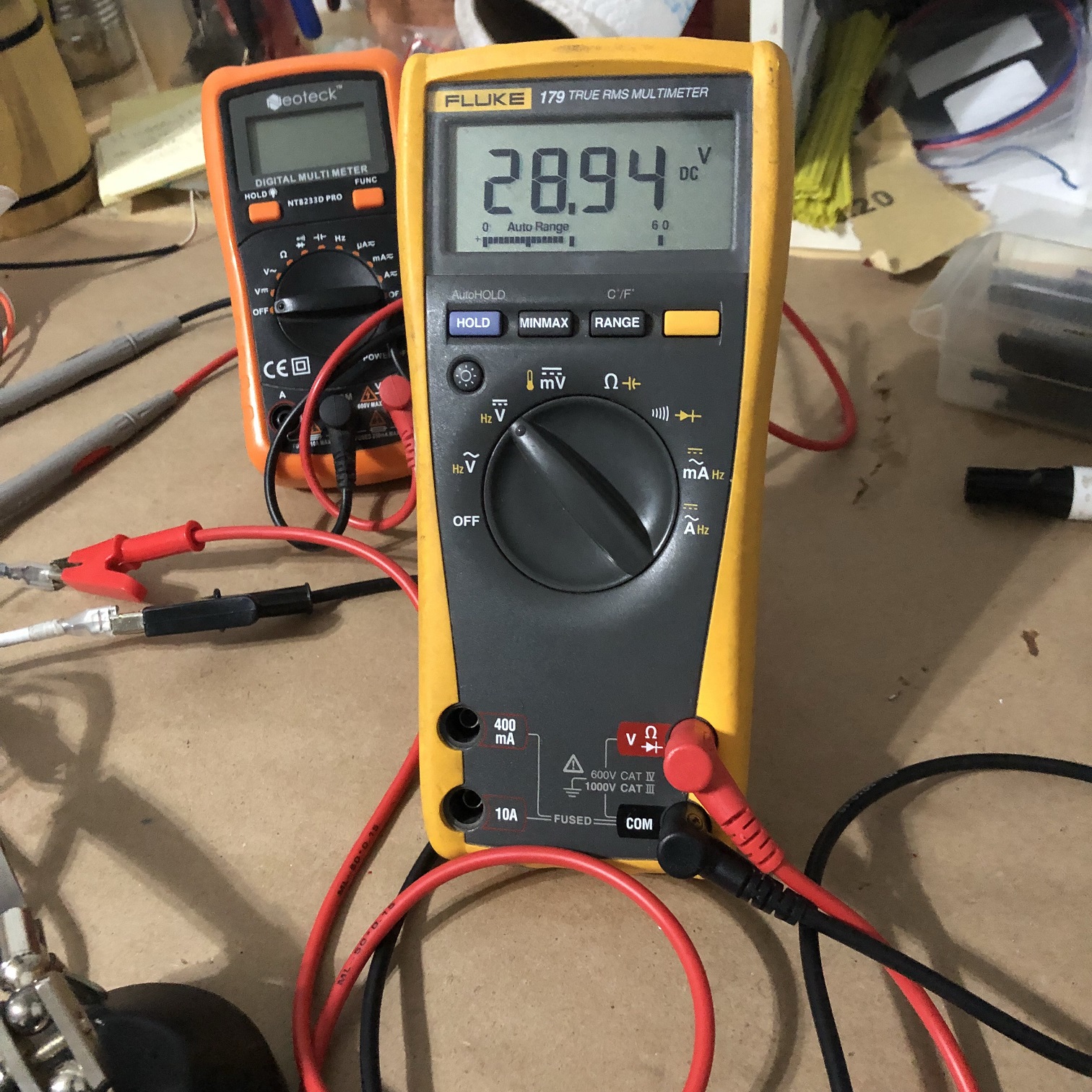

also the +/- voltage is the same as you can see in attached pics 🙁
I just ordered a thermometer and it will be here next few days, just to measure the temperature differences, I think at this point I have to take an step back and re do VGNS/VGSP measuring and biasing. I m doing electronics and building amps and stuff as hobby for last 20 years and i lost count of how many stuff I built and never felt this dumb 🙂) haha. it is usually something so simple that you over look.

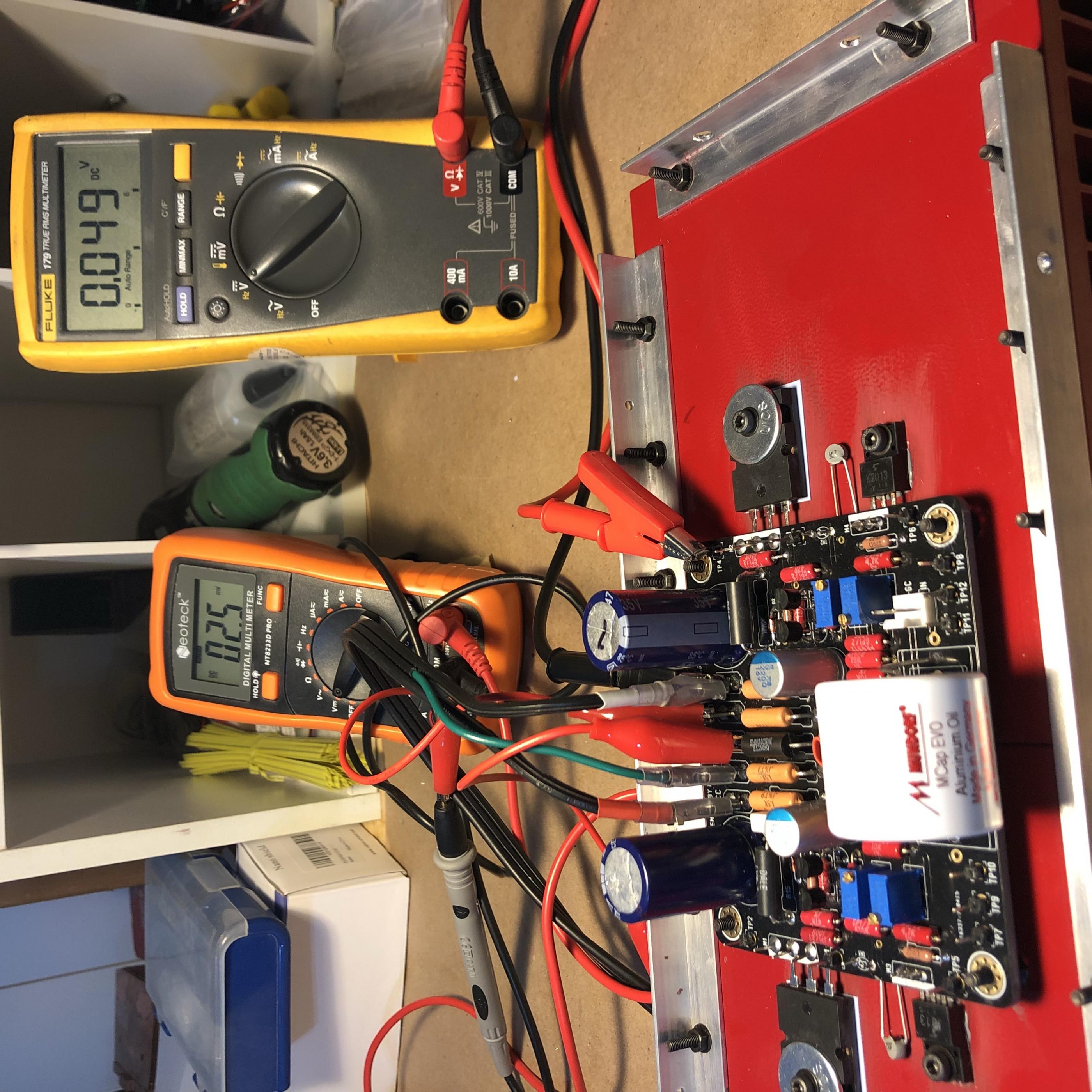

Atto,
Follow this procedure:
To adjust the bias (50mV) and have 0mV as close as output offset it is necessary:
- Place a multimeter on the output that will allow you to see the offset.
- Place the second multimeter between TP4 and V- or between TP2 and V +.
Explanation:
- If you chose TP4 and V- you set P1 very little to increase the bias and then you set P2 to decrease the offset.
- If you chose TP2 and V + you set P2 very little to increase the bias and then you set P1 to decrease the offset.
In fact you increase the current and you go down the offset by touching both trimmer without moving the multimeters.
Do this for your setting:
- Put a multimeter on the output.
- Put the second multimeter between TP4 and V-
You will not move these two multimeters during the settings
- Set P1 a little to increase the bias (do not go to 50mV again), and set P2 to lower the offset (P2 increases the bias of the other mosfet).
- You touch one after the other P1 and then P2 until the display of 50mV on a multimeter and 0mV ~ on the other multimeter.
This way you have your balanced bias on both mosfets.

I finally got some time to do as ggetzoff suggested, also got my thermometer !
I changed the power supply design a little bit, now both channels are identical +/- 28v, also I removed the thermal paste underneath M1 and M2 and changed the pads to the new ones and replace the aluminum pieces to 3/4 fender washers, I removed the pads under M3 and M4 and added some thermal paste as Fab suggested.
Test process:
it took about 30 minutes for the offset and bias to finally become stable meanwhile it was changing constantly.
after 30 minutes I finally got it at 2.5-3mv offset with bias of 49-50mv. it changes up and down a little but not drastic like before.
I also measured the temperatures, M1 still get fast pretty quick after 20 minutes it was about 160 F !!! but after that it stayed at that temperature. M2 took longer to heat up, after 30 minutes it reached 120. the heatsink close to M1 was at 140 and close to M2 was at 113, so the thermal transfer is working.
I still fill like 160F w no load is pretty hot 🙁

It seems to me that in the photo the GND is not connected (only the PGND) and suddenly the input stage and the CCS are not connected to the GND via R27.
Maybe the picture is misleading.
GND and PGND is connected w a wire soldered to the post, did it since I couldn't find find all my alligators during VGSN/VGSP measurement.
Also, potentially the paint under the thermistor can give wrong reading due to poor heat transfer of the paint surface?
that is a good point, will remove the paint 😉
Thanks.
It is effectivemment possible according to the thickness of the painting which can make barrier.

Update: so I removed a little more paint around M1 and M2 also removed the paint under thermistors and whola ! it made a huge difference. both M1 and M2 have the same temperature around 140-147F after 20 minutes and the heatsink is around 125-135F, also the heat is much more uniform and steady across the whole heatsink.
Bias wise i get steady 49mv with offset of ~0.8mv, it is almost stable after 10-15 minutes (may change back and forth between 0 and 1mv) 🙂 I have almost identical results between both boards, the first board tho is much more sensitive while turning p1/p2, slightest touch and it jumps up and down but at this point it is stable with same numbers 🙂
so i guess the whole problem was the thick paint under thermistors.
