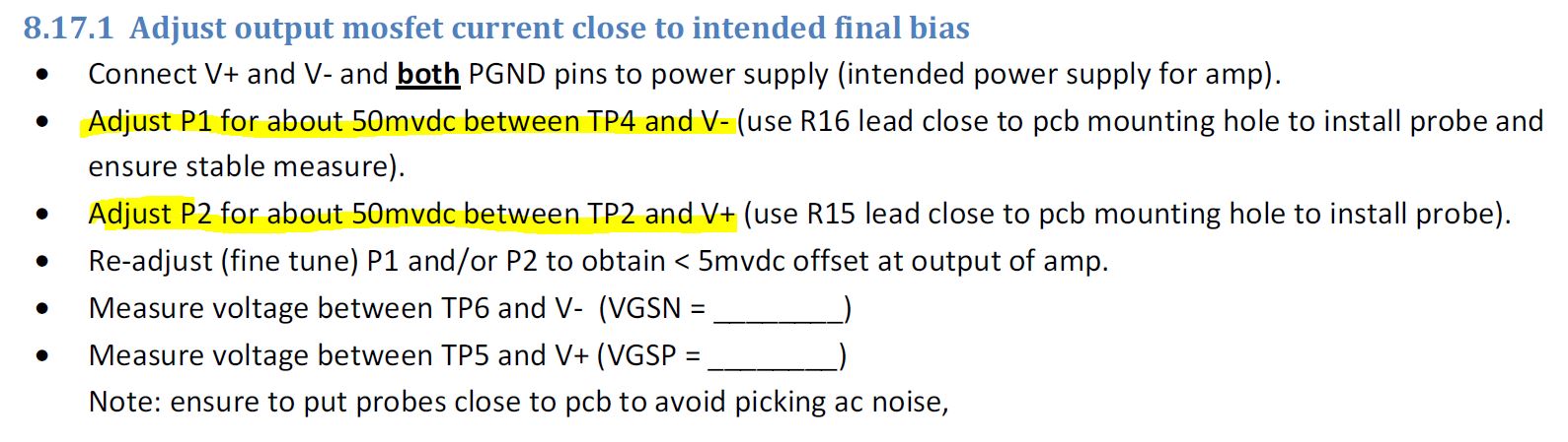

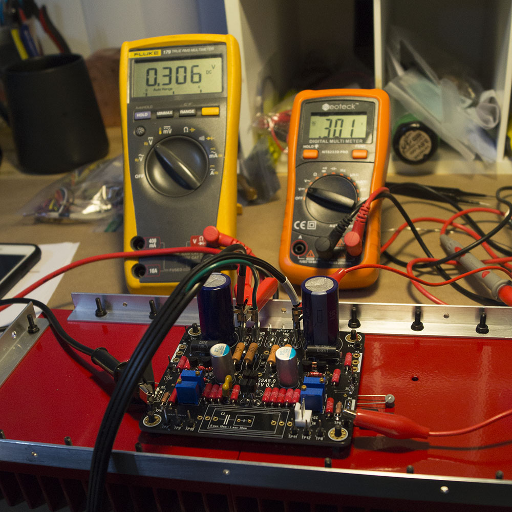

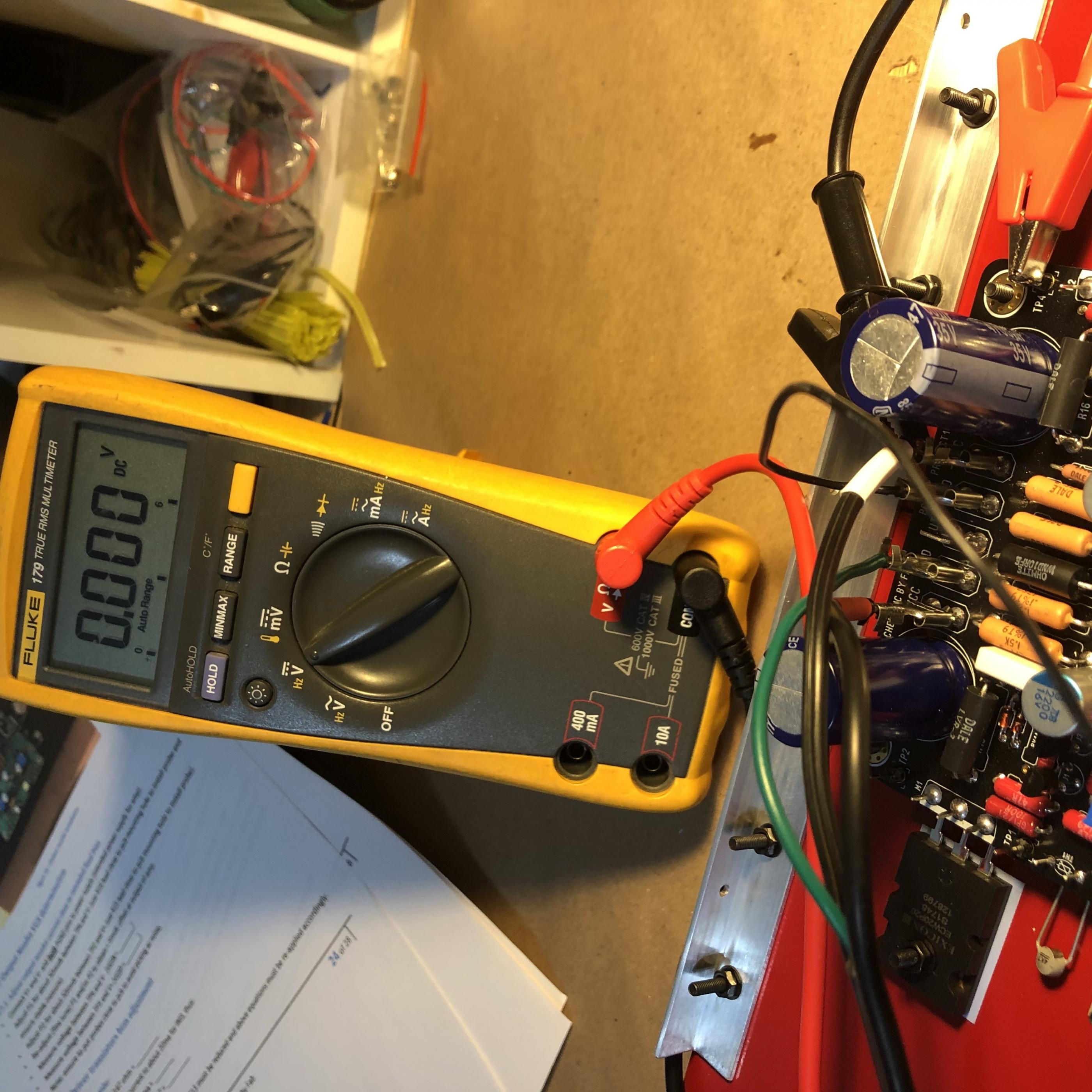

I finally got the 1.5K 3w meal film resistors a few days back, Everything was going as in the manual, got 0.3Vdc in chapter 8.14. until I got the laterals installed, I connected the board to intended power supply, connected both PGND and GND as described in 8.17.1, but the reading between both TP4 and V- and TP2 and V+ on both boards are zero, I checked the schematic and is n't TP4 and TP2 connected to to rails via R16 and R15 ? 😕 what am I doing wrong here ?
Hello Aatto
I no longer have documents because my PC is HS but I checked the connections on a printed circuit board.
TP1 => + VCC
TP3 => -VCC
TP2 => R15 (source M1)
TP4 => R16 (source M2)
Yes, TP4 and TP2 connected to rails via R16 and R15.

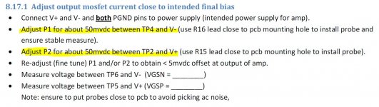

Fab has set 0.3Vdc in chapter 8.14 to have these 0V before setting the BIAS to avoid problems.
Now you have to set the BIAS (50 mV) and I invite you to proceed as follows:
