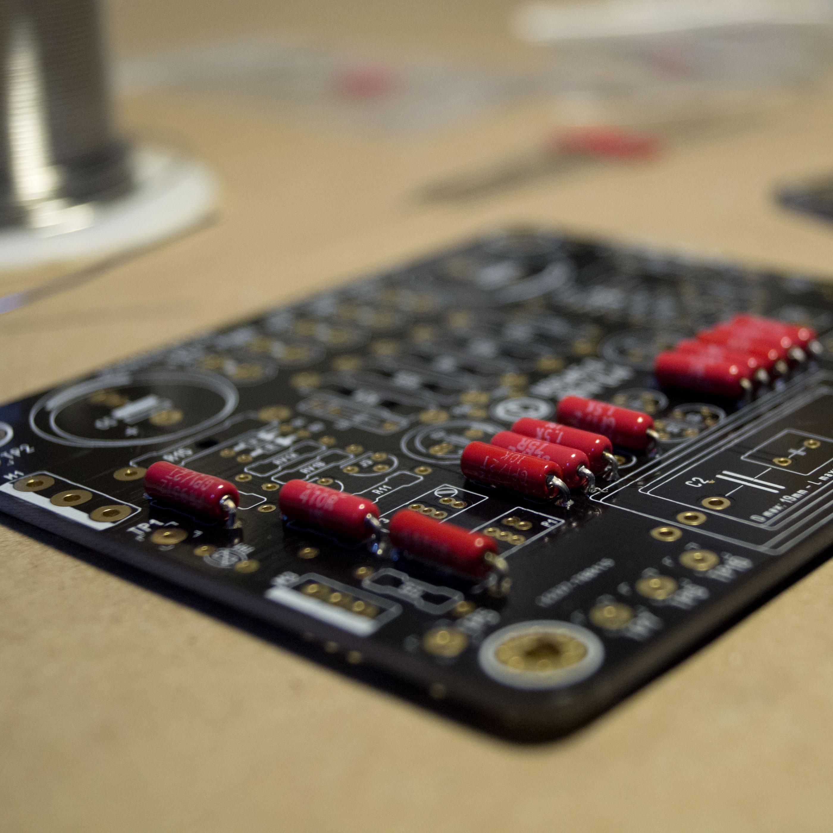

Aato, nice shot and good to see the build commencing - keep us posted on your progress.
Do you have all the power supply components in hand too? Which power transformers did you go for?

Thanks Zman, Yeah I went with Antek 20v 400VA, I know it is a bit smaller than recommended but we'll see if I can get away with, also went with 20v rather than 18v because I m planing to use cap multiplier.

Looking good Aatto,
Everything is lined up very nicely! Like those PRP

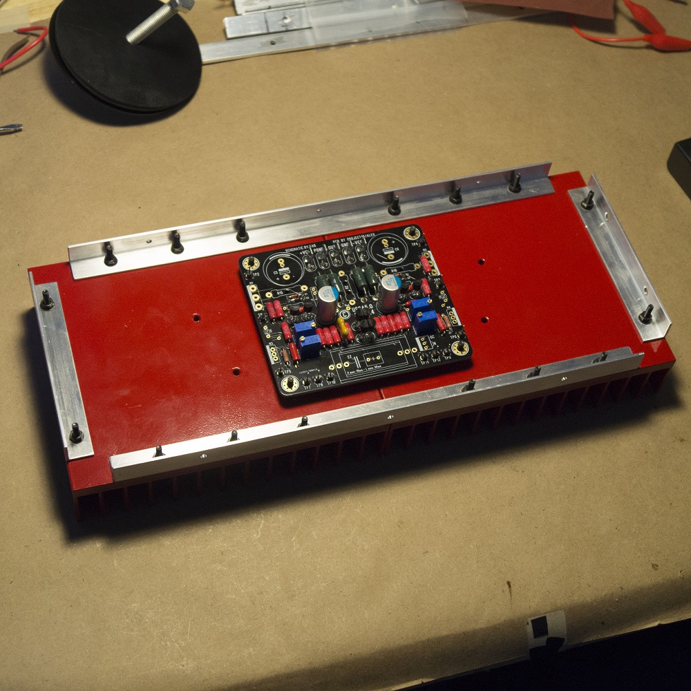

It looks like the four green resistors are wound resistors (RB59).
good eye 😀. Yes they are for now, I ordered the wrong ones, will keep them for testing purposes before I change it to suggested ones.😎

I have tested same green Vishay Fernice wirewound ones on Alpha. They definitely increase distortion in the feedback position. Best are Panasonic ERX Metal thin film. Carbon film works well too but hard to get precise values.
Looks like higher wattage metal thin films is not generally easy to come by.I have tested same green Vishay Fernice wirewound ones on Alpha. They definitely increase distortion in the feedback position. Best are Panasonic ERX Metal thin film. Carbon film works well too but hard to get precise values.
Anyhow I matched the heatsinks to PRPs, 😀
Nice looking heatsink !Looks like higher wattage metal thin films is not generally easy to come by.
You could have used first batch of pcb which was red color too.🙂

Aatto;553080\ said:Anyhow I matched the heatsinks to PRPs, 😀
