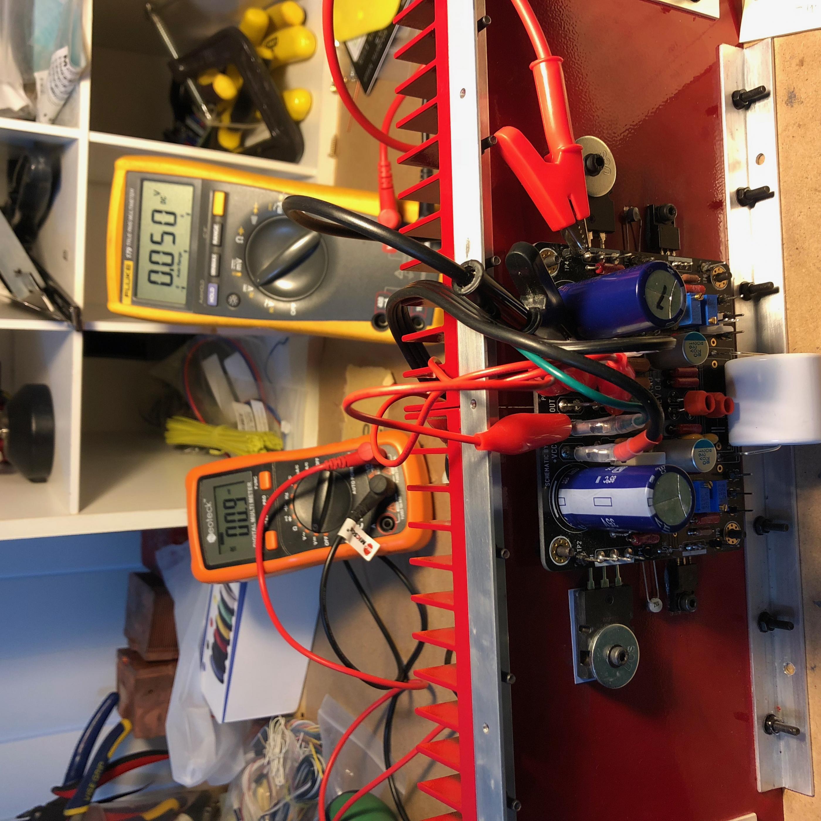

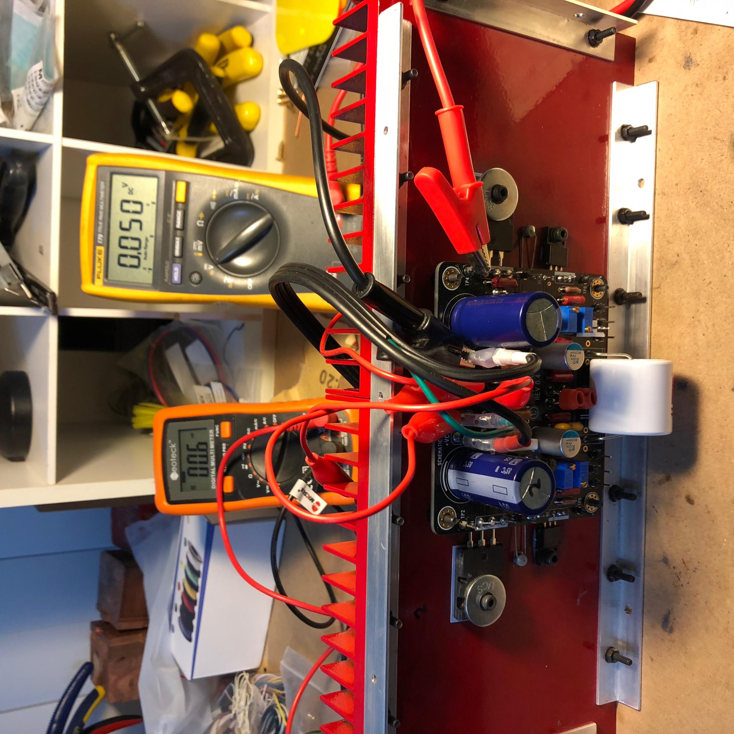

I did the biasing again and I got it all stable (at least for now).
both boards are set to 50mv bias with dc offset of 0.5-0.8mv ( sometimes it goes back and forth between 0 & 1mv ).
now that i have the heatsink vertical, the M1 and M2 temperature is identical on both boards, around 120 to 125F and the heatsink is around 115F 🙂
Thanks to Project16, that was a good point 😉
I ll have it burn in and finish the tests and do the final biasing next few days 🙂
Thanks everybody for all the help and support and sorry ggetzoff for hijacking your thread 😀.
please see the attachments.

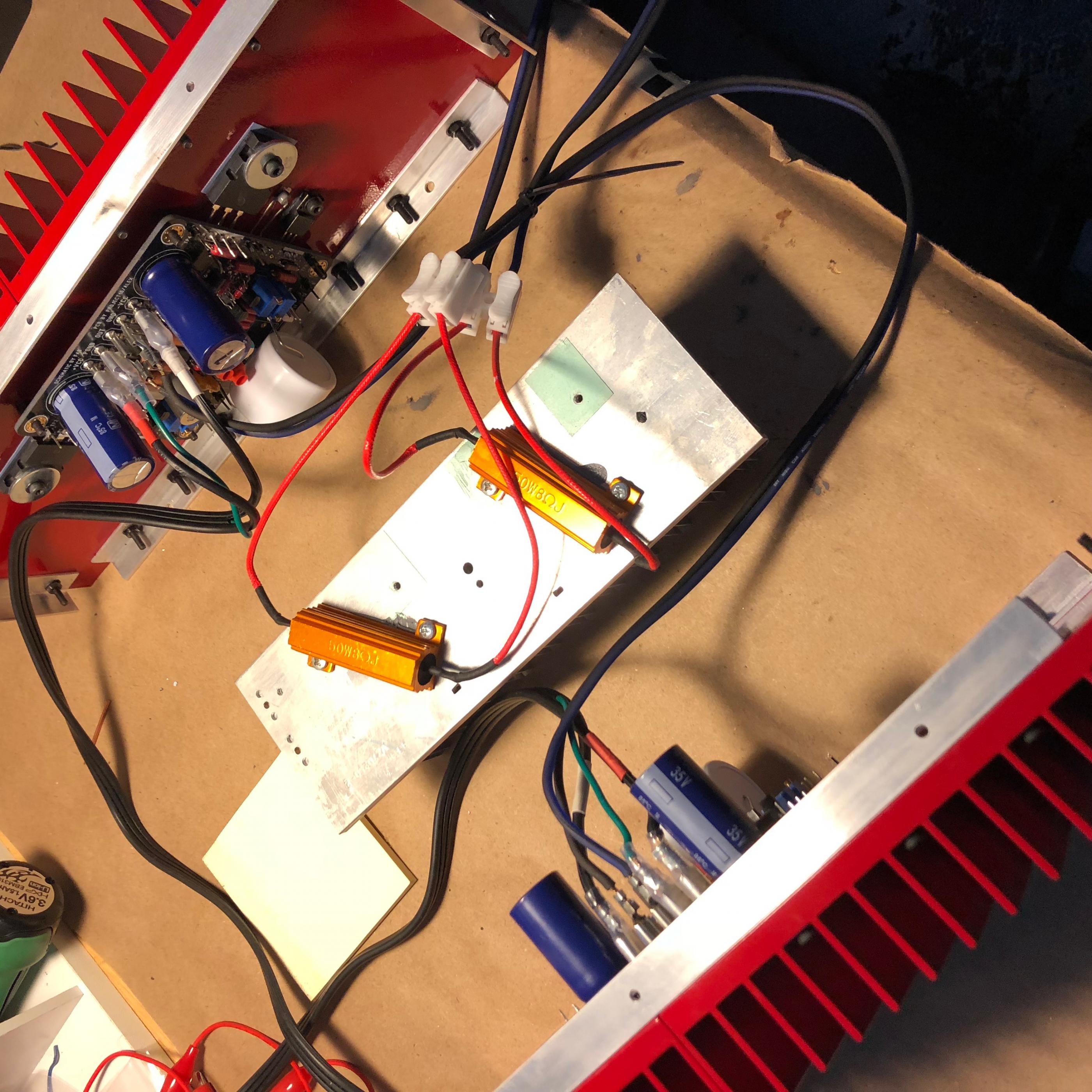

I haven't finish the tests yet, the bias is almost stable now, just a little tweaking after the last two times I set it.
I did however left it burn for like 8 hours, BUT, the impatient guy I am I couldn't resist and connected it to my old mp3 player and my test speakers (2.5" peerless fullrange), my very first impression was WOW ! 😱 very very detailed well separated, sweet sweet sounding amp ! I was impressed even through my test setup, very beautifully balanced class A signature, can't wait to hear it now ! 😀
thanks Fab for such great amp 🙂 and thanks again everybody for help and support.
I hope to finish testing in next few days and start listening to this monster 🙂
Edit: I measured the temp, all the lateral mosfets on both boards are in the same temperature range at around 120-125F, the heatsink is about 140F all around after an hour and half through second round of burning in.

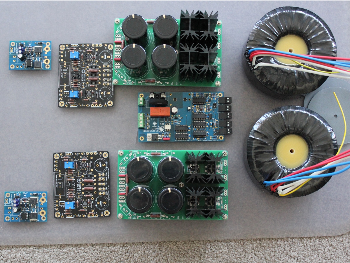

Things have started
As I promised Fab, my build has also started. I got some time Saturday to start soldering and managed to kick quite a few goals (see the photo). The soft start, speaker protection and power supplies are pretty much done and I am up to the stage with the amp modules that I need to supply some power to test things. I'll test the power supplies and soft start when I have some time and a fresh mind and then progress with the amplifiers.
One decision that I have made this morning is that I will make my own case rather than buy one. I've always done it this way and even though it is a little extra work I end up with just the look that I am after, which is black and not drawing attention to itself. It also means that I get to lay things out exactly as I wish because I am in control of every part of the design, apart from the heatsinks. This morning some big heatsinks were ordered. They are 350mm long x 151.5mm tall with fins 48mm long and have a temperature rise of 0.21C/w so hopefully I can get this amp running stable and relatively cool while pushing out its 25w or so.
Anthony
Anthony
