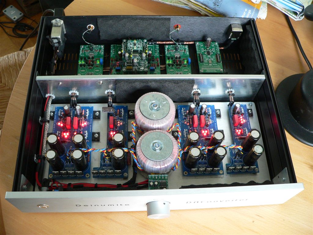

Hypno smoothing section only
Hello,
need help again. I want to power my LDR attenuator with a separate +5V shunt reg. (dvb-projekt one). Before the shunt board I would like to use blue dcb1 rectification and smoothing section only.
2x15 50 VAC transformer plugged, all 4 rectifier diodes in, 10.000uF cap on the positive supply, I'm getting near +24V volts. I was trying to figure out some voltage divider myself with resistors, as I need only +15V for the reg. Unfortunately I couldn't.
How can I get down to 15V after smoothing?

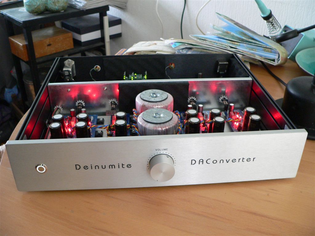

It's almost blasfemy cutting up those hypnotize boards.
They do a great job feeding my B2 dac !
