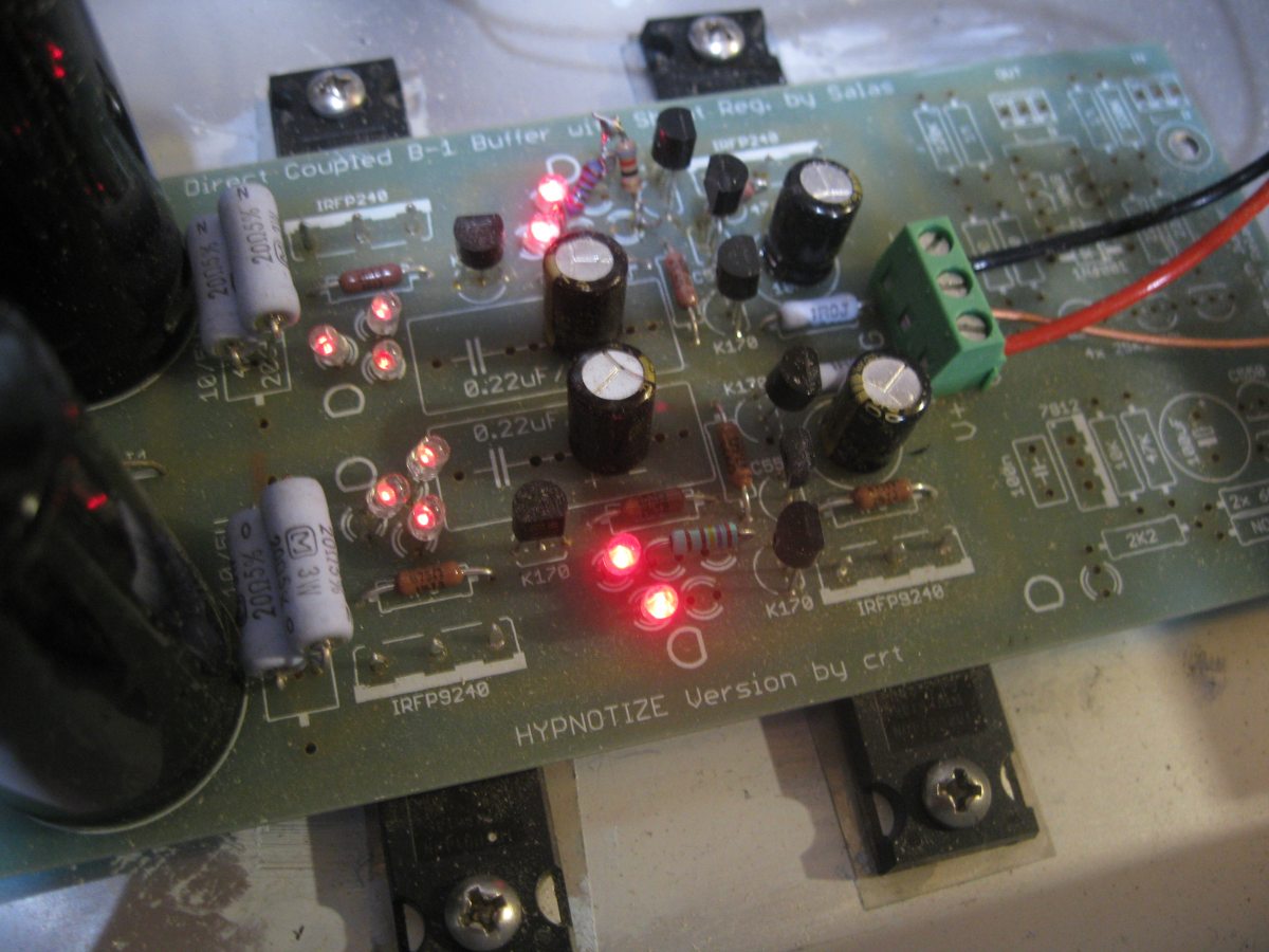

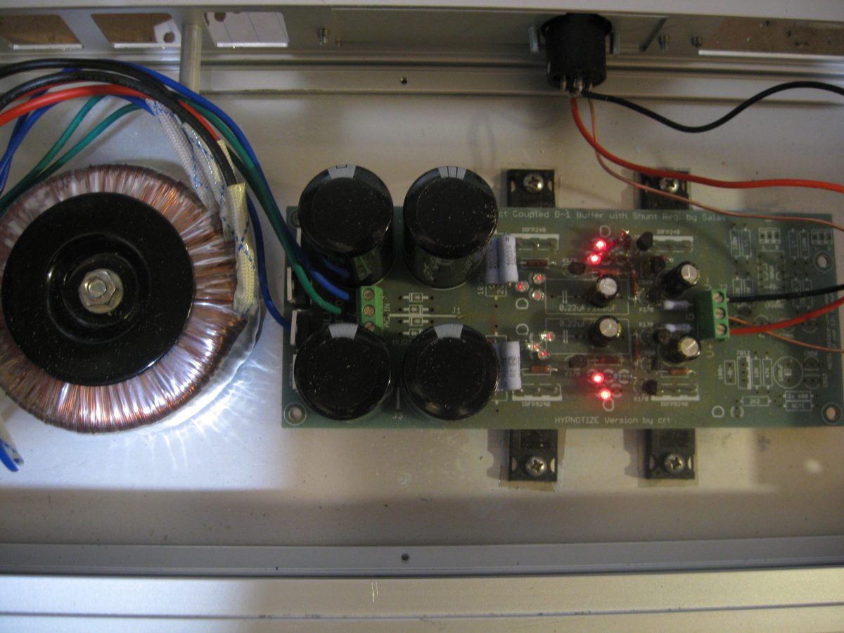

Salas Shunt Reg for Pearl 2.
Here are a couple of Pics for the power supply I made for the Pearl 2. This is using a prototype Blue Hot Rod version with 10,000uf filter caps, and panasonic FM 100uf caps, Dale CMF55 resistors, except for the VOut resistors, which are from parts bin.
+/- 23.87 rails.
Even I can do it!
+/- 23.87 rails.
Even I can do it!
