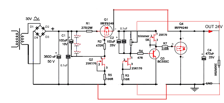

Using the HYPNOTIZE as a general shunt reg PCB
It's also like this schematic, the Salas shunt V1.0 ?
I managed to keep the powerleads at 10cm, but read that it can still benefit from remote sensing.

Hey Salas and hey all,
I haven't been here in a while... As I am catching up with the discussions, I have a question for you guys. You might remember me designing some PCBs for this, which are now in final stage of prototyping.
Regarding this - and I guess the question is mainly for Salas -, I've kept the traces widths at 1.5mm on all main current draw traces (allowing, according to some online calculators for 3.2A through, plenty for most purposes), while the current sense parts of the circuit use 1mm traces (2.4A).
Everything good with my thinking? Any thoughts on particular traces (connections) that would have unseemingly high current through? For instance, any danger in the two different trace widths to throw off the current/remote sensing device?
Thank you very much for your input.
I don't believe it is current rating that determines trace width.
I think trace resistance and trace voltage drop are far more important in determining trace width.
We are looking at uV values in measuring voltages and sending error signals around this PCB. I Think you should consider uV not Amperes
The RS lines sense voltage and are high impedance. Their gauge has no consequence.
look at post383.
The sense circuit is isolated in the middle of that schematic.
As drawn, one can see the resemblance to a Wheatstone Bridge.
The Wheatsone bridge relies on very accurate balance of uohms to give the error signal at it's output.
I believe that layout is crucial to this balancing of uohms. Trace width may be inconsequential, but traces, their routes and lengths and where the currents travel is very important to getting best performance from the "high impedance" sensor.
BTW,
10mA through the sense circuit when controlling a 10V output is equivalent to a 1k0 impedance. That to me is a low impedance circuit.
In my view, when with the 1miliOhm Zo, 1000000x is relatively high so to consider equalizing gauges. Layout is another thing than gauge, as you said. Its primarily named a Kelvin or Thomson bridge what we do here I believe BTW.
