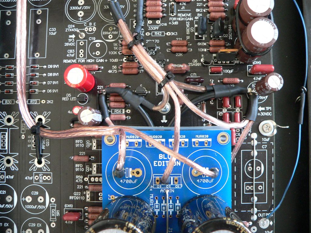

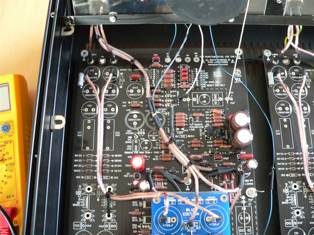

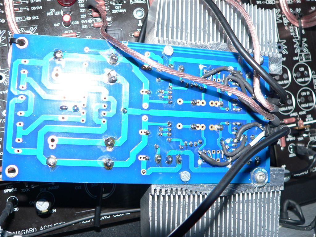

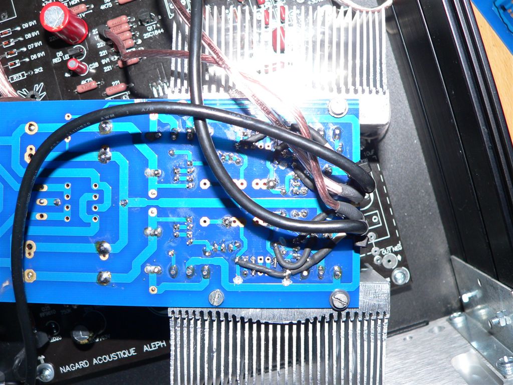

After having very good results (fast/clean) by hooking up my ONO phono to Hypnotize shunt I tried to use sense wiring. That didn't went well, I heard some noise coming from the shunt, the output voltage dropped from 30+ to 20V. Not connected the voltage was okay. I restored the voltage by adding another 100uF elco on the place were sense & load wiring meet.
Initial foundings :
the 2 delay relais didn't switch at the same time and the sink from one "-" pole of the shunt got hotter than before. The sound was slow and grainy. Slow because of the Extra 100uF and I think that the voltages from the shunts are not stable and having distortion.
You can see the 2 coax wires. left is - and right is +, those 2 little Elna's were added to get the output stable. + and - sense are connected at the load were they meet with the power + and -. Sense grounds are connected to the so called star earth = incoming 0 + input 0 + shunt 0 + sense 0.
I can't find out what I did wrong and the rebuilding of the Hypno did cost me a lot of time, I would rather fix this than go back to standard shunt.
If anyone can put a light on this that would be great 🙂
Regards, Erik.

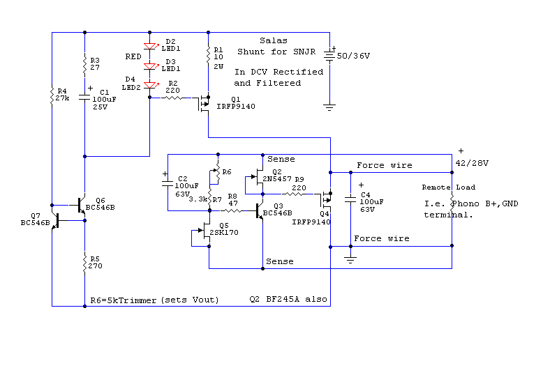

Those layouts are not made for sense wiring. Provided you did hack correctly for the 4 wire connections, your results show sure oscillation. One thing that I would try is to attach force ground output exactly on output capacitor's (-) and not elsewhere. If that does not help, maybe 100pF from collector to base of each rail's BC550/560 could tame the oscillation. Even if that would not work, I would restore the connections to original and forget about converting it.

Maybe I took the schematic too literally. I disconnected the +/0 and 0/ - steering part, coaxed them, + inner wire, 0 shield, - inner wire, 0 shield. + and - to meet force load, shields go apart to star load. So,if the sense shield don't go back, were is it connected to the 0 so the control circuit gets power ?
Salas, the only difference I see is that the shields don't go to star earth but go directly to the load. So is it better to get rid of the star earth, connect shields seperate and directly on the load as possible + connect inputvoltage 0 directly to 0 on the hypno ?
This is better brain training than sudoku 🙂
I'm using a floating earth.
Did you rearrange the sense/force cabling connections also? I know I recommended you the capacitors patch, but if the oscillation is attributed to cabling and can be had clean without patching, the performance can be even better. Remember the sense shield does not return to a common reg's point with force shield. They only meet at load's 0. Force shield only returns to reg's 0, which is also common to its input 0.
It's difficult Salas, The ONO has no star earth or load earth, just one 0 that goes everywere (power 0 = signal 0) I have to improvise. So everything is almost the same, +/0 sense meets force +/0 on the load and force 0 is connected as central as possible were it goes to the output 0 of the Hypno, close to the outputcaps. I also don't understand the difference between star earth an load earth, one for power and one for signal ?
Reg's interest in order that the sense will correct properly, is to ''feel'' the same load nodes that the force cables are connected at. As long as the sense only meet force at both ends load side and does not connect again with force nowhere in the reg itself its OK.
