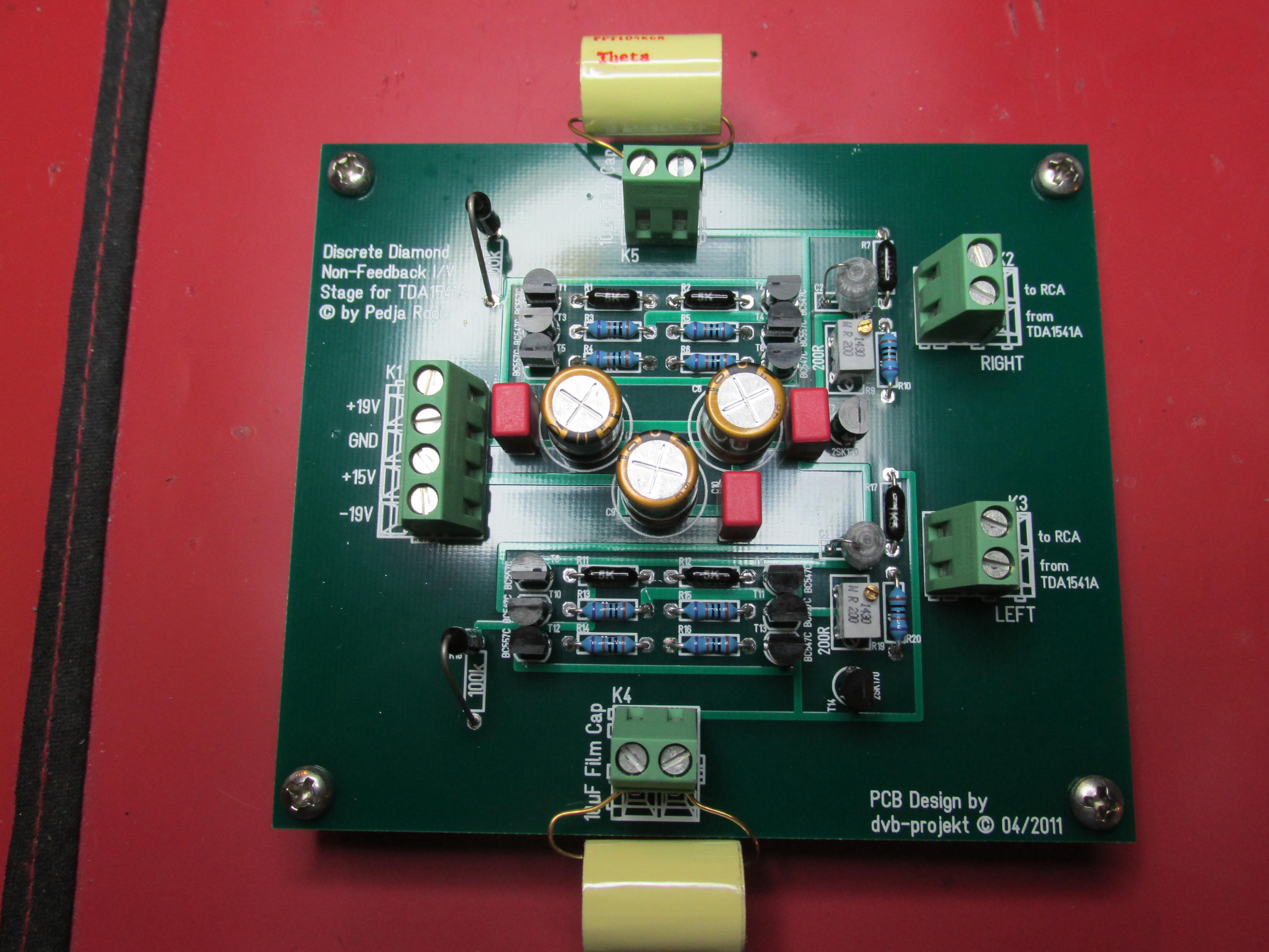

Hi George, Just assembled my first Pedja DDNF discrete circuit board today. I had a small batch of circuit boards made. After adjustment and 30 Minutes burn in I must say I am surprised it beats my other board. The one Oliver dvb projekt built. Have no idea why that is. My opinion is it also easily beats my triple stack AD844. Plan now is to build one for my PCM1704 DAC. I am using a BUF03 behind the DDNF board so I could use the best quality 0.1 uF cap I could find. So it is kind of in the same configuration as the AD844 more or less. I know how you feel about caps in the signal path. :eek: Sadly there is some small variation in DC offset based on local heating at the transistors. Maybe some sort of DC servo could solve that? Anyway I have a few spare boards if anyone is looking for one. :D

How much is it as pictured, I'd like to give it a go if reasonably priced.
Also I'd like to know what dc offset is there without that coupling cap with the PCM1704?

Hi George, Just offering a few blank boards at this time. I don't know how much I have in that one pictured. It was built for the Mark II TDA1541 DAC. PCM1704... I still need to build that version. I can omit the 2SK170 offset nulling scheme on a 1704. I am still pondering if I need to do some matching to keep the offset minimal. Matching for hfe is straight forward. I have 125 BC557C's on order and 100 BC547C's as well. On the M2 1541 DAC I am seeing + and - 30 mV's or so. What troubles me is that it is constantly changing so it might be a case where a DC servo could take care of that. I have about 3 hours run time and I have to say this has dynamic slam and jump factor. Something I find missing on the AD844 triple stack. Although the stack is nice and analog sounding. :) I will need more time to really answer the PCM1704 question.

Maybe that +-30mV fluctuations can be fixed with thermally coupling together pairs of transistors together, either by super gluing the faces together or a common heatsink.
I had this same problem on discrete phono headamps back in the 70's and thermal coupling fixed it.
Cheers George
Hi George, Actually that is a good idea. I will probably have to get creative. Some face each other and others go the other way. I have the top of the cases level so... I could see about bonding a heat sink on top of the transistors. I'd need to make a it slim and could likely bond all left channel together and all right channel together separately. Thanks for the tip. :D

May I ask how the BC547C or BC557C are matched? PNP/NPN matched pair or PNP/PNP (NPN/NPN) matched?
I am investigating that. So far hfe is good for current gain. I think vbe (hope I got that right) likely would be more DC operating points that effect DC offset. I have a lot of reading to do and need to get a transistor test jig built or bought. In general terms the BC557C and BC547C are designed as a working push pull pair. ;)

Might be worth looking at thin strips of copper foil wrapped round the transistors (sa a sort of cap) as heatsinks, with a bit of creativity you could link both banks of transistors across the top as well. It's something I've done in the past.

I plan to build a version for the PCM1704. I think the only criteria is that the DAC has a current output. One would forgo populating the 2SK170 2 mA current source for nulling the TDA1541's output offset. Most modern DAC's I believe have little or no offset. At the moment I will be look at the transistor matching thing and see what I need to do there. Otherwise the I/V resistor for the PCM1704 would likely be 2.5K Ohm or so. I will report my findings with the 1704. :) This might take me some time.

Sorry for the late reply here. The circuit uses a 10 uF coupling cap with a parallel 100K Ohm resistor. So if your preamp input is high enough input impedance you could give it a go. My feeling here is to load it as lightly as possible. I also feel the BUF03 or an OPA627 would likely sound better then a 10 uF capacitor. So I went with 0.1 uF film and foil changed the parallel resistor to 3 M-Ohms. I have some of the old BUF03 Aunt Corey style boards so that made it super easy. I am attaching the schematic PDF for those who can't find it. :)
