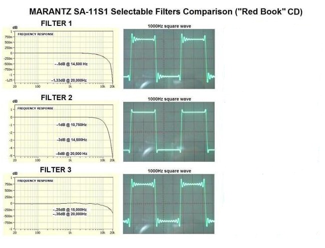

Thanks George, my bad. It's the SA-11S1
The SM11 is the matching power amp, which I also have.
It must have been the previous model Marantz that used the Cirrus chip.
Arty, I found something I had stored on my puter, thought you'd be interested in.
The filter 2 looks the best but it's 5db down at 20k.

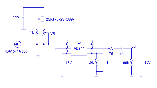

the SK170 or SK369 are not the best choice as current source JFETs, at least not used alone.
They are optimized for low voltage noise figures, which aren´t of that much interest when used as CCS.
Their Gate structure is therefore of large geometry, resulting in increased capacitance figures.
Also their Idss is rather low, meaning that the source degeneration resistors will be rather small in value too, resulting in rather mediocre dynamic impedance.
Matters can be improved by cascoding with a second JFET.
For this special application and voltage and current levels the xx4392 or xx4391 would suffice as cascoding JFETs, as their high Idss and Vgs allow for sufficient Drain-Source voltage over the cascoded device.
To achieve best rejection figures the Vdg should be >2x Vgs(off).
The cascode configuration improves jejection, increases impedance --> current becomes more constant, and keeps the capacitance low.
Alternatively to the cascode teh xx4392 or xx4391 used as single device will be better than the SK170/369.
Their much higher Idss requires source resistors with higher values to degenerate to the required current value.
The impedance and rejection ratio improve, capacitance is lower and very probabely even noise figures may improve (a case where higher resistance can improve noise figures)

Current Source
Hi kp93300, Sorry for the late reply here. You have 2 options on VR1. If you use the BF245A JFET VR1 is 500 Ohms. If you use a 2SK170 JFET use a 200 Ohm trimmer for VR1. I used the 2SK170 version. My understanding is the 2SK170 is more stable over time. I found no issues with using a 2SK170 for a current source. So can't speak to Calvin's comment. The source of this circuit is Pedja Rojic's Aya DAC. At one time he had his schematics posted at his website under DIY. That was some time ago. If you would like me to email you that AYA DAC schematic just send me a PM with an email address and I can send that to you. Adjustment: Here is how you adjust it. You want to place your DMM looking at the input pin of the AD844 (same as the output pin of the 1541A) and ground. The idea is to adjust the input (to the 844) so it is resting at 0 mV's (no signal). The current source is to eliminate the DC offset from the 1541A. Install the nulling circuit at the 844 for output nulling. Hope that helps. 🙂I am using the schematic from the first post for TDA 1541 A.
I am building it on a breadboard
Can someone give me an approximate value of the VR1??
How do you trim VR1 ?
thanks
kp93300
VR1
In hind sight, stick with 500 Ohm trimmer. Depending on the grade of 2SK170, you may need a bit more range. I think I used 2SK170GR's. Beware of fakes out there. Genuine Toshiba is tough to find. 😉
Cheers George
George,
Filter number 2 appears to be a 'short' impulse response linear phase filter featuring minimal pre and post ringing, a relatively slow in-band roll off and consequently poor ultrasonic image rejection. Filter number 3 appears to be a typical 'long' impulse response linear phase filter featuring significant pre and post ringing, a relatively flat in-band amplitude response and good ultrasonic image rejection.
Filter number 1 is the most unusual. It appears to be a combination linear phase-minimum phase filter. The linear phase portion appears to have a 'short' impulse response, while the minimum phase portion appears to have a 'long' impulse response. Thise combination can produce a flat in-band amplitude reponse with good ultrasonic image rejection, minimal pre-ringing and a reduced post ringing.
George,
Yeah those from Marantz just look like different order filters, 1st 2nd 3rd 4th and so on. Always best with 1st if no **** gets through and the audio band isn't chopped into and phase shift is kept low.
That's why the PCM1704 impressed me, at only .5db down at 20khz with 1st order I was only getting a couple of mV of noise/hash at the output, I don't think this is achievable with a TDA1541.
PS: Just found my screen shots http://www.diyaudio.com/forums/digital-source/227677-using-ad844-i-v-8.html#post3338183
