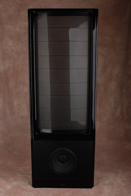

I use a pair of big Martin Logan ESL Monolith III (modified with much better bass drivers, ACI-SV-12's <130hz) bi-amped with a pair big current high (ESL amp up'ed to 30w classA) biased Krell like monoblocks called ME850's, everything is direct coupled from the PCM1704's outputs to the speakers.

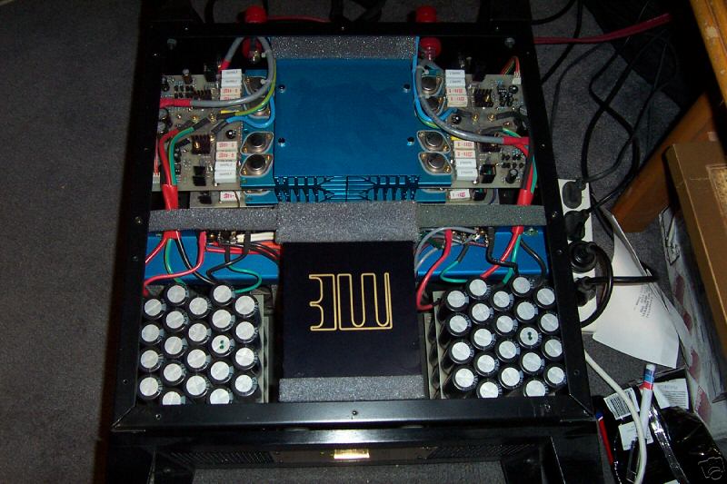

This is what the insides of the amps look like. And the big ME1500

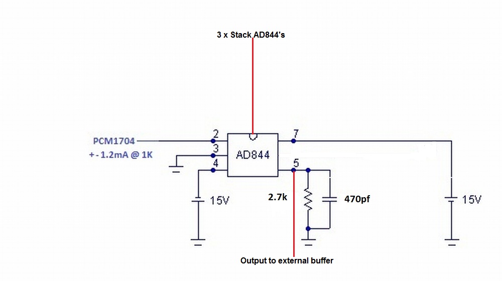

Hi There;
I ve been reading the 100 pages some month ago, and back on it today.
Well any one could point on the "final" schematic for the 3x stacked version ?
I understood that we sum up all the TZ via say 100ohm ish and then go to ground with 1.k5 to 2k7 depending on which gain we need, and putting a 470pf in // in order to get a 125khz roll off.
also understand the best for georges is to have a 627 buffer 1.5x connected across the 2k7 resistor. So at then end the Diamond buffer on pin 6 is not used at all, right ?
also all the input (pin 2) are in paralell and therefore the dac current is spread across the ADs which keep them working in class A.
finally, a trim pot across pin 1 and 8 enables nulling offset.
is that all of it ? anyone made a clean Eagle schematic ?

If not using the 844's buffers. No 100ohms are used anywhere
3 x stack, pins 2 3 4 7 6 together.
Pin 6 (TZ) to 2.7kohm with 470pf across it to ground.
Pin 6 (TZ) to whatever external buffer your using.
Cheers George
Cheers George

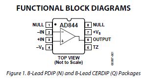

Hi George,
Getting confused here
Is pin 6 o/p or tz?
diag shows pin 5 as TZ and pin 6 as o/p.

What difference did the woofers make on your Martin Logans, and are there any better ones around now. I have the Sequel IIs.
Thanks for the time and effort you and others have put in to this.

Sorry, brainfart, yes pin 5 is the output to an external buffer, and it gets stacked not pin 6.
I'll try to draw something.
The Eminance woofer were rubbish in the Monolith III and the ACI SV12's (bi-amped now) are a very good replacement, I don't know about the Sequels

I improved the bass response of my sequels by adding some internal battens and some matting on the rear, but the room is too small for them really, but I'm not going to let them go!
just made some "dust covers" for them out of some black, stretchy, see through material that I got for £2 a meter at a cloth shop. Makes no difference acoustically but may keep the dust/ c**p off them to some extent.
