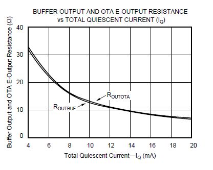

One interesting thing , is that the output impedance from the buffer is equal to the input impedance from the OTA. The quiescent current of the buffer is also regulated.
Thanks Sergio, missed that, E input impedance will be 5ohm the way we want to use it. The wording on the graph threw me, as it's using E as the output.
So obsessed am I, I forget there are other ways to use it. C will be our output and that will be 25kohm output impedance, this is why I think a fet input buffer (like the BUF03) with it's far higher input impedance than the internal buffer will be the better match.

One thing that I don't like in the OPA660, is the output impedance so low, 25k ohms is very low and it probably means that the mirrors inside the chip are very rudimentary.
comparatively, the output impedance of AD844 is 3Mega ohms, a much better value. This is the problem of using chips , to much compromises :) , that's the reason I prefer doing my one discrete circuits .

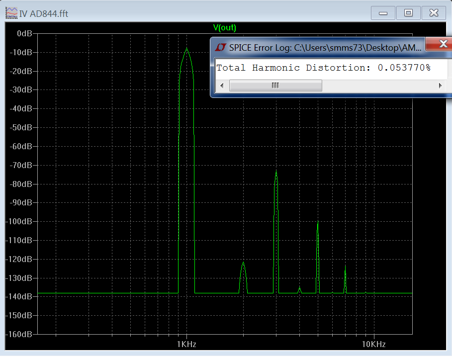

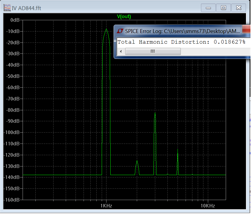

George, the first image is the fft for one ad844 with 0,6mA input simulating a -6dbfs of pcm1704, the second is for the 2 stacked, the 3º image is for 3 ad844 stacked, ofcourse this is only simulations , so ... use with a grain of salt :)
Thank you very much for going to all this trouble Sergio:).
You say "this is only simulations , so ... use with a grain of salt".
But to me it seems that with each consecutive stacking the distortion is around 10db lower for each one added. And this is maybe what we are hearing. .25% thd for 1 stack vs .027% thd for 4 stack
As the gain at TZ is the same regarless of one or four stack, the reduction in distortion to me says maybe it's because of the lowering of input impedance with each one stacked 40-50ohm for 1, and down to 16ohm for 4??>
Your sim network around a single 844 ( #636 ) looks the best with .001% thd, and has the lowest Z in at 5.3ohm, anyone tried it yet???

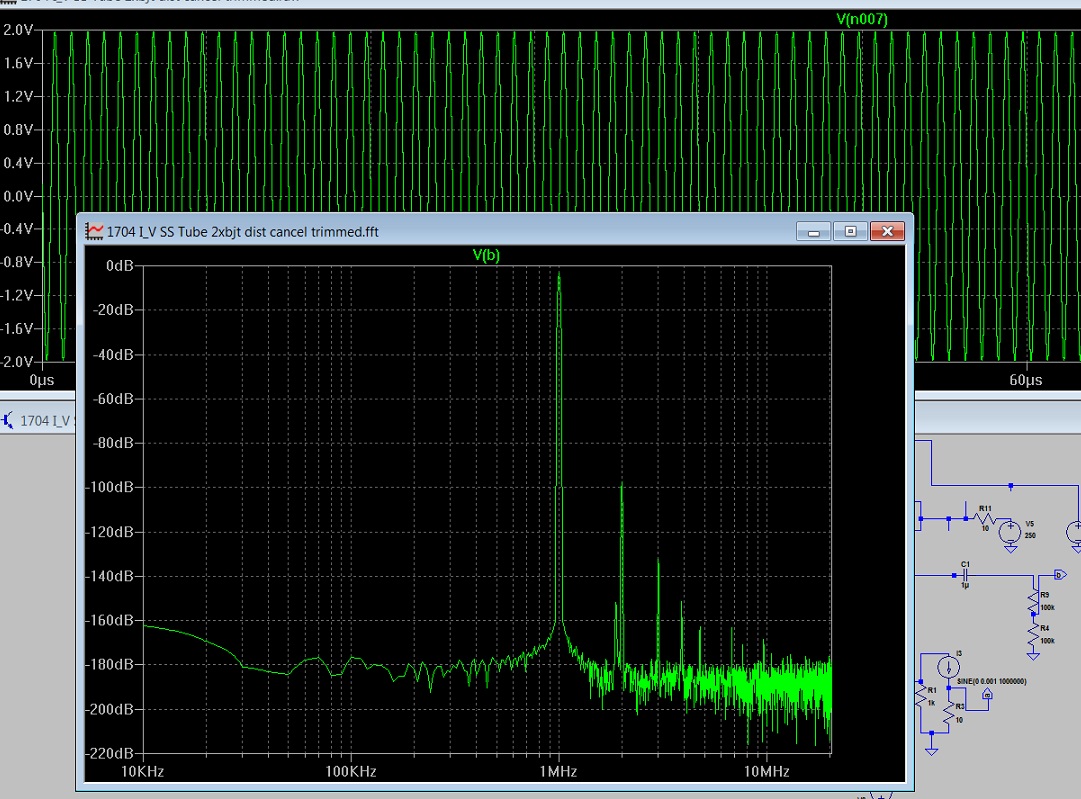

You might get a better approximation if you build the 844 circuit from
discrete transistors so it will take non linear capacitance into account.
As such then check 1kHz and 10kHz.
Once you start stacking, the LF distortion goes down but at some point the
HF distortion will start rising due to higher capacitance of paralleled devices.
Regardless, if it sounds good well stack away.
As I have discussed with George these open loop 844 I-V's, even stacked
are not really ideal open loop circuits and still have many compromises.
Refer below a simulation of my open loop tube / SS hybrid, no local FB,
No CFP connected transistors, quite a simple circuit actually.
This is driven with 1k DAC at +-0.001mA as per 1704. OP voltage is +-2V,
frequency is 20kHz.
Much cleaner spectrum, some 2nd at 0.0003, tiny bit of 3rd and nothing else
to speak of. That's linearity! :)
Even at hundreds of kHz this circuit is still really clean.
For an example of how extreme performance it is capable of I simmed it at
1MHz ref plot 2, 2V pk OP. Yes that is 1MHz :nod:
The sound is very very good but obviously it's more complex to build than
simple 844 having tube related supplies etc.
