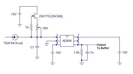

Yes George, the Pedja's circuit should work for pcm1704, but it will have a dc offset at the output , the best is to inject a current in the pin 2 and the same current in pin 5 , the circuit in the image should be better , as there is no offset voltage at the output , R14 can be a trimer, to regulate the output voltage offset . In simulation the input impedance from the AD844 falls to 6 ohms, the distortion is 0.01% mainly 2º harmonic, using this technique the AD844 loses the complementary characteristic.
The sound from this technique should please the tube lovers.
If someone wants to use this , please be carefull as I never try this with a real AD844 , and it can damage the 844 chip , so do not connect the dac chip until you have certain that everything works fine , and the 844 does not overheat. I think that every thing should work o.k. , but until we try we never know.
Serg, thanks for that explaintion, a couple more questions if you don't mind.
With Pedja's circuit which is far simpler, I can trim out any dc offset with the BUF03 buffer dc offset trimer which in the data sheet says is good for +-80mV range. Do you think it will be within trim range with Pedja's circuit insitu.
And on his circuit what do you think is the value of his trimpot is? and how would you say to set this?

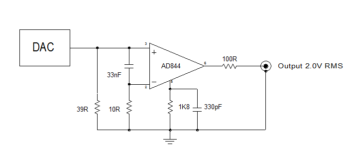

Stacking avert techniques
Hi Guys
I promised George to post this last time we met up on August the 1st, and of course we discussed matters related to AD844's.
I said I would show a couple of techniques that overcomes the need for stacking.
I am not saying not to stack, but simply that the reason for stacking is that in the OTA part (Diamond Transistor) current is so low, almost certainly sub 1mA. Hence, what other shots do we have in our armory? Worth at least looking at.
George feels the input impedance, what is seen by the DAC, is also important to keep low, and indeed the ideal has always be zero Z. But does 0 to 50 Ohm make that much of a difference? I see many using TDA1541A into 33R and then tubes afterward (a la Steve Garland's KillerDAC). They don't complain about the sound. How much does the DAC deteriorate not seeing zero Z? It's a matter of degree. Relative to the high Z of the DAC, it can be argued minimally.
Hera two techniques shown here will reduce the DAC's current to overwhelm that of the OTA part of AD844:
Technique 1.
Zero current induced into the OTA.
The 39R here replicates what is normally seen on "-" input in Pedja's original circuit, which I saw first time about ten years ago.
Now, with this arrangement, then all DAC's current goes to ground via 39R, as "+" input is high Z.
The component values shown are only guides and the caps are filters and may/will vary from DAC to DAC (use one or the other or both, but get their values right as they do affect the sonics). The 1K8 value is adjusted to gives 2.0V RMS output. Any DC offset can be trimmed used by the facility inbuilt in the buffer, by simply adding a 20K trimpot from Pin 1 and Pin 8 and the wiper to Pin 7.
Note, as George told me he does, the output can be taken from Pin 5 (by-pass internal buffer) and then use a separate buffer like BUF03 etc.

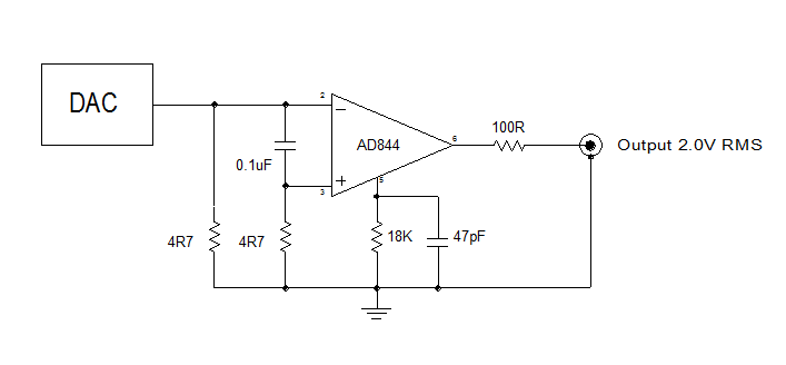

Technique 2.
This one may interest George as it actually makes the DAC see a much lower Z than even stacking could achieve.
The nominal input Z on "-" is 50 Ohm (that may be a max spec or more like 40?). But using a much lower value (about 1/10th) the current gets shunted to ground and very little DAC current ends up upsetting the OTA.
This may well be an equivalent of stacking up to 10 x AD844?
All the other details as far as constructing this, is the same as for Technique 1. That 18K value shown indicates that much higher gain is required, but the AD844 is suitably low noise and can handle it, so adjust 18K to give 2.0V RMS output.
The other alternative: OPA860/861:
If there was a way of increasing the current in the OTA of AD844, then stacking could also have been avoided that way. But there is no such easy option.
Both OPA860 and OPA861 does not need to be stacked, the current can be increased easily.
The OPA860 is replacement for OPA660 (alas the buffer in 860 is not zero feedback - it is a current feedback opamp), the current can be upped via Pin 4, connect a 10R to a negative -5V and give about 12mA idling current. That should suffice for most.
But some may view max operating rails to -/+ 6.5V rails as limiting the max output. Yet with 5V rails it can output 8V p/p and hence 2.0V target is no problem:
So maybe use OPA861 (OTA only) with BUF03 ought to be tried and that was my suggestion to George.
Indeed, for DIY use, I would get close to 6.5V rails (now it should output 11V p/p and more than enough headroom).
Cheers, Joe
