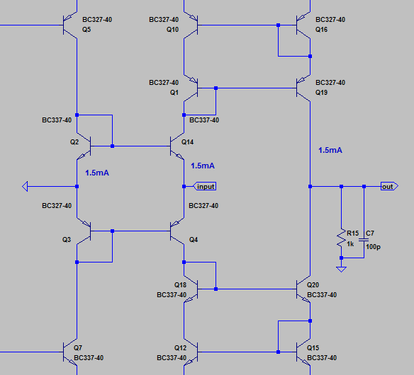

Joe, 12.7ma is the total quiescent current for the entire chip, but the buffer takes 5.8mA and it only remain 6.9ma for the OTA part , so if you divide this by 3, you get 2.3mA, in the simulador I get 1.5ma for 10 ohms of input impedance , but in reality the quiescent current in the input transistors of opa860 can get "maybe" up to 2.3ma.
I hope the picture helps in a better understanding. 🙂

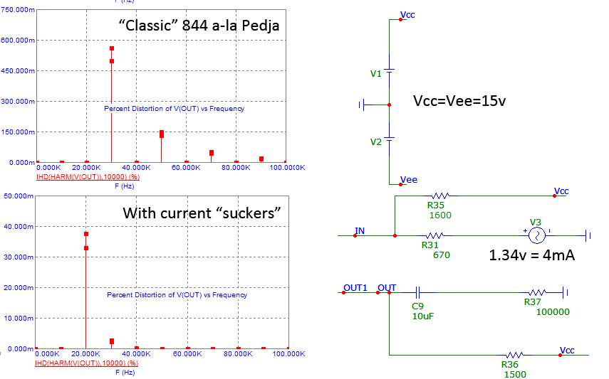

Biasing the 844 into deep class A should do some magic trick. At least in the simulator.
More than 20dB gain in the distortion department by sucking 8mA from input (-) and output (TZ) pins. The output resistor goes to Vcc as well as input resistor. Vcc=15v.
Then you might get some nasty DC offsets... so the cap should come on the input of the following stage, or whatever...
Yet... it might burn the 844 🙂 /*should be simmed with full internal schematics first to see all the transistors stay cool*/

George, I did not measure the quiescent current, I just predict based on information on the datasheets and simulations. So I think that for the 844 the quiescent current at the input transistors may be between 250uA and 500uA, the opa840 between 1.5mA and 2.3mA, When a resistor of low value is connected between pin 1 and -V ,Joe uses 10ohms.
The current mirrors inside the 844 saturate at 10mA , injecting 8mA inside the chip is risky, using 5mA seems safer.
Do you have the full internal schematics?
no i don't... datasheet one should suffice to see the overheating thing, i guess...
Too bad we (huh, at least me) don't know where these TRIM pins go... we need to add some juice into AD's input stage.
My 844 model seems weird. huh... i don't remember whether i have modifiedd it or something...

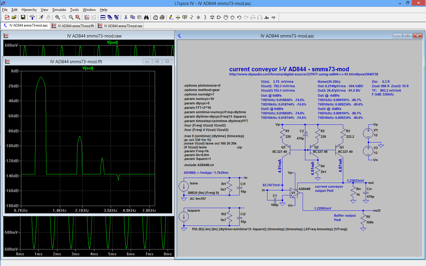

attached is the asc for Sergio´s idea in #610 (Btw: did You rename the AD844 and OPA861 file into .cir and .sub?)
Results:
A input Offset of ~80mV, hardly varying with different biasing currents.
Output offset can be trimmed, but sensitivity to R3´s value is high. Could probabely lead to thermal issues.
THD figures improve only slightly against the triple-AD844 circuit.
Harmonics decrease nicely with roughly -20dB/harmonic.
Noise figures increase considerably, especially the very high value of the buffered output is of concern.
Input impedance drops to ~5Ohms
Figures generally improve a bit with higher emitter resistor values (R1,2: 1k, R3: 1k01, R4: 1k2), but not so much that the mediocre results become good ones.

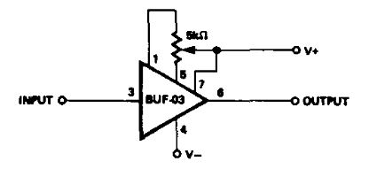

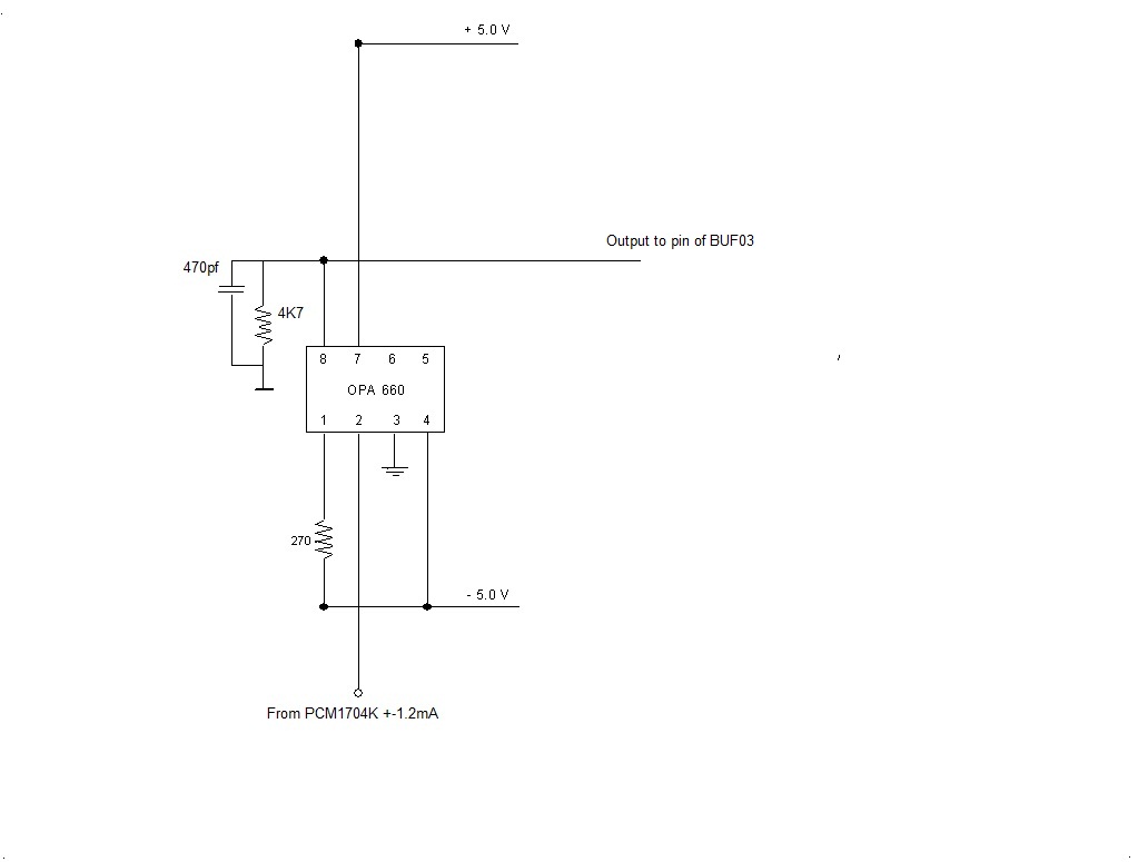

I like the data on the OPA660 the 3000V/us slew rate, and the 850mhz band width, the only thing is what's it's input impedance on pin 2.
I have this idea to use it (attached) as this (without internal buffer) is the way the AD844/s are setup and it/they sounds magnificent with the +-1.2mA output of the PCM1704K and using the BUF03 as the output buffer. All comments welcome.
Cheers George

I have download from ltspice group, the xopamp_c.asy that I needed to run the Calvin file. And take a image for people that dont use the ltspice.
In this image are the fft from my proposal in #610, this simulate the pcm1704 at -6dbfs , as Calvin already said the harmonic distortion is not low, but the main component is 2º harmonic, the decrease in the harmonic distortion resemble the H.D. spectrum of tube circuits.
The Other Calvin simulation.

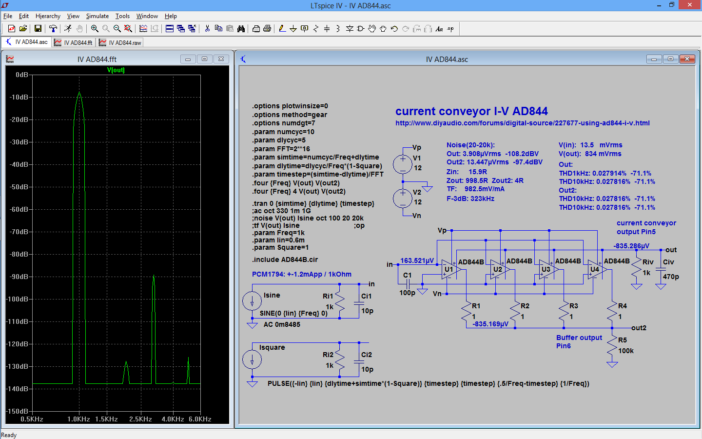

This image are from four AD844 stacked, this simulate the pcm1704 at -6dbfs ,the main component of harmonic distortion is 3º harmonic, the pair harmonics are supressed by the complementar nature of the AD844.
Hi Sergio, why the big difference between the two on V(in)
Cheers George

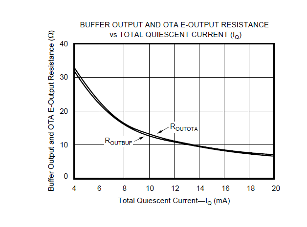

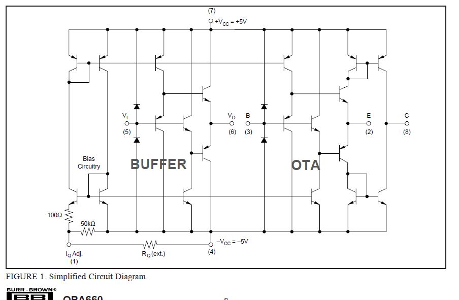

... the only thing is what's it's input impedance on pin 2
The input impedance is 7 ohms at 20ma of quiescent current, at 30ma the input impedance is probably lower than 5 ohms. The buffer of the opa660 is possible a good one also.
The tip from Joe, of using the opa660 is maybe even better than the opa861.
One interesting thing , is that the output impedance from the buffer is equal to the input impedance from the OTA. The quiescent current of the buffer is also regulated.
