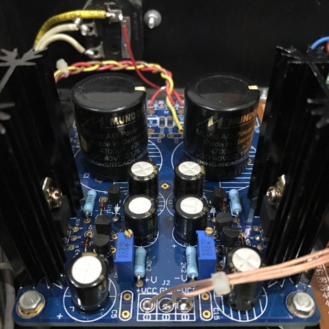

I use two Kubota dual discrete regulators for the ad844 + buffer and the tda1541a + wm8804 receiver. The ad844 share the supply with the jfet buffer. This is much better than lm317 and lm337. I also find lt108x sound worse than lm317 if dropped into the place of lm317.
I have used several low noise regulator chips for other dacs lt3080, lt1963, lt1763 and lt3040 (the last one made by diyinhk, very impressive spec). They are quite good compared to lm317/337. But I found the kubota regulator to sound subjectively very good.

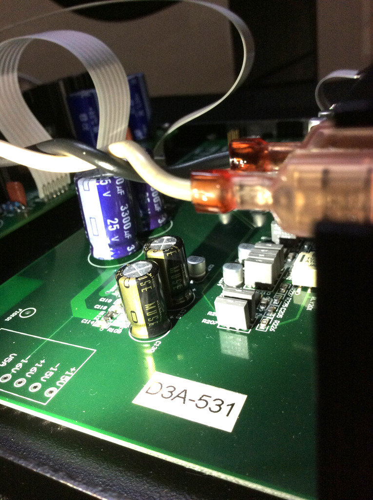

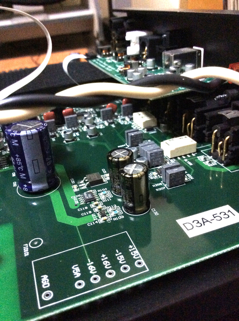

This is a pic of the regulators used for belcanto DAC3 output buffer. I can see that they use nichicon muse kz after the regulator chip (I can see LT1763 for positive rail). You should try this cap here. The sound is very organic. If you look at other parts inside the belcalto dac you can see the designer is very serious about part selection.
I have replaced the muse kz on the supply pin of tda1541 chip with blackgate. The sound is brighter with black gate and nicer tone but not a huge difference compared to nichicon muse kz (in a power supply position)
I usually find that using film cap in parallel with high quality electrolytic degrade the sound compare to just using the good electrolytic only.

This dac is not mine, it's the stock condition. It uses caddock 132 through out the analoge stage including i/v the filter and output buffer. It uses LT1468 opamps. The dac chip is BB pcm1792
I have used Pan FC in some other DAC before and found them neutral sounding. Muse KZ is slightly warmer. All black gate caps have special sonic character. I am using black gate N as output cap for my tda1541 dac.
