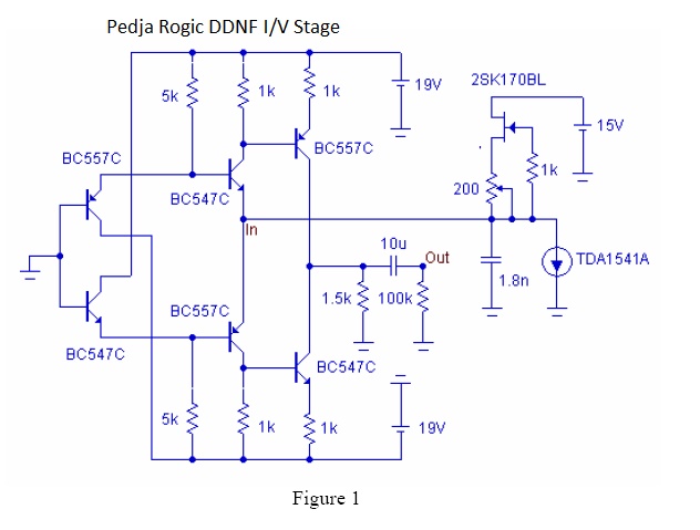

Hi George, There is a point on the DDNF that is an I/V resistor and there is a capacitor. I do utilize a single pole or first order filter there. It isn't enough in my system. So the passive filter is needed. I now use the transformer as 1:1. Ringing... I did some experiments. If you do not properly load the transformer then ringing is the usual outcome. Properly loaded it presents a stable load. Gain may change that. Sonic signature... I find it more transparent then the usual active filter. The Sallen-key... Yuck!
In this DDNF diagram the "TZ" resistor is 1.5kohm if you have a 1000pf across it it will give you a LP at -3db at 106khz, there is also the HP filter (10uf 100kohm -3db .1hz) after it. Which the LP with the PCM1704 filters the noise down to a few uV which is very low, unless the DDNF is noiser than a tripple stack 844. Then there's no need for the additional stage (the colouration of a output transformer) and your buffer would be a better output driver than it as well as it's lower output impedance.
An unbalanced connection between DAC and pre/amp introduces colouration too because of common-mode noise, using a transformer avoids that. I prefer the colouration of a trafo to that of an unbalanced connection. I know I'm far from alone in having that preference.

No. It is the 4n7 capacitor across the primary that makes it a second order filter. That coupled with it's natural roll off at higher frequencies. Phase shift... I'd guess less then a Sallen-Key filter as that has a lot of shift depending on frequency just by the nature of it's design.
PCM1704 is a current output DAC, its not rated for any power at all. But I suppose it could put out a few mW. This transformer has a primary inductance of 0.5H minimum which means its needing to operate in a low impedance circuit. Probably you'd need an I/V resistor below 50ohms.

4n7 across primary sounds more like a 1st order filter in conjunction with I/V resistance. If you move the cap to the secondary that'll become 2nd order, in conjunction with the leakage inductance.
Well... The I/V has a first order filter. Then a Buffer. Then the transformer so actually it is down stream from the I/V. The transformer based filter is from a DIY Audio Forums thread. On the secondary there is a Zoebel. As recommended by Lundahl. 🙂
I looked at Eldam's datasheet, no mention of leakage inductance. I could make an estimate though based on what the bandwidth is stated as (100kHz, -1dB) with the load at 10kohm. It won't be very accurate because 100kHz looks too round a figure to me....
I get about 8mH based on LTSpice simulation.

That is a hard specification to find. Best way is likely with an oscilloscope and test generator. The 4n7 on the primary had to be changed to 3n3 with the LL1690, so not a hard and fast rule. Makes sense to experiment on the secondary side as well taking cable length into consideration. 8 mH is likely close enough as a start. I will be taking a short break from DIY due to another round of surgery. PM me if someone needs a response from me. 🙁 Probably won't be on here for a few weeks. 😱
