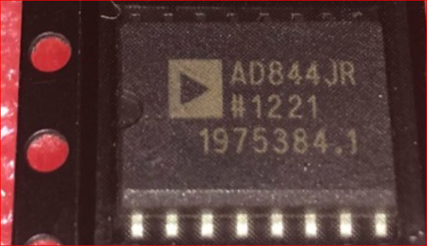

SOIC AD844-JR
Do these look OK? Its unlikely anyone would change printing on SOIC's only worth a buck each.

The SOIC legs are a bit fiddly and short so stacking will need help e.g.using a ribbon cable with matching pitch - 40c worth
The SOIC's are only half the height of the DIP-8 and are so affordable they are just asking for a 10 stack per side to allow direct TZ pin output free of an extra buffer stage as per batteryman's inspiration. :D
Rather you than me soldering ribbon cable to 1.27mm pitch pins!
Alternatively you could solder each one to a soic to dil adaptor, then stack these. Much easier as some 1mm dia Cu wire can be run through all 10 holes in a vertical stack, and only for the 5 holes that needed linking.
Also, the current requirement of the stack is over 100ma so its better if the power pins were fed from a central point and not via a daisy chain of 1/2 pitch ribbon cable.
Thats smart. Thanks for your help.
