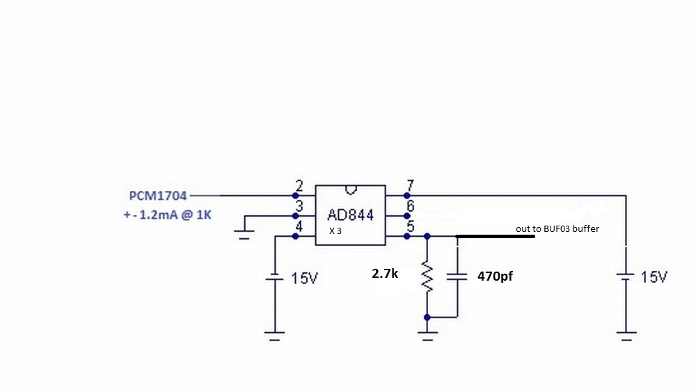

Quick couple of questions on the 2019 status of this amazingly interesting thread:
Are the newest designs still using a JFET current source circuit on the input? Is this necessary if the output is capacitively coupled? Would modern, in-stock JFETs like the MMBF4393 or 2SK3666 be appropriate since 2SK170s are somewhat expensive at this point?
If one were to forego the OPA627, would a BUF634 be acceptable for a TZ-output arrangement since BUF03's are now also very expensive? I know it's bipolar, but the datasheet says 80Mohm input impedance or 8Mohm in high-BW mode. 80M in parallel with 1.5kohm shouldn't cause much of an issue, right?
I fear the 844's output buffer might not be able to drive much capacitance, especially the ~100pF/m of some RCA cables and that could be causing some of the sound quality issues seen here using pin 6 directly.
Forget the AD844's own buffer it's not very good sounding. Come off the 844's pin5 to your own buffer, I found a "genuine" OPA627 to be exemplary, make sure it's genuine by getting it from an authorized TI distributor, as there are many fakes of these.
Forget the BUF03 in the pic that's the first one I tried, too dirty sounding great bass though.
Cheers George

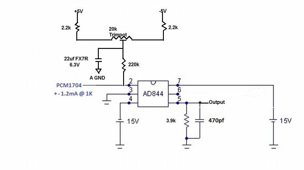

George,
Are we still using the input bias current source? I noticed your recent schematics (including the one you just posted) don't have one.
With the above 844 using pin 5 and the OPA627 and small amount dc offset can be trimmed out using the OPA627's offset adjustment.
But if you have a large amount of dc offset coming from the dac thewn you need to use this setup to trim it out.
Cheers George
