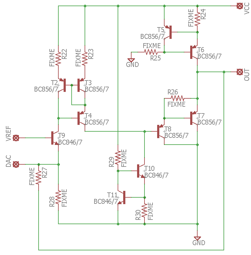

I have built a few instances of a classA CFB circuit, I'll see if I can find the schematic.
Thanks go to Matt Garman who drew up this schematic based on my scribbled drawing. I haven't put in the resistor values as some of them will be dependent on which DAC you decide to connect it to. Happy to work them out for anyone who decides to go ahead and build this.
Its a current-feedback amp and the I/V resistor is R27. You can choose whatever output voltage you need by fixing this resistor appropriately.
As drawn its fairly basic and suffers from some DC instability which could be fixed by addition of an opamp servo. Not that I've tried it as I've been happy on my DACs to use capacitor coupling of the output.

As with you I've experienced way too much noise increase after an I/V resistor to get anywhere near a 2v output, because of the amount of gain needed, and the sound suffered because of it. Can't beat a good low input impedance active I/V that why stacking the 844 to x3 gives around 10ohm input impedance which current output dacs love to see, without a noise penalty.

Hi George, I did some snooping and there is mild hum on the high gain setting on the headphone amp with volume at max. It is quite acceptable although I may be able to reduce it once it is installed in a chassis. Thing to remember is this would be well below CD redbook at greater than 96 db down. At this level playing music would blow your ears out on headphones. The 25 Ohm resistor has a signal of 0-8 mA's, as the DAC's are in parallel. So has roughly the same signal as a single 1541 on a 47 Ohm I/V resistor. :2c:

Well the math goes something like this. We know the resistance is 25 Ohms (I/V resistor) and the maximum current for a parallel connected TDA1541A is 0-8 mA's. 0-4 mA's times 2. So the math says maximum voltage across the 25 Ohm resistor is 0.2 Volts. So if the SRPP stage has a gain of 10X. We are at 2.0 Volts. Don't know if we can say that is RMS. Although my guess is that it is. Having played with the parallel dac concept... I came to the following conclusion. It is better to sum the currents then to run the dac's through their own respective I/V's and then to just add them at the buffer as two voltages. It works to sum them at the buffer however all that happens is averaging. There is no gain to doing that otherwise. If I missed something here please let me know. :devily: Trouble is I never found a active device that liked having 0-8 mA's injected into them in a standard I/V configuration. So the reason for the resistor I/V and SRPP.
I think the standard i/v resistor according to datasheet is 1k8. If you you 2 chips in prallel then 900 ohm would give the same voltage. If you divide 900 by 25 the required gain is about 36 times.
With active i/v, I believ one chip is better than parallel. There are many i/v stages that can accommodate 4mA incuding the one we discuss in this thread. With triple stacked ad844s and one tda1541 I got excellent dynamic sound.
Parallel chips is useful for passive i/v though.
