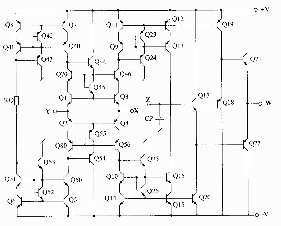

I'm wondering if that has come about by talk of how it sim'ed the data sheet simple schematic.
Here is a more complete schematic of the AD844 maybe someone could give that a go, with and without stacking. And notice there is already a TZ cap, wonder what value it is.
Cheers George
AD 844 - current conveyor - CFOPA

George, Has the designer of the chip ever commented on the current limitations on the die? Just curious. I suspect that the current is so limited to keep the die temperatures down. The discrete circuit schematic looks interesting. I hope someone makes the build attempt. Not something I can take on at this time. Not with surgery in 3 weeks and being on a walker again after that for another 4-5 weeks. Man I hate surgery....
No he didn't, but then he never intended for it to be used the way we are with no NBF and the signal taken from TZ.
The more complete circuit will be interesting if someone sim's it, I got lost using that program, no patients.
Cheers George
