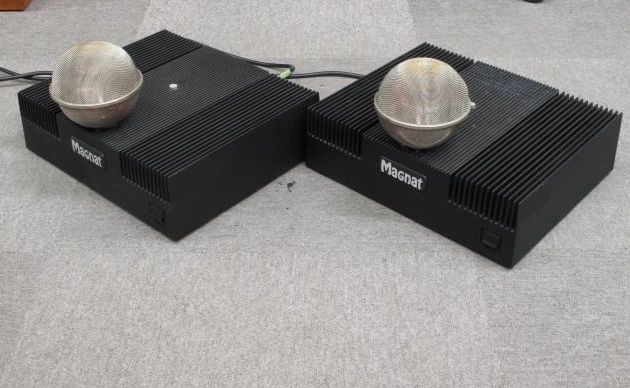

Of course that comes into it as well.
I've gear'd my system (below) to be as neutral as possible, and these are my findings of the 627, as it is also well documented that a real 627's sound a little on side of dark/warm not neutral or bright, and I wouldn't want for it to be any warmer.
2 x MP-02 Plasma tweeter 10khz up
ML esl Monolith's (latest aluminium deposited panels) 10khz-130hz
Bass unit heavily moded with ACI SV12's 130hz down -3db at 25hz
18db Passive xover to esl panels at 130hz to 10khz
my own 24db active xovers to the bass
2 x massive BJT massive (attached) one very highly biased (50w) into Class A for the esl's and plasma's.

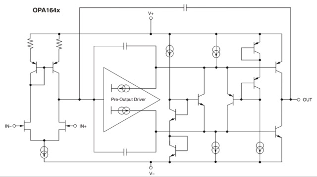

Sounds great. Just ordered 2 for listening. Currently, I am quite satisfied with LT1468, but still looking for some good JFET alternatives.
According to TI, opa1611 beats opa1641 when source impedance is lower than 2.5k ohm. Above that the opa1641 wins over.
This is interesting to consider the i/v resistor from pin 5 of ad844 to ground. In my case (tda1541a) it is 1k5.
