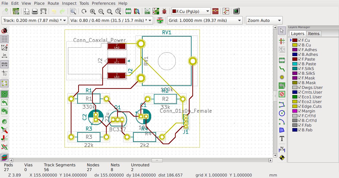

Since, I am almost ready making the first PCB, I am posting the files for evaluation and assessment.

JMFahey said:Please "print" it or "export image" or show screen capture so it can display in the Forum window as a graphic image, otherwise you force us to install Kicad just to see it.

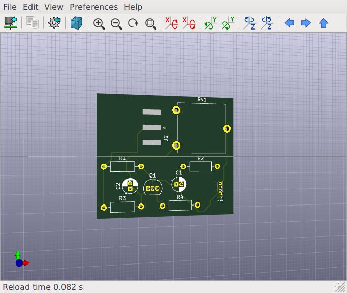

Here are three screenshots: (circuit diagram, PCB in the designer, PCB in the 3D viewer)
Step by step we are getting closer.
Maaaayyyybeeee "connection error" warnings come from tracks reaching pads, but not being actually connected to them.
Zoom in suspect connections and check.
Some design packages are "polite" and once a track touches any part of a pad, "they are connected", others are very fussy and unless pad center and track end have exact same coordinates, with zero tolerance for differences, "they are not connected"
And even if, sometimes tracks can be disconnected from pads, for the purpose of rerouting them or connecting elsewhere, my point being that even "seeing" a track reach a pad, it does not mean they are vreally connected, hence zoom in and check.
Not sure it happens in Kicad which I don´t use, but hey, checking doesn´t hurt.
In some packages, you can click track and pad and ask to "join" or "connect".
PS: at some point increase track width to a more sensible value, I suggest 40 mil or 1 mm.

I tried to reconnect the "bad" connections following the advice from JMFahey although I was already aware. Since, the problem did not resolve itself, I think, the best thing is to remove the connectors and use vias instead. Vias allow wires to be soldered allowing a circuit to be built. At this point, my opinion is to continue instead of trying to solve this issue which might be caused by a bug or by something not properly set up in the footprint itself.
I will continue to do more exercises to improve my ability using KiCad.

Finally, I am almost ready! I resolved the "no connection" error of J2. The idiot in me, did not realise it was as simple as using the 3D viewer to look carefully at connections. J2, for some weird reason unknown to me, created 5 pads, 3 on one side and 2 on the other. So, connecting the obvious pads always resulted into two unconnected pads.

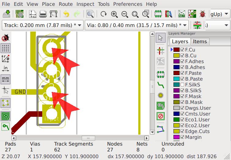

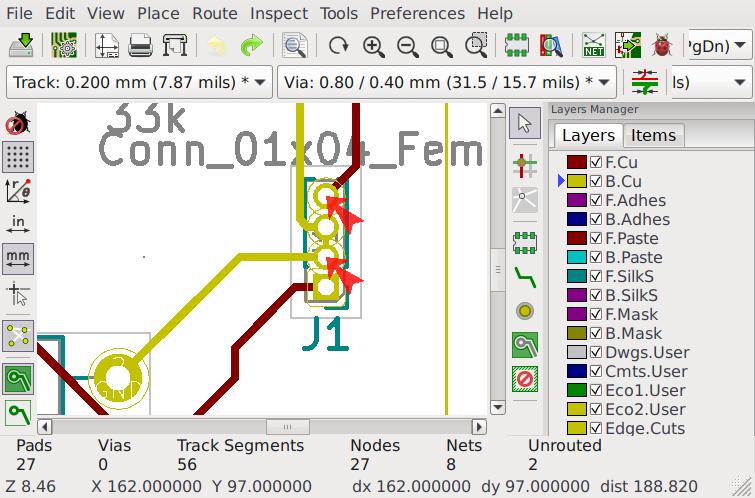

To be truly ready, I need to block two Marker errors. I read there is a way to configure how, but I cannot find how and google seems to assume anything apart from what I mean it to search for. I am posting the marker errors for help to ignore these errors as what is actually overlapping are pad courtyards. Connectors are notorious for having crammed pins with crammed pads.

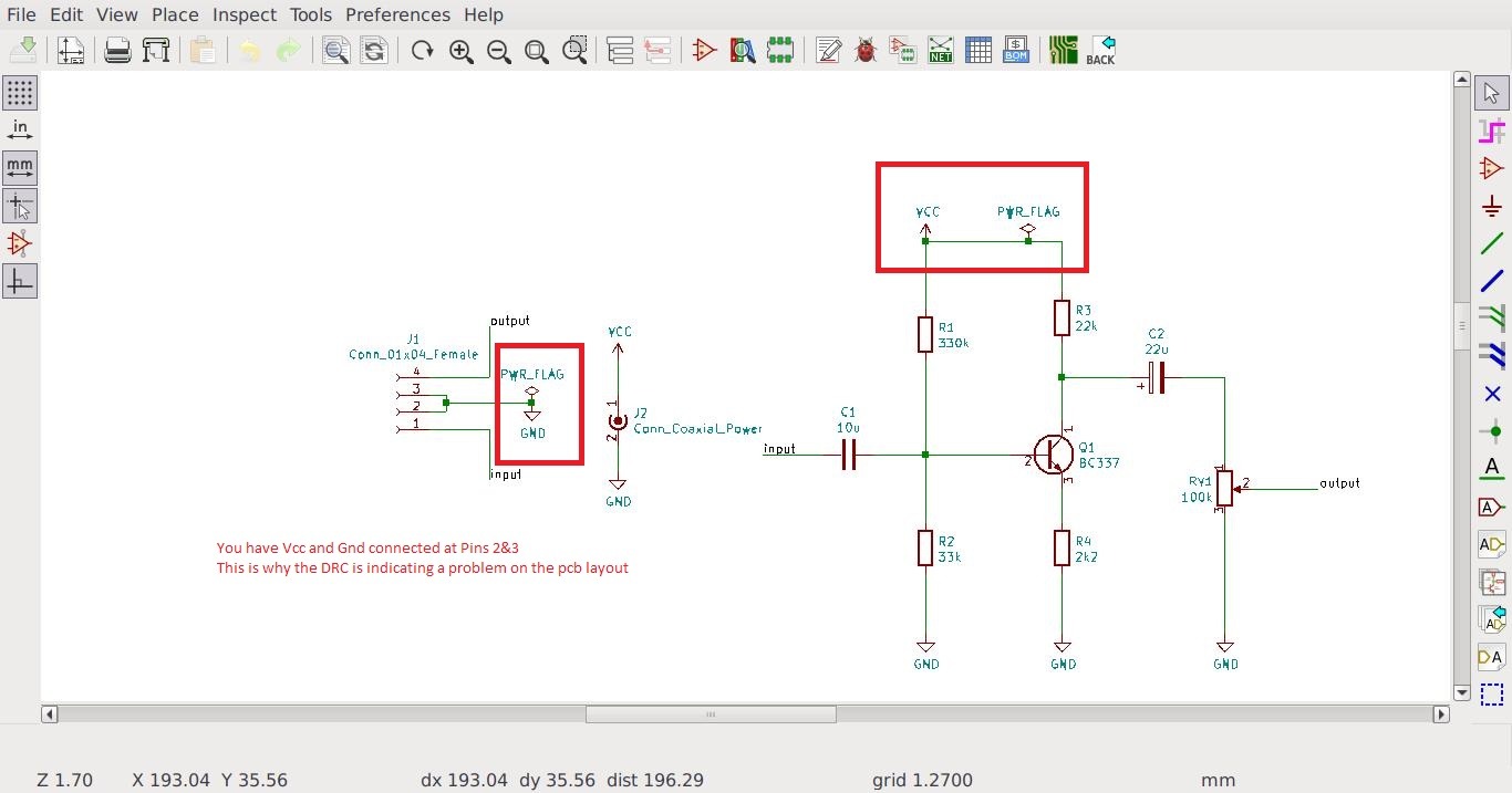

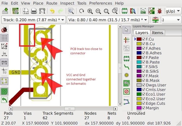

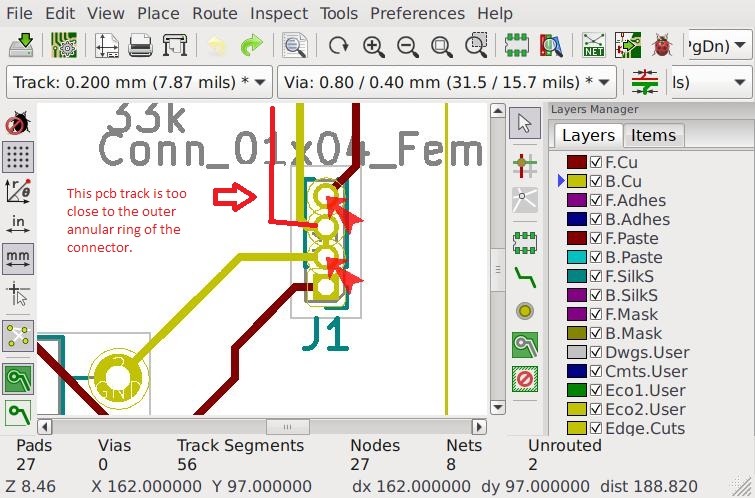

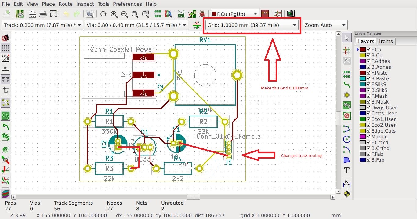

I think the DRC is indicating the pcb track to the left is too close to the annular ring of the connector, so its flagging it as a clearance issue.
The other error seems to stem from the schematic where Vcc is connected to Gnd via pins 2&3 of the connector J1.
See attached images.
Don't block these errors because in any case the pcb board manufacturer will run their own checks via the gerbers so the errors will get flagged anyway.

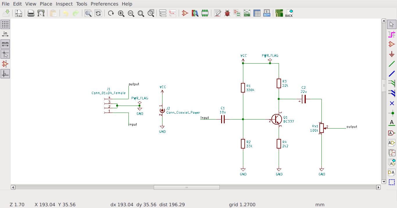

PWR_FLAG is a special purpose marker which tells KiCad a track is either power ground or a power rail. In the schematic there are no shorts, in fact, KiCad did not report any shorts of that type. The track almost touching the connector's pads should not be an issue, as KiCad's automatic track router passes tracks that way. Nevertheless, thanks for all those who took some of their time to help.
The solution seems to be to change the default net class's clearance to 0.15mm. Online it was suggested to use 0.199mm, but that, did not work, neither did 0.18mm. I had to go down to 0.15mm for the new setting to eliminate the error.

The problem is the PWR_FLAG is connected to Gnd at connector J1, so your power supply is shorted to ground, thats why DRC is flagging an error.
I gave an example in post #30 in how to run the pcb track to the connector to solve the clearance issues. For this type of pcb layout where you have plenty of space you don't need such small clearances, you should be able to use 0.25mm without any trouble. You don't have a clearance problem, it's a track routing layout problem.
Don't use the automatic track router, do it manually.............
PWR_FLAG behaves differently compared with other net lables. It only tells KiCad that a power track is driven. A power track can either be ground or a supply rail. You can confirm by searching in images.google.com using the keywords PWR_FLAG +"KiCad". There are several images showing PWR_FLAG being used on both power rails and ground.
Why are you using an automatic router?
Terrible choice, doubly so if you are trying to learn.
I imagined something of the kind when I saw your ultra narrow zigzagging tracks, and as close as possible to existing pads, where there was A TON of free space available.
+ 1000For this type of pcb layout where you have plenty of space you don't need such small clearances, you should be able to use 0.25mm without any trouble. You don't have a clearance problem, it's a track routing layout problem.
PS: Pilot Students do NOT use an Autopilot 😉
