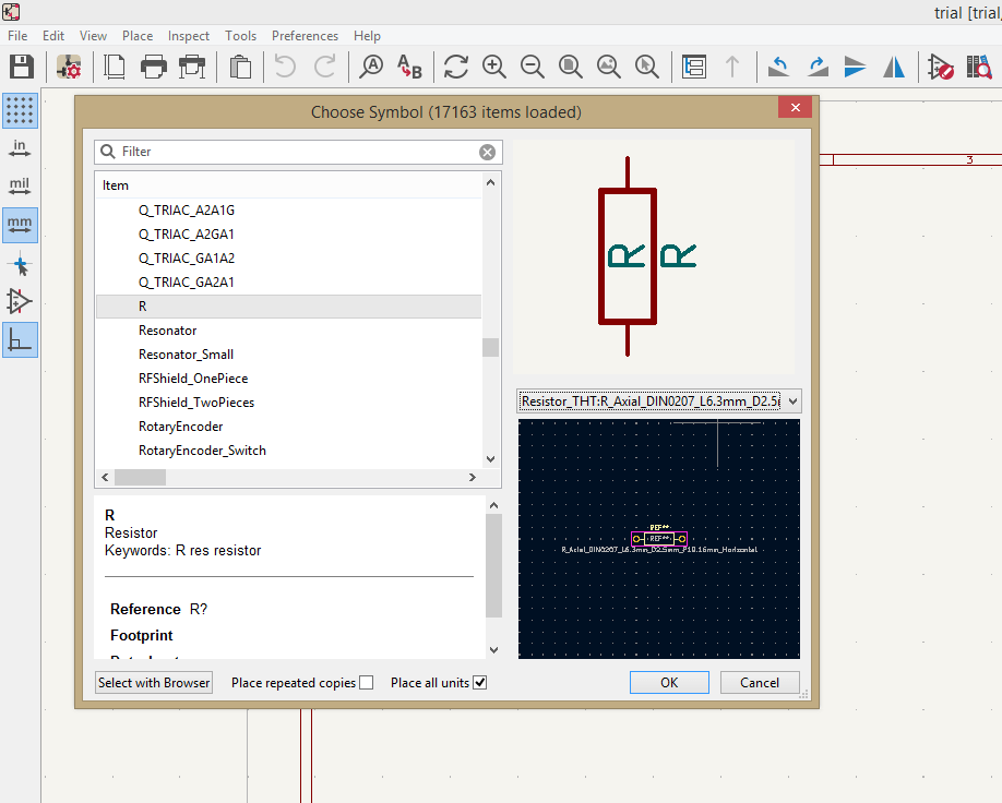

I am trying to update PCB from schematic but I am receiving errors that footprint libraries are not found. The errors are the following:
The following is the version information:
Code:
Info: Processing component “R3:/627FF10F:Resistors_THT:R_Axial_DIN0414_L11.9mm_D4.5mm_P15.24mm_Horizontal”.
Add C1 (footprint “Capacitors_THT:CP_Axial_L18.0mm_D8.0mm_P25.00mm_Horizontal”).
Add R1 (footprint “Resistors_THT:R_Axial_DIN0414_L11.9mm_D4.5mm_P15.24mm_Horizontal”).
Add R2 (footprint “Resistors_THT:R_Axial_DIN0414_L11.9mm_D4.5mm_P15.24mm_Horizontal”).
Add R3 (footprint “Resistors_THT:R_Axial_DIN0414_L11.9mm_D4.5mm_P15.24mm_Horizontal”).
Error: Cannot add Q1 (footprint “Package_TO_SOT_THT:TO-92_Inline” not found).
Total warnings: 0, errors: 1.
Error: Errors occurred during the netlist update. Unless you fix them your board will not be consistent with the schematics.

Have you created your own library but Kicad can't find the file path to your library to find the footprint ?
To check the library paths either globally or per project, from the toolbar goto > preferences > Manage Footprint libraries.
I clicked preferences > Manage Footprint Libraries but I still do not know what I should do. Checking online for the page represented by ${KIGITHUB}, I found, it does not list any footprints, implying the URL for ${KIGITHUB} is incorrect. This is my inexpert conclusion, but as all the rest of the 7 billion human beings, I can be wrong.

Did you upgrade from Version 4 to Version 5 or was it a clean install ? There appears to be some changes to the library configurations.
Some info for Linux users - I installed KiCad 5 but there are no libraries. (The default option for sym lib table setup is disabled)

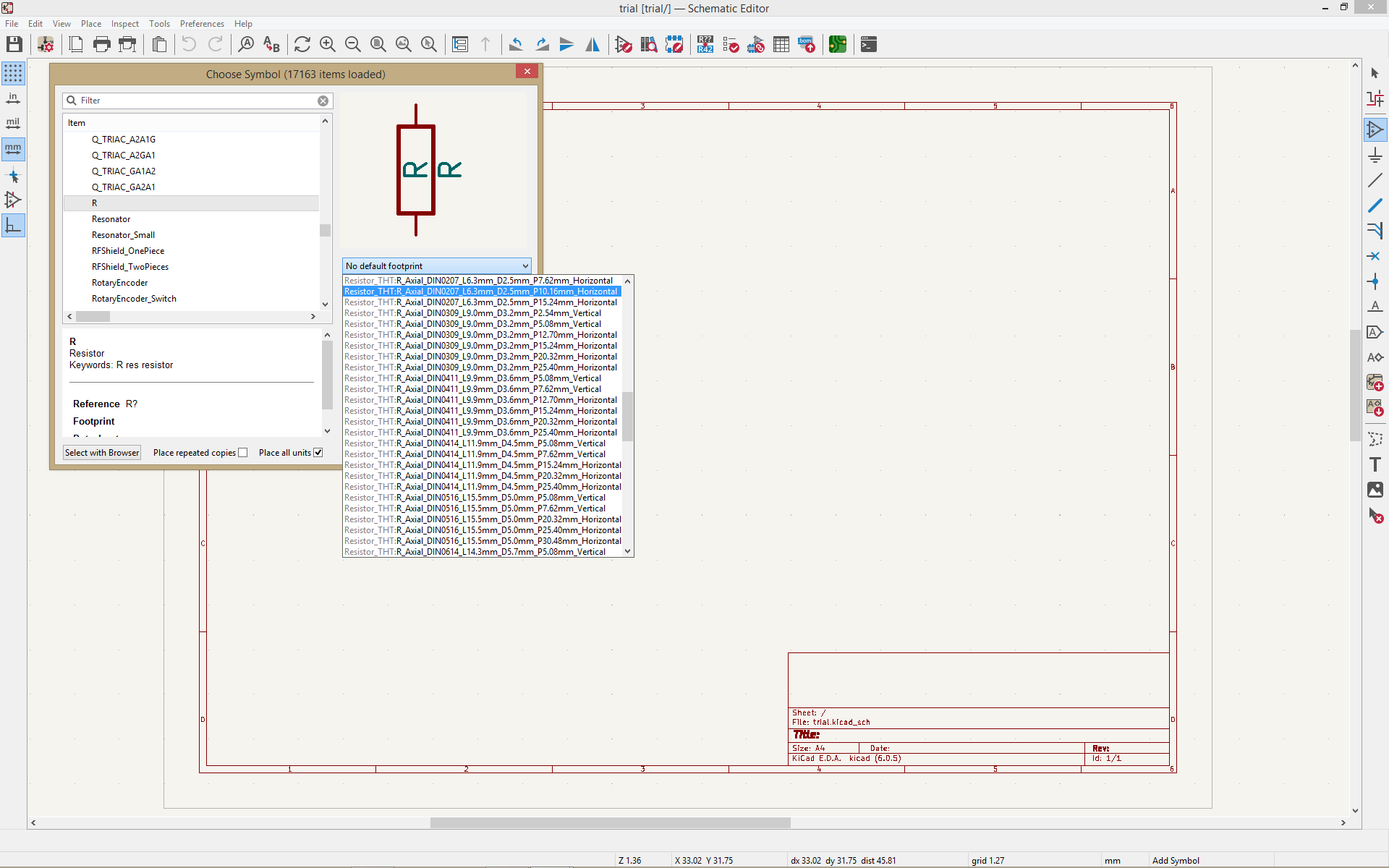

Place ==> Add symbol ==> then click on "no default footprint" and make a choiceI am trying to update PCB from schematic but I am receiving errors that footprint libraries are not found. The errors are the following:
The hurdle of unfound footprints has been overcome and now I have PCB New showing a bunch of components with straight lines joining them. However, this is far from a ready designed PCB! What am I supposed to do with these components, and is there a way to tell PC New to automatically create a PCB, so that, I would only need to edit where necessary?

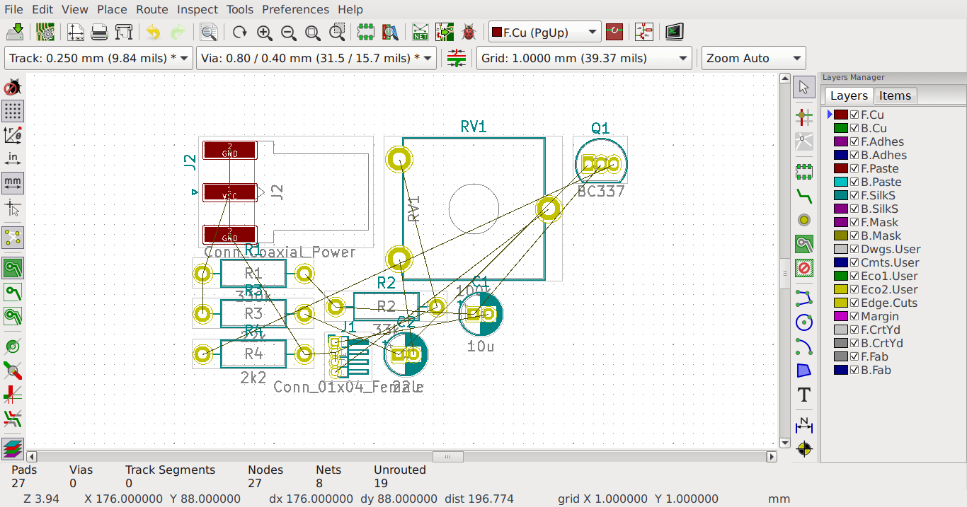

Now comes the fun part, I guess you just have bunch of components on a black background with white lines connecting them all together.
First you'll need to define the physical pcb outline otherwise the board will have infinite dimensions. On the right side you'll see a bunch of layers, find the one labelled "Edge Cuts" make sure it's ticked then "select" this layer (indicated by blue arrow) and then select the icon with the "4 dots and purple lines" (add graphic lines) and then draw the shape of your pcb board. To make it easier to connect the lines together use a 1mm grid setting.
Done!
Now, I have all components framed in a rectangular enclosure. Reading a tutorial I am now supposed to move the components where I need them. Could you please, give me some more instructions about how I am supposed to accomplish this?
Okay, Just click on a component and it should be highlighted, now you can move the component anywhere on the pcb by holding the mouse button down, be mindful that you can also select just a pad of a component if you need to see the properties.
You can also click a component, then right click your mouse and this will bring up another menu, for example to rotate the component.
At this point you may want to define the board setup (Design Rules), so you can have multiple predefined pcb track sizes, via sizes and clearances. Otherwise you'll have limited options at this stage. These design rules are not global and are set on every specific pcb project.
In PCBnew goto > File > Board Setup

I have all tracks showing as simple very thin straight lines. How can these lines be made to look like real PCB tracks?
I have no idea about windows, I am Mac. KiCad supply many OS friendly systems, have a look and they even write different editions for oddball OS's; https://www.kicad.org/download/
Edit their width ( right click). I think you might read Help file or tutorial first, because you will have tens of similar questions before making your first PCB. Try to do the job yourself, help file is powerful.I have all tracks showing as simple very thin straight lines. How can these lines be made to look like real PCB tracks?
Sounds like they are still the rats nest lines, not traces.I have all tracks showing as simple very thin straight lines. How can these lines be made to look like real PCB tracks?

Those thin white lines connecting pads and components are as mentioned above "ratsnest lines" or in plain English showing connections as in from>to , of course a VERY important help.
They are not tracks yet, so no width, even no layer assigned, go figure.
YOU will replace them by tracks, you choose width (I´m old style and still think in "mils", thousandths of an inch , which for decades has been the measurement standard for PCBs, not too happy at all with newfangled mm units, go figure). a common "starting" value is 40 mil , or 1 mm.
You use wider to carry higher current or lower in tight spaces, but that´s a good starting size.
So basic generic track laying procedure is conceptually straightforward, suppose you have 2 resistors, R1 and R2 in series.
You will have a thin white line going from one pin/leg/pad in R1 yo one in R2.
Now you choose a track width, a layer /typically the "solder"/bottom one" click on said pin on R1, move your mouse cursor to needed pin on R2 (both connected pins are shown by the white line) and click there.
Now you will have a track connecting R1 to R2 and that white line will disappear.
Go open a champagne bottle to celebrate, you have just laid your first track. 🙂
Easy, huh?
TOO easy?
Well, yes and no.
For a single track, yes.
Although you still need to tidy things up.
If you literally followed the white line, chances are track was laid at any random angle; to avoid future clashes we lay it using vertical and horizontal segments as needed.
As easy as laying, say, a horizontal segment >click (it fixes that point), vertical > click and so on zigzagging until you reach destination.
Now in a real design, tracks will quickly run into each other, so you will have to "solve the maze" and search for alternate paths.
And NOW you are designing a real PCB
