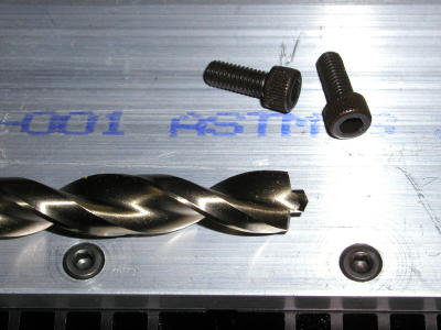

There was a question how I do recessed holes for hex screws.
I use Pilot Point, Twist Drills from DeWalt or from Black&Decker sold under "Bullet" name and available from Home Depot. Those are my favourite drill bits.
For screw head hole size I choose a drill bit next size up and measure the pilot size. I drill a pilot hole first. Then choose the slowest speed on my drill press (which for that purpose is necassary) and drill the big hole for the screw head (adjust the deph of the hole first). Than I drill through the final hole for the screw with a regular bit (because the pilot is smaller than screw size).

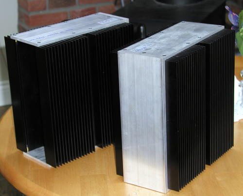

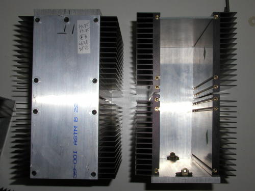

Even easier is to use heat sinks as part of a chassis and mount top and bottom plate directly to the heat sinks as I did here. No brackets required. It doesn't always look good cosmetically but I did it this way here because heat sinks had threaded holes already. Very easy and fast way to build a chassis, 4 plates, 2 heat sinks (or four in my case) and 18 screws. Back panel is mounted through the grooves in heat sink, so no screws were required, front panel uses only 2 screws. That's what I call good engineering.😉

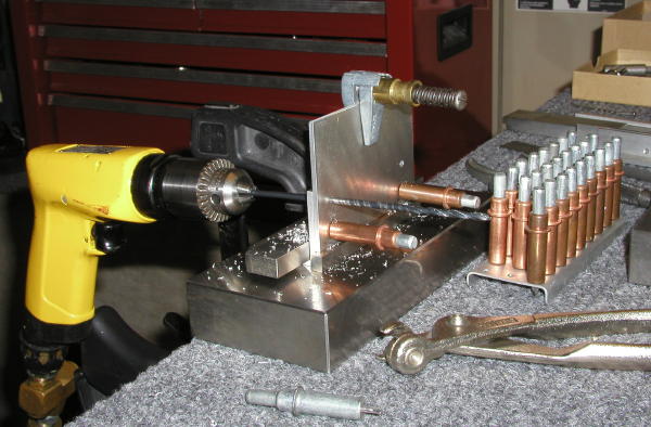

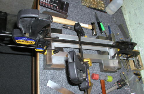

Building a chassis an aircraft style
Some people were complaining about countless screws they had to put in when building their amps.😉 Today I decided to use some of my aircraft tools and try riveting.
Clecos were used to hold the parts together while drilling. After holes were open with size 40 drill bit and then size 30, I countersunk the holes for flush head rivets with piloted countersink.

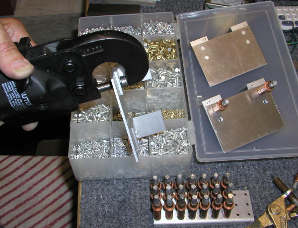

After deburring the holes I used a squeeze gun to install the rivets. It was actually the first time that I tried that technique at home, but I must say that I like the results and I will do it more often😉 For anybody interested in obtaining some of the tools I used here, http://www.yardstore.com/ offers good selection and prices on used aircraft tools an accessories.
