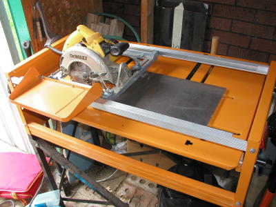

For anything that doesn't fit my mitre saw I'm using that setup. I bought that table long time ago at Canadian Tire and although desined for wood cutting it works great with metals. I'm using 7.5" circular saw which can slide above the table. I clamp aluminum pieces to the table. I was cutting 1" thick aluminum pieces as well as 2" thick heat sinks without a problem. When a piece is thicker I do two or three runs to complete the cut. Don't forget about the safety glasses.😎

Cutting Blade

Don't you have to worry about the heat that might get generated on the saw blade when cutting/drilling metal. When I was a little kid I saw my father at his work place that he used some milky white liquid dripping onto the stock metal and the cutter blade, what do you call those very very hard pointing bar that scrap the metal away thin layer by thin layer. I recall he said the milky liquid is for cooling. Those machine were big though he said the motor on it was like 5 HP and the thing is like 10 feet long. The key he used to turn the jaw clamp was like the size of the cross bar to change flat tires.

I'm not worried about heat because my average cut doesn't last longer than 10 seconds.

Cutting emulsion
Chris,
you ask about that milky fluid. It is cutting emulsion, a mixture form a special oil and water, ratio 1:5 to 1:15. It is meant for cooling and greasing the cutting tool as well as for preventing the cooling agent making the machine's metal corrode.
The cutting edges you adress are bars made from sintered tungsten carbide, then brazed into place and finally ground to shape. The edge shape for wood cutting purposes is considerably different to shapes for metal cutting. Metal cutting blades usually have alternating shapes, every one roof-shaped and every other rectangular.
Also the type of tungsten carbide is a different one for wood and for metal, due to different requirements for stiffness and brittleness/elasticity

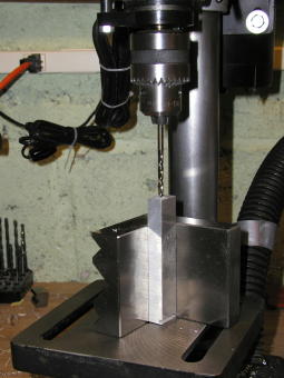

Here is a simple way to drill straight holes at the end of a rod or similar part. No vice needed and if you lubricate the drill bit you don't even have to clamp the part to the block but simply hold it with your hand. I'm using stainless still block but you can easily make it out of wood. That's what I call simple, fast and precise.😉

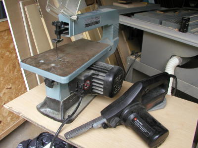

There was a question how to cut square holes for AC jack and switch. I found the switch that has the same width as AC jack and I put it directly above the jack so I have to open just one square hole. Since most of my panels are usually 1/4" doing it by hand would be pretty hard. I used many different methods before, but found out that those 2 tools are most handy for the job. To start the hole I drill 1/4" holes in ea. corner of the square. Final trim is done by hand and a file.

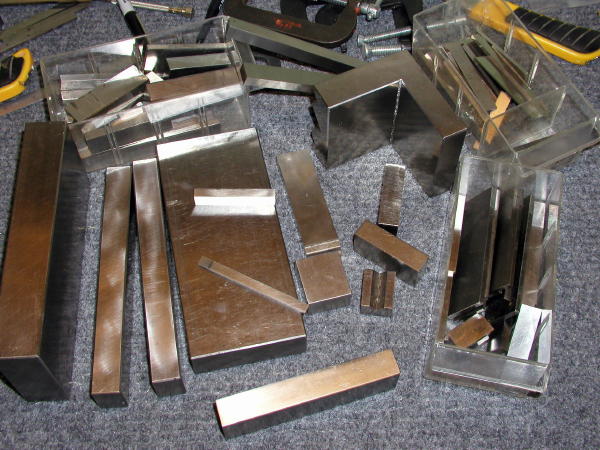

Apart from using clamps for aligning metal pieces I find those stainless steel bars very handy. I don't know where one might find them, I got them from my friend who works as a tool and die maker. The small ones are good for setting spacing between parts. Some of them are also good for achieving proper angles.

I'm glad to hear that for aligning, you also drill one piece first and then then clamp it and then drill through to the other piece. It's so time consuming but so far, I have been quite successful in almost getting it to line up properly.
By the way, which one in the picture is Quick Grip (say, counting clockwise)? I have been using a 3" grip with a strong spring in the middle from Home Depot.
Oh, the bars ... those are good suggestions! Thanks!

It is time consuming but I found it to be the best way to make it accurate. Quick Grip is the biggest one with yellow jaws. Beside it, is the smaller one which looks similar in type. It also says "Quick-Grip" on a body (always read small print)😉
