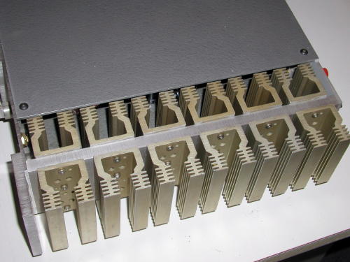

So how come you didn't make your own heat sinks?😉

There are several methods you can use, I like to lightly sand blast my heasinks after machining. For flat panels the best method is soap, water and a brillo pad, always push in striaght lines and in one direction only. I have attached a photo showing a project where I used both methods of finishing.
Regards
Anthony

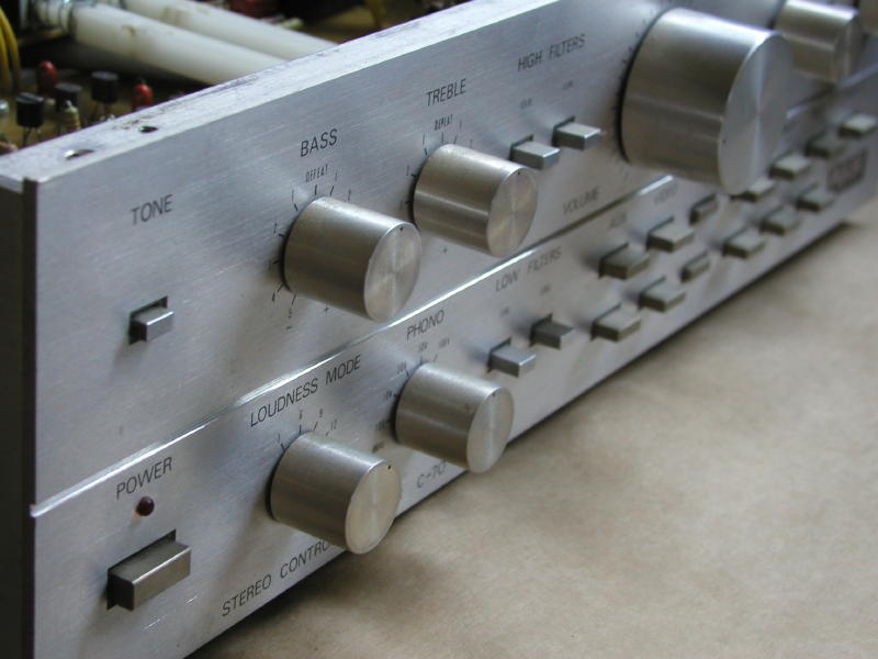

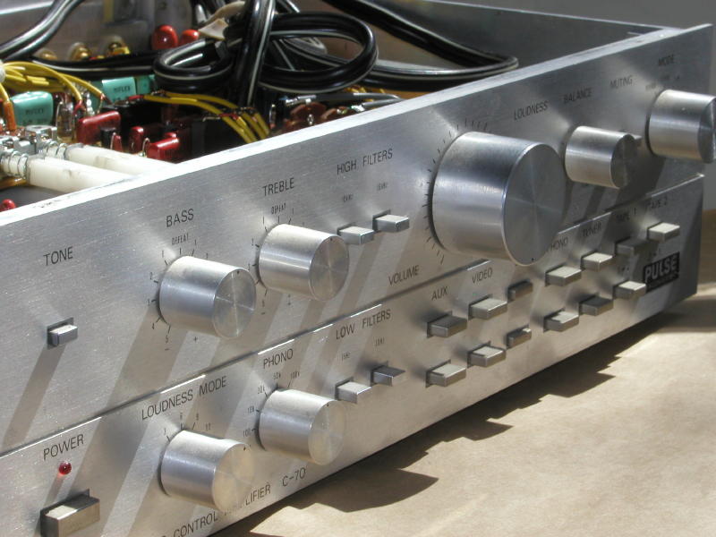

This is a closeup of a preamp panel I made in early '80s. There was no protection done to aluminum surface of any kind and after extensive use you don't see any wear after all those years. I finished it simply by using fine grade waterproof sandpaper (between 200 to 400, depending on your likening). If you do it wet the surface will become matte, when do it dry it will have a shine. Just use a piece of wood to move your panel along it's edge, so the brushed lines are perfectly straight. After that clean it with hot water. Dry immediately because water might leave spots. That's my memries of making the panel then.
Today I'm using 6" belt sander. I simply sand the panels on it, using WD40 as a lubricant and 150 grid paper. One might use different lubricant but since it's working for me I didn't bother to look for anything else.😉 After that I clean the panel with Varsol and give it a final look with Scotch Brite.
To see more pics of the preamp see: http://www.diyaudio.com/forums/showthread.php?s=&postid=43046#post43046

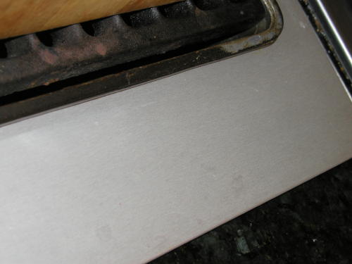

In my panel I used 320 sandpaper without water or soap.
I didn't use a ruller so the lines were a bit on the curve side, but I think is ok for the first job.
after I lackered it with semi gloss and finished with car polish
here is a pic
