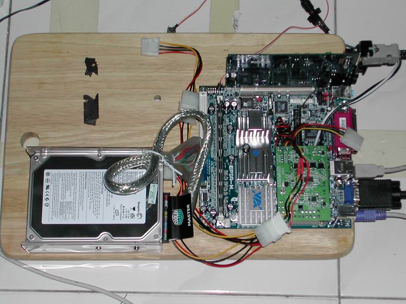

Recent update on Audio PC
OK, I have just received the majority of my Audio PC parts. Spent the last few days on assembly & loading the software.
The Hardware :
1) VIA Mini-itx EPIA Me-6000 fanless motherboard
2) 512MB PC2700 DDR RAM
3) 160GB Seagate HDD
4) RME sound card
5) 7" touchscreen
6)100W DC-DC power convertor & outboard brick power supply
The setup above is nowhere near a powerful a the temporary setup as reviewed earlier. However, there is no difference in its performance & tasks / mission. The comments I had earlier is reconfirmed again using this setup. The added advantage of this setup is that there is no fan noise. However, the seagate HDD is not as quiet as it should be. I am in the process of purchasing a silencing enclosure for it though.
Area for improvement
1) Add Word Clock Module & Apogee Big Ben clock conditioner to minimise artifacts of jitter
2) change to linear power supply as per suggestion by my fellow forum member
3) design & construct a good chassis / housing
More review upcoming when improvement 1 is done
Joe Ling
