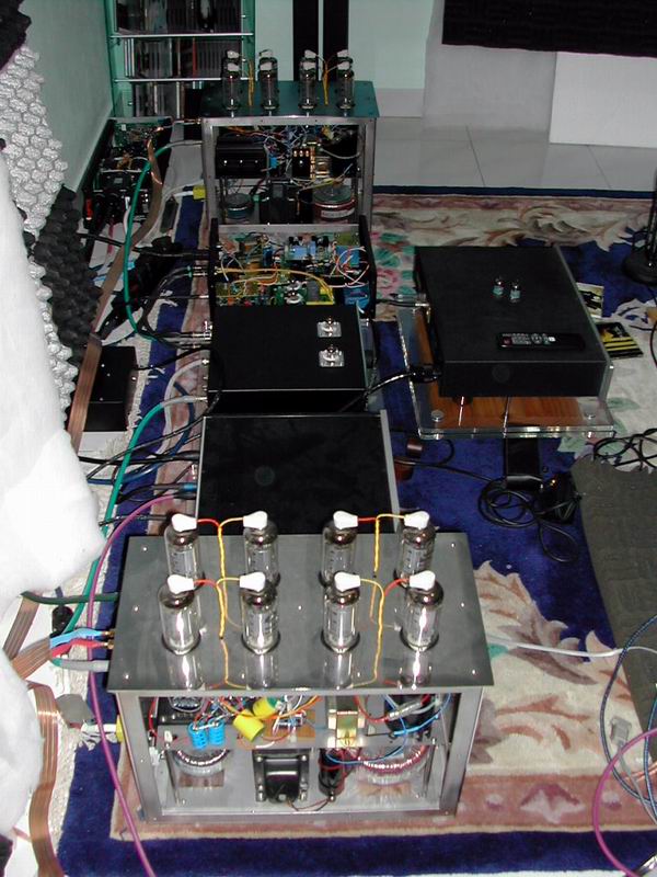

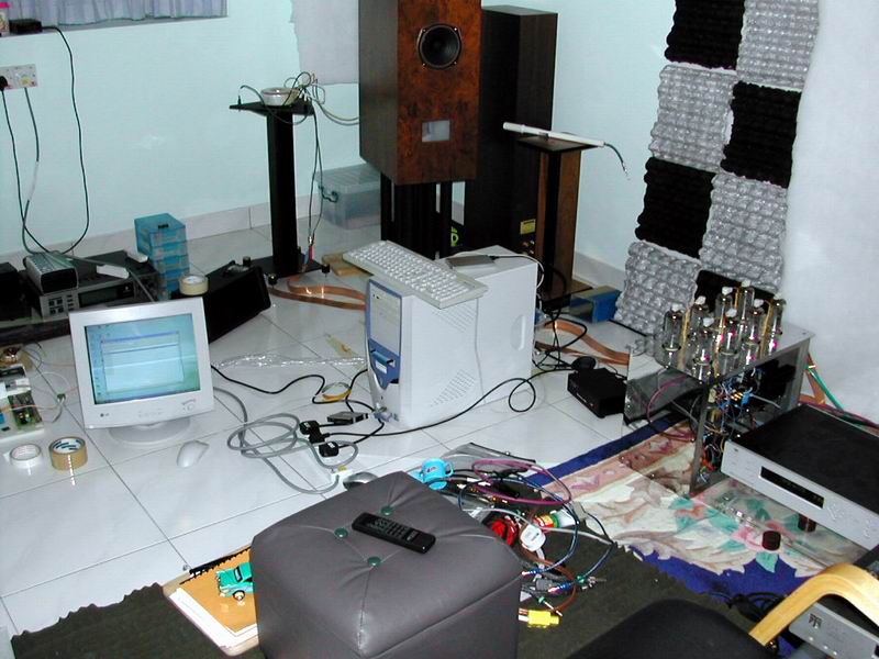

I have just done a brief listening comparison between my reference transport & a hastilly asembled audio PC. I am impressed by the PC ! It is quite an experience.
History :
My system consists of mostly DIY equipment -
1) source - Theta Pearl with trichord III clock
2) TACT RCS 2.0 - bought second hand
3) DAC - heavily modified AN dac 1.1
4) DIY linestage based on Allen Wright's FVP
5) DIY OTL based on Transcendant sound T8
6) DIY speaker based around Mitsubishi Diatone 610

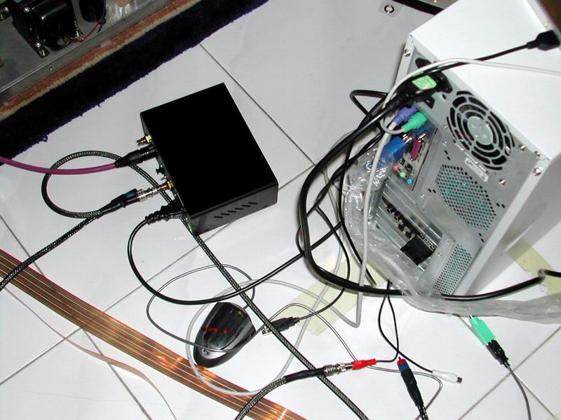

PC setup :
Hardware-
1) Asus MB with 512MB RAM
2) RME DIGI8/96 PAD sound card
3) Seagate barracuda 80GB HDD X 2
4) Monarchy DIP classic

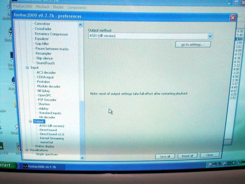

Software-
1) Windows XP pro
2) Foobar with asio output
3) EAC for ripping cd to uncompressed WAV
The evaluation
This started last night. Installed Foobar & tried to use the kernel streaming feature. This resulted in no sound. Can't figure out why & instead switched to either wave out or direct sound for comparison. The sound was muted & felt as if someone has put a blanket over the speakers (best that I can describe). I tried both output of wave out & direct sound. There was not much difference. Compared to my reference, my rig sounded airy, fast & sweet. Decided to call it a night .
Tonight, tried the same thing as above & still same result. Then, as a last ditch effort, I decided to try the ASIO out by installing the asio plugin for Foobar. Took me a few tries before I managed to get the configuration to work. The digital output of the sound card is fed to the Monarchy then to the digital input of the TACT. I switch between the CDT & PC using the TACT remote (TACT has 6 digital inputs) while playing the same songs (from HDD on PC & orginal CD in the CDT). The sound level did not require any matching as they were near identical. Quite a revelation. I was not expecting this at all !
Track 1 : Cai Qin (Singer from Taiwan - Ji Yu (Coincidental meeting) - audiophile disk played in many Asian Hi fi shows
I played track 6 & was struck by the ability of the PC to match the airy presentation when compare to the CDT. There is a very slight edge the CDT has over the PC though.
Track 2 : Jennifer Warnes - The Hunter - track 8 (Way Down Deep)
This track is distinguished by the bass (60 ~ 70 hz). The PC has an edge in this deaprtment.
Track 3 : Michelle Branch - Hotel Paper - Track 14 (the game of love)
pop/rock. Not much difference at all
Another track that was used for comparison was Heather Nova's Siren track 4 (what a feeling). Again, perception of heavier bass by the PC.
Tomorrow night, I will test the soundstage & other things that I can think of. Anyway, it has been quite enlightening. I was all set to banish the PC to my study to serve as a juke box after last night.
I feel the PC can be improved further. My mini-itx parts are still in transit. Let's see what happens when I get my hands on that.
