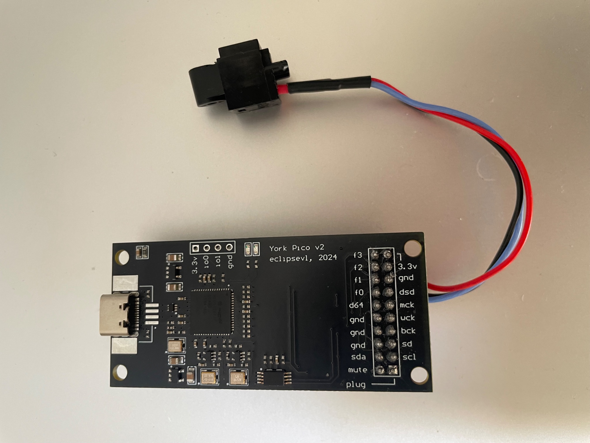

JL Sounds I2SoverUSB is probably the preferred solution for now. Best if powered from two isolated clean linear 5v power supplies. Better yet if also supplied with external ultra-low close-in phase-noise clocking, and then by reclocking the SPDIF and or I2S outputs. For I2S signals, a fair amount of discussion exists in other threads: https://www.diyaudio.com/community/threads/general-purpose-dac-clock-board.413001/ and: https://www.diyaudio.com/community/...2soverusb-pcm2dsd-rtz-dac.423401/post-7917601

Can you name a suitable ultra-low close-in phase-noise clocking board that would fit in the same case as the JL Sounds?JL Sounds I2SoverUSB is probably the preferred solution for now. Best if powered from two isolated clean linear 5v power supplies. Better yet if also supplied with external ultra-low close-in phase-noise clocking.....
There is Cestrian's board with Iancanada SC Pure clocks... The reviews if its used with a good dac are exceptional. Best dac most people have ever heard.
You might want to patch the 3.3v LVCMOS SPDIF signal from I2SoverUSB through one of the reclocking flip flops. Could be you would need to tweak the timing a little, so a 100MHz or better, 2-channel or better, scope is strongly recommended (actually its strongly recommended for any kind of dac work).
I can now provide the Gerbers and information to build an interface board that supports a compact connection between JLSounds I2SoverUSB vIII FIO and PCM2DSD with support circuitry hosting 2 x XOs, relays to switch in the correct frequency, re-clocking for the DSD signals and a clock doubler to provide ext_clk to the JLSounds if 22/24Mhz XOs are used.
