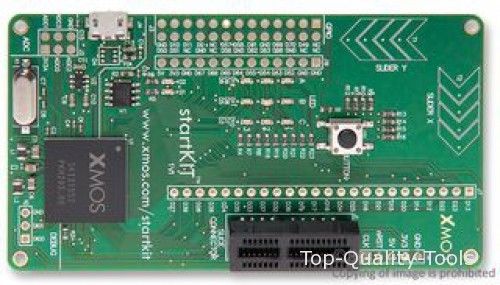

found this DEV Board here very simple
any opinion?

@Nosian,
Are PC drivers included with these dev boards? Or is it necessary to get a license from Thesycon for this?
@kuribo
There is of course the USBStreamer from miniDSP.
With a suitable interface it can be isolated and get very low jitter.
The Evaluation Driver is available as a free download from xmos.com for evaluation and prototyping purposes only and will work with all XMOS Reference Designs and Development Kits. 🙂
Note that the Evaluation Driver provides all the features of the Thesycon Driver but will generate a short beep tone every 5 minutes after 60 minutes of operation. 😱
