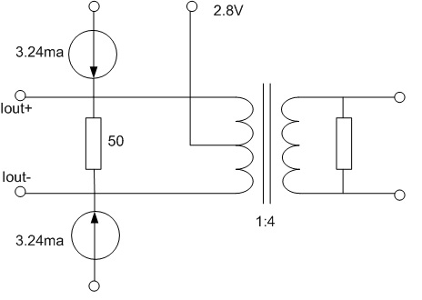

Can we run AD1955 passive like this to be compliant with the datasheet? With 2K load, there should be about 400mv RMS at output.

I have tested many configurations with AD1955 and output transformers but always I get bad results (http://www.ti.com/lit/an/slaa399/slaa399.pdf).
To get a flat frequency response and low distortion the best method is a pure resistor followed by a high impedance stage like a vacuum tube.
The 200 ohm value has been found after many test from 47 to 2Kohm.
I should receive soon the first pcb of my hybrid output stage.

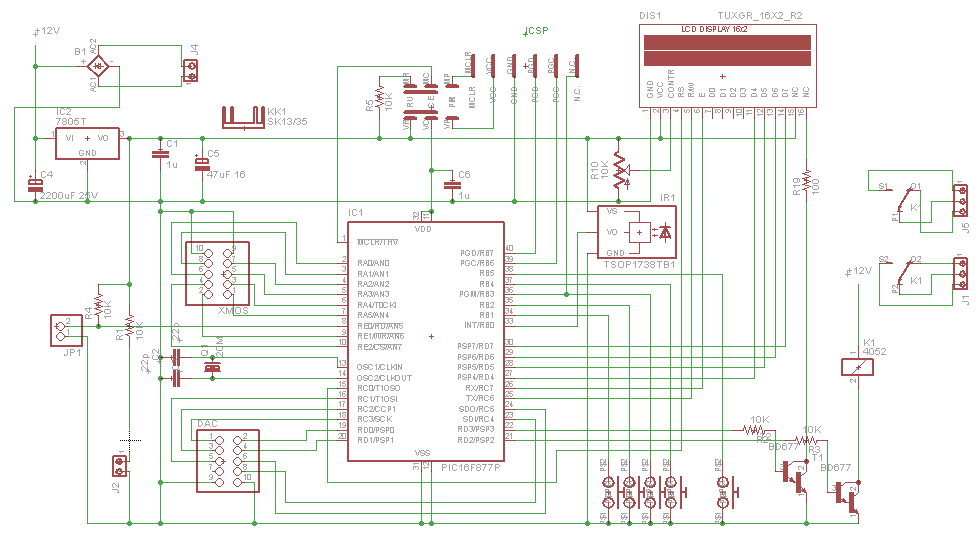

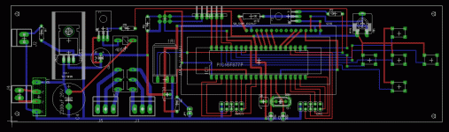

Here the controller to get data from XMOS module and configure any DAC like AD1955, DSD1794, ES9018 ....
IR remote command for the volume and mute.

DSD1794 Digital Attenuation: 0 dB to –120 dB,0.5 dB/Step
AD1955 On-Chip Clickless Volume Control
ES9018 On-Chip Clickless Volume Control
PCM1794 NO
PCM1796 Digital Attenuation: 0 dB to –120 dB,0.5 dB/Step
PCM1792 Digital Attenuation: 0 dB to –120 dB,0.5 dB/Step
