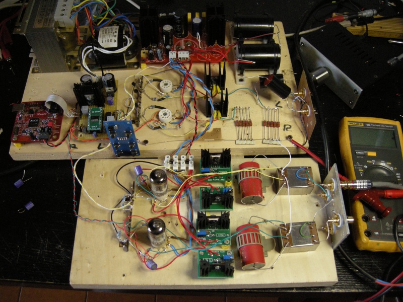

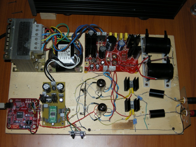

Last environment still to test with my friends
XMOS module + AD1955 with passive I/V (200 ohm Caddock MK132) + 12AU7 differential stage with fet current gen. + IRF720

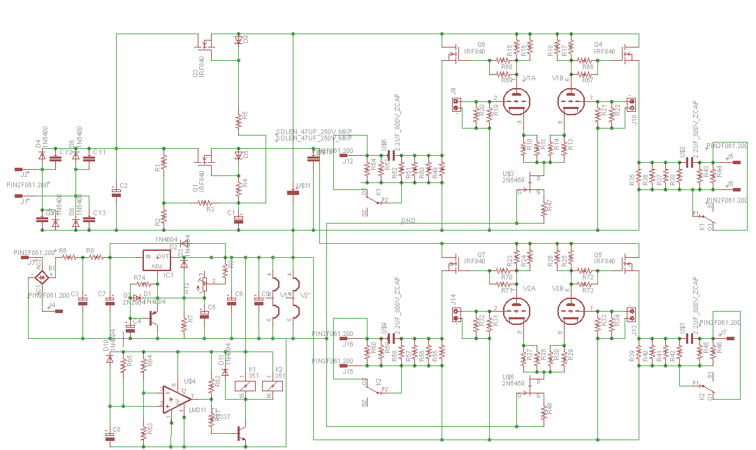

Here the my new environment to test 2 output stages with AD1955 in passive I/V configuration.
1) my hybyid design with differential ECC82 + IRF720 (see schematic)
2) 5687 in Raleigh Audio Line Stage clone (Chapter 4) using K & K Audio (K & K Audio - Lundahl Transformers, audio DIY kits and more) CCS modules.
The second is more expensive but it sound a little better than first.
