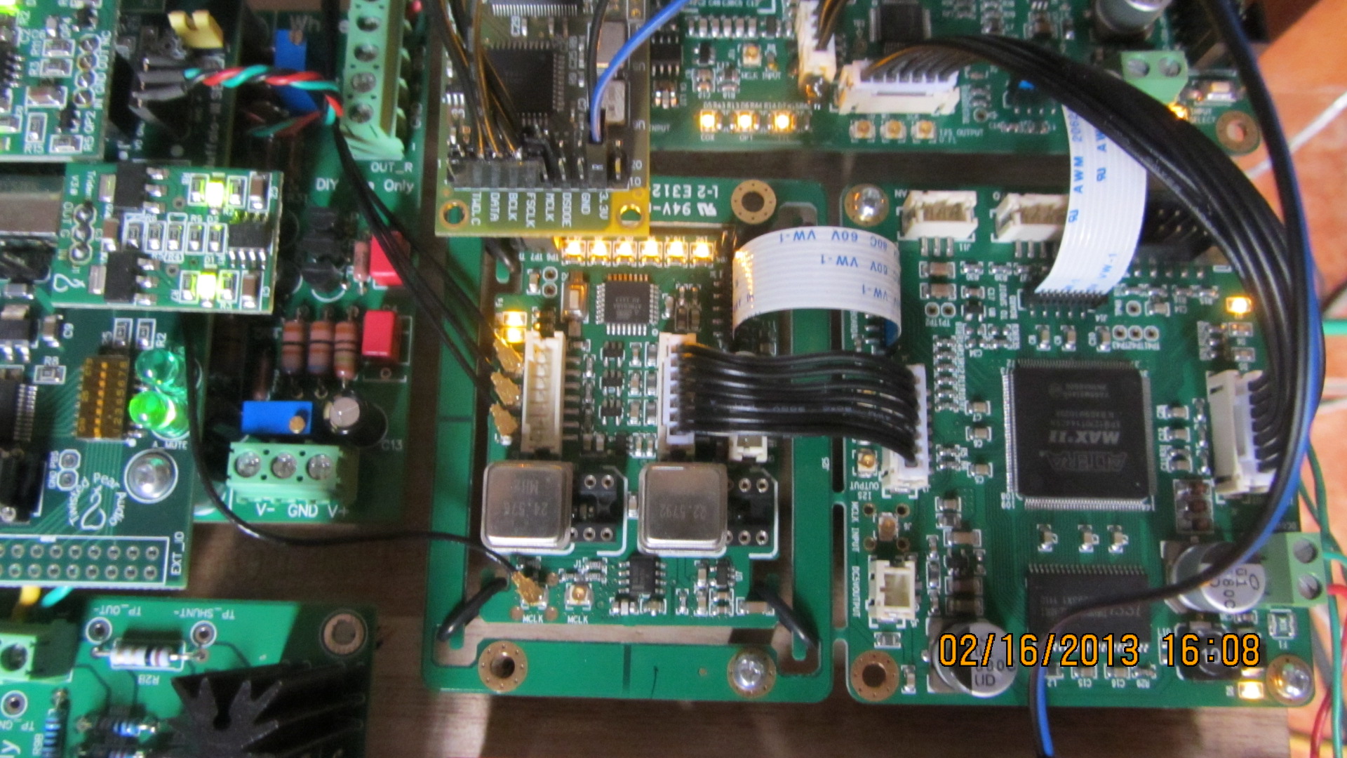

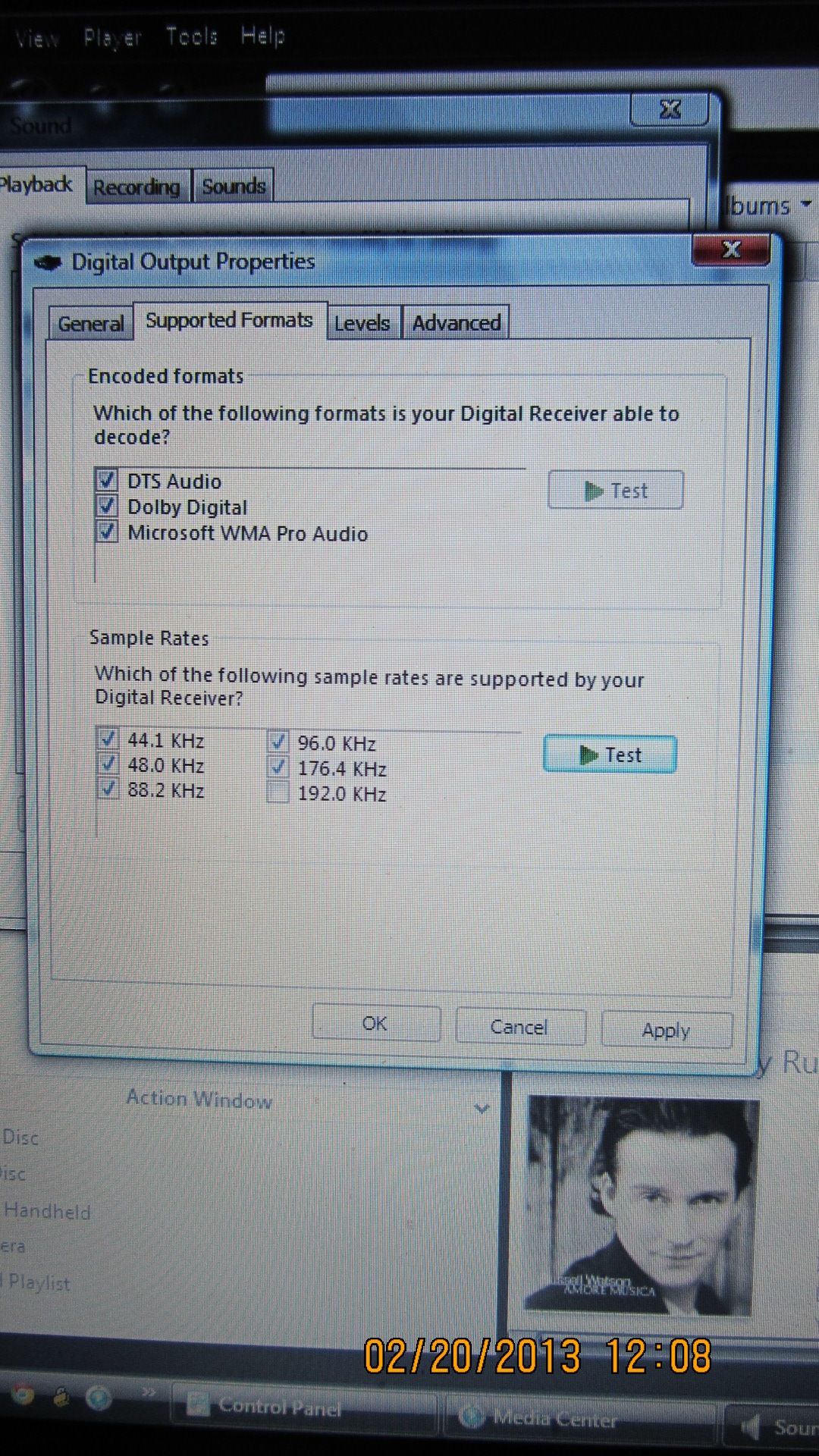

I use Jriver 17 - Amanero with modify 3.3v PSU external - Ian FIFO - Buffalo IIISE.
When playing the files 48Khz and 192Khz, my system is no sound and I see all the LEDs on the Ian Dual Clock board is flashing. I can not determine where errors occur?. Temporary bug fix when I reinstall firmware Amanero or reinstall Jriver, but when playing after a few hours, this error appears again.
I do not know this error is caused by Jriver plugin or Amanero or ...? .
Note: Other sample rates (44.1Khz, 88.2Khz, 96Khz, 176Khz ) is playing good .
Anyone meet this error ?.
Thanks you .

I installed foobar to test the file 48kHz & 192kHz. Fortunately , it solves this problem, my Jriver 17 can play all sample rates formats (not test with DSD).
