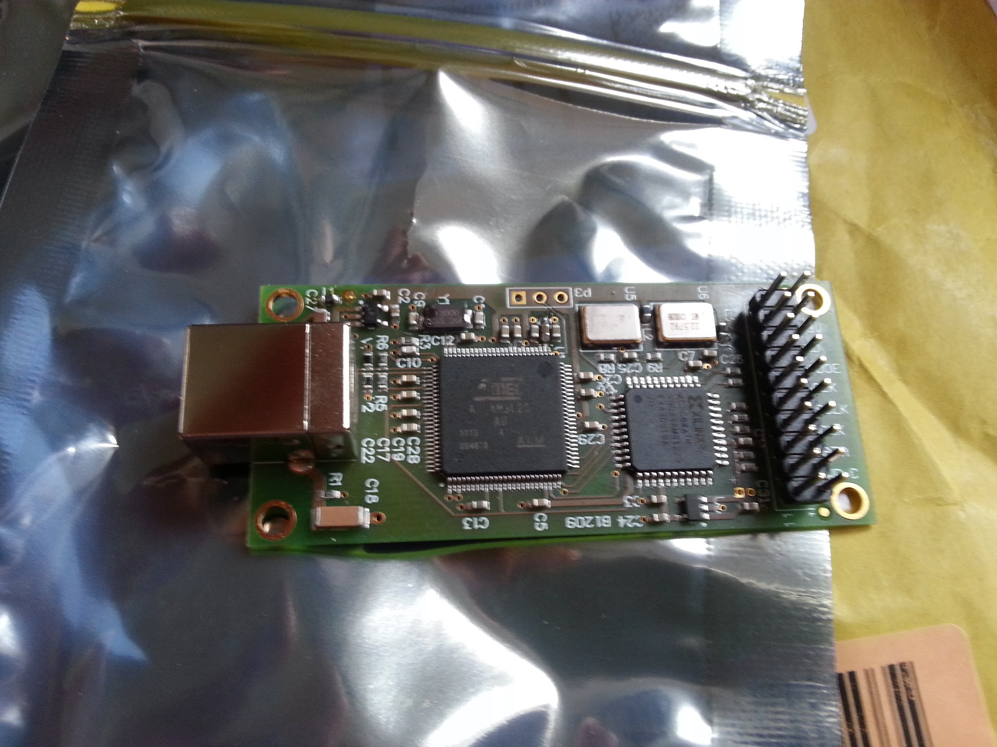

Hi there,
1. I want to report that until now, DSD has worked with JRiver 18 (you have to enable DoP in the settings). I verified the DSD ON pin in the amanero board. Before, Jriver was converting to PCM but it sounded distorted, especially in program peaks or when raising DAC's internals volume. I think it's due to the fact that the DAC wasn't design to work with PCM at such a high sample rate (i am guessing here).
2. Now that DSD is working, I have been able to notice how suceptible is the cable conexion in between the Amanero board and the DAC board. I experiment different kind of hissings or noises that I was able to remove adding more Ground return cables between Amanero and DAC.
Noises are very subtle, and dont act as a Toslink unlock where music just stops for a bit. That makes me wonder , how much can I clean the sound?
I am wondering also how to improve connection even more (Buffalo III and Amanero).

I did a small adapter PCB to conveniently replace the cs8412 in my dac with the amanero for experimental purposes.
The unmounted positions are for a LTC6655.
Thats a very good idea Tazzz!
In my case, Buffalo III and Amanero, I will try do to something similar but with this type of IDE connectors (don't know the name).
My idea is to reduce signal path distance and to have a closer Ground return for every signal.

The Bufalo and Amanero already have those connectores in place.
I also have limited space for the Amanero board in my enclosure.
So the plan is to build an as small as possible PCB for the routing, with two female connectors, so the Amanero will rest just above the Buffalo DAC.
mechanically, it will rest just on the connectors.
I think 40 pins for bufallo and 20 pins for Amanero.

Hi qusp,
Thanks for clarify that.
Yes, Amanero have 2.54mm connectores (the type you use to find in older computers).
Since I have those connectors in both boards, and given thatn i2c connections plus a ground return for each signal is not a 1 to 1 setup using a ribbon cable (sorry the terms, i usualy speak spanish) : I still need a PCB (or something like that to route connections.
Objectives, in my understanding is to get the shortest connections and to have independent GND returns for each signal.
That's why I am thinking a small PBC with two Molex 2.54mm connectors will be the best way to do the job.
I am not mounting the amanero on the Chasis, just will stack this PCB adaptor over Buffalo, and again will stack amanero over the adaptor.
Then distance should be minimal.
Would this be the best implementation? given Amanero an Buffalo already have Molex connectors?
hard to say, it depends on how well you route the traces on the board and how many times you will plug/unplug. probably your way will be fine, especially if you connect directly to the PCB (not with a cable or a socket, have you soldered the BIII sockets yet?) you could just use male pinheaders, which then solder directly into your adapter, but it would be semi-permanent
it depends, will you be using a lot of DSD and high rate PCM material?
Yes, I expect that to be the only imput. I plan to stop using Coax Digital or Optical as I only use Music Servers as a source. This should be enough if I get the desired Sound Quality performance.
